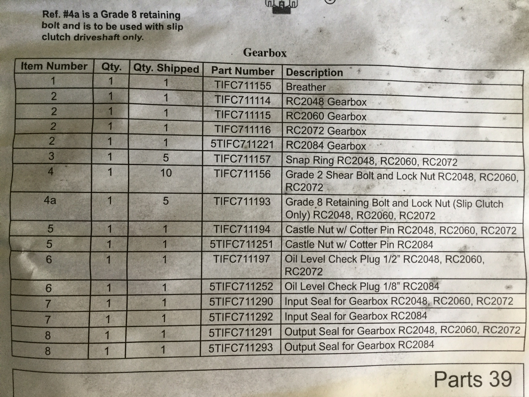

I’m not sure how to replace seal (part #7)
Do I take off cover plate around input shaft (green bolts) ?
Does this plate hold input bearing and seal in place?
Simply a matter of removing plate, seal falls off or out, pop new one in?
My projects are never that simple.
Do I have to drill and pull seal out?

To change the seal, it's pretty straightforward. Remove the 8 bolts that hold the front cover (faceplate) on. Remove the front cover. You may need to use a putty knife, sharp screwdriver, etc. to get it started. The input shaft will stay put, just slide the cover over it. The seal should come out of the back side of the cover. Remove the old seal. Install the new seal. It needs to be pressed in, or use a seal driver of the appropriate size. (a 3/4" drive socket, the same diameter as the seal, will do) AFTER you clean and de-burr the input shaft, re-install the front cover. If you don't remove any burrs or rust from the input shaft, you may damage the new seal. I like to use emery cloth to shine it up. I don't see a gasket or O-ring on the front cover. It will need to be sealed to the gearbox. If there's nothing there when you remove it, I would use Permatex #2. You could use RTV (silicone), but it has to be really clean, and then nothing else will ever seal that joint again. Re-install the driveline and guards. Fill the gearbox with oil.

If you've changed enough seals and aren't confused by the #7 in second pic pointing to the gap behind it vs the seal itself, you oughta see you shouldn't have to remove any bolts to replace the seal.
First pic shows "ready R&R the seal." I haven't slept in a Holiday Inn lately, but I replaced a lot of input & output seals (hundreds) working leak-test/repair in a GM transmission plant in the early '80s. Scoring or porosity in a seal bore can be fixed using any old-school rawhide glue or Permatex #1.
Study your pics well before you take apart stuff you didn't need to. The importance of a 'fix' should never make 'getting it right' more difficult by 'technical intimidation'. This one should take 15 min at most. Starting a seal into bore may be the tricky part if you don't have a 'driver' to hold it on-center or 'the touch' for it. Buff the shaft with steel wool as best you can reach where the seal's lip seats. 'You got this.' ;)

I'm sorry for my ignorance, but what do you mean?
I still have to take off the cover plate (green bolts) to replace seal? That is, do you agree with Bigfoot's assessment that cover comes off then seal comes out backside of cover?
(Note: the 4 silver bolts shown in picture previously held a pto guard/housing in place).
I don't understand the diagram showing "phillips screw heads" (?) where the bearings are, but I don't think this doesn't matter in regards to the seal. Right?
What do you mean by "ready R&R the seal"?
