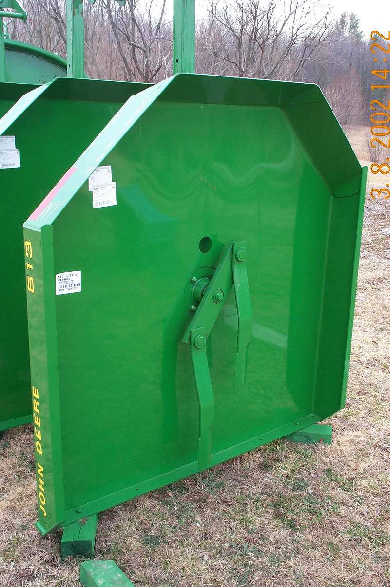

I have a brand new 4ft rotary mower and it has one blade that is free to swivel while the other is not so free to swivel. Are they supposed to be able to swivel or cinched down tight so they don't swivel?

   / Rotary Mower blades #5
If both sides will turn at all (even harder than you think they should)... get into some 1/2"-1" brush and cut for 30-45 seconds... and they should be somewhat free to turn.../w3tcompact/icons/eyes.gif
You certainly don't want any blade to be "bound up" as you can break it and possibly the gearbox... and more importantly being unsafe...
Check with your owners manual and it should explain the torque range of the blade bolts... ~~minimum 300 ft. lbs. depending on blade bolt sizes... (but verify this with your manual)
<A target="_blank" HREF=http://www.tractorbynet.com/forumfiles/49-211770-JD513Cutterw-ostumpjumper-800.jpg>I attached a picture of a 5' cutter without stump jumper to show the "swinging" action needed on all rotary cutters to function properly...</A>
If you notice how the blades are "offset", so when they hit an obstruction, they will swing back and not hit/interfere with each other...
