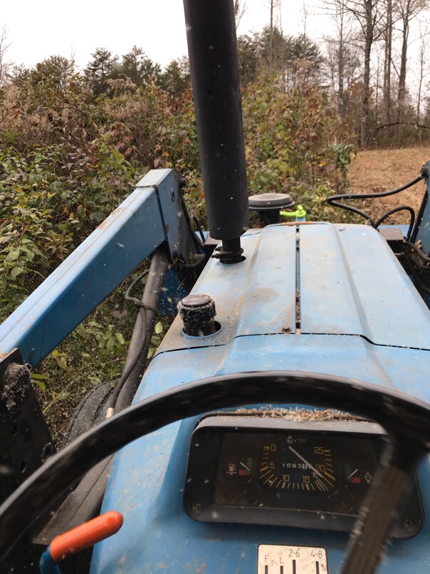

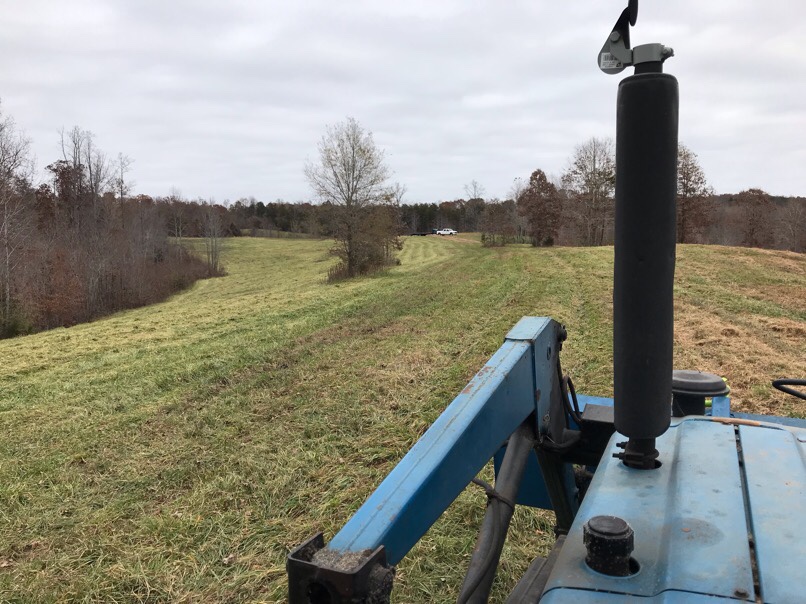

I have a Woods bb72X and have zero complaints about it. It has a sort of domed top but you can see some of the frame and since it sits outside that's good to keep the water off. Most every time I mow the yard I walk by it and blow it off just to keep grass and leaves off of it. It is one of the best cutting bush hogs I have ever used. I have been through briars 8' tall and it looks awesome after you've gone through.

Found a couple pictures of the briars/grass. These briars were 6-8’ tall and very thick. The grass was also very thick. The Woods chewed right thru it.
