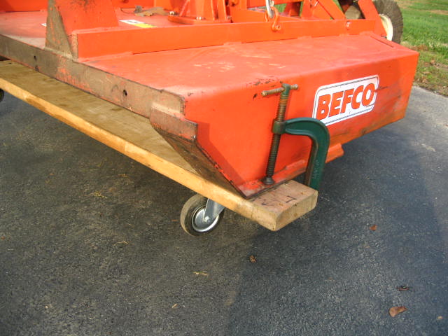

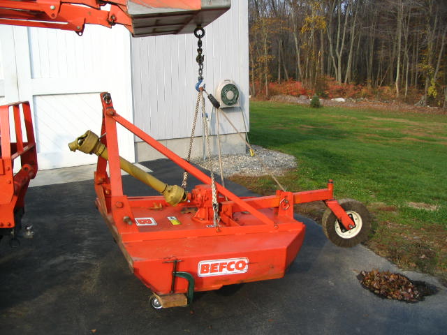

Rotary cutters are hard to move.On a hard surface I use my 2x6 with 4" swivel casters,clamped to the housing,moves like a baby carriage. Airborne moves I use the sling hook method,also works great.

Airborne
   / Rotary Cutter Handling #3
Nice setup. Quick and easy. I need to attach some sling anchors like that.
Cheers!

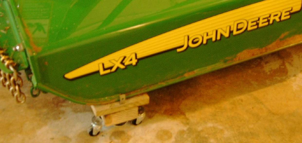

Here's mine.
Ralph
