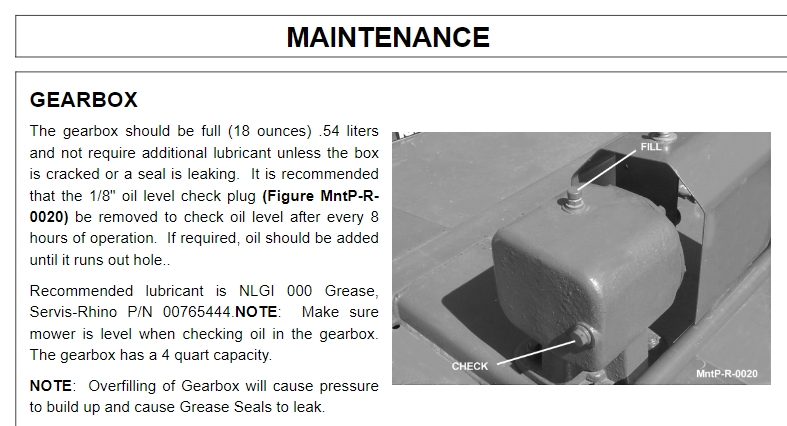

I have a 60" General brand brush cutter that I bought second hand. I can't find an owners manual for it. The oil looks milky from condensation which I understand is common. What lubricant would be best to use. I've read 85-90, 140 or corn grease. Is there a consensus on what would be best? TIA

I have a General also, and if yours is an SE-5 model then it was made by Rhino. Here is the owner's manual for that model, and a screen shot of the recommended lube for the gearbox.
   / Rotary Cutter - Gear Box Lubrication? #10

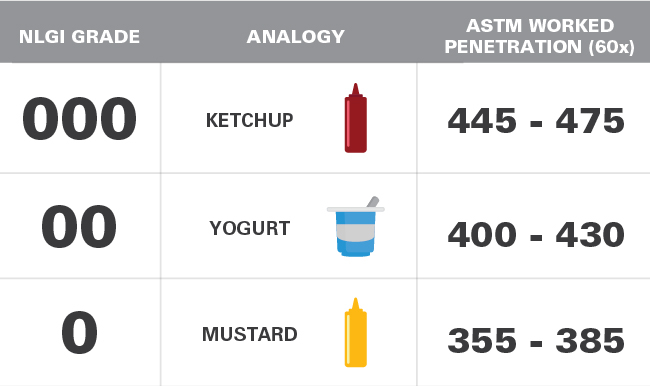

More info about NLGI grease grades: Determine Grease Consistency | Nye Lubricants
NLGI Grades 000-0
Greases that fall under these grades are categorized into the fluid to semi-fluid range and tend to be less viscous than others. These grades of grease can be beneficial in enclosed and centralized applications, where grease migration is not an issue. For example, a gear box requires a grease within this NLGI range to continuously replenish the lubricant into the contact zone.

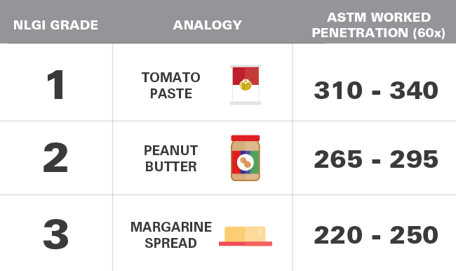

NLGI Grades 1-3
A grease with an NLGI grade of 1 has a consistency like tomato paste, where a grease with an NLGI grade of 3 has a consistency more like butter. The most commonly used greases, such as those used in automotive bearings, would use a lubricant that is NLGI grade 2, which has the stiffness of peanut butter. Grades within this range can operate in a higher temperature range and at higher speeds than NLGI grades 000-0. Greases for bearings are typically NLGI grade 1,2, or 3.
