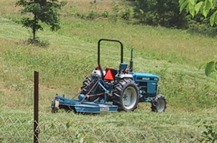

I remove my imatch, then the top link and replace it with a home made floating link made out of a length of flat steel with a bushing/ball socket on one end that is attached to the tractor, and a chain on the other end attached to the rotary cutter. Having to mow over loose sandy soil, the flexible top link keeps the tractor from pushing the deck into the sand when going up over a hump or starting up a hill. Likewise coming down off a hump or starting down a hill the flexible top link becomes tight and lifts the deck up keeping it out of the sand.
   / Rotary Cutter - Center Link Recommended? #7
Based upon a good friend recommendation ran my cutter with top link unhooked. Big Mistake. In backing a slope the mower lifted up enough (no top link to stop it and thus my backing) and jammed the pto shaft and then jammed my tractor pto. Blessed the only damage was the front pto was what suffered and I do not use it.

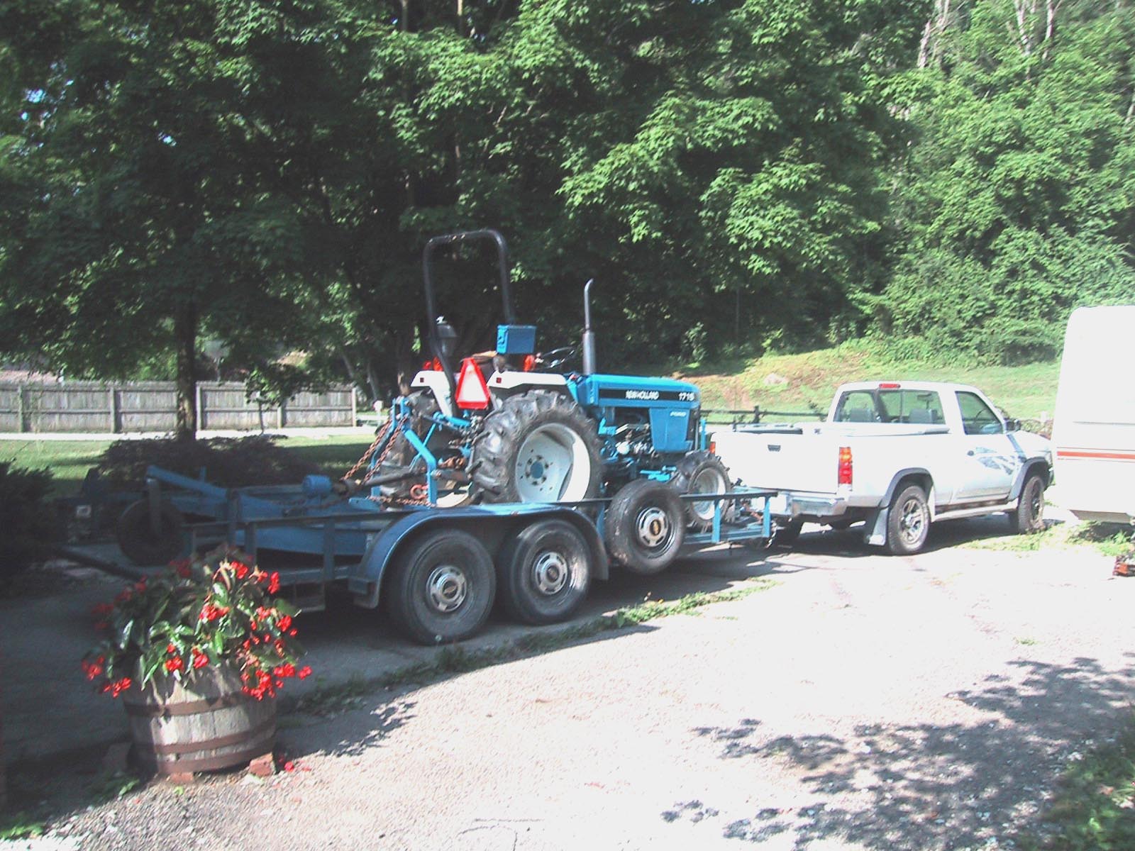

   / Rotary Cutter - Center Link Recommended? #8
I live in WV and I did this to avoid the trouble you had . If you look close you will see chains from top of three point to cutter Made same lenght as the bars that they replaced the only thing you have to watch is that you don't get too much of an angle and bottom out PTO shaft. This works great for me.

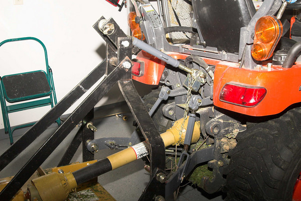

   / Rotary Cutter - Center Link Recommended? #9
That is actually how the bushhog brand RC I have is made.
If you modify one that is not made this way, You'll probabally have to get locknuts for your lift pins and leave them just a little loose so the deck can pivot around them.
Best pic I could dig up.
