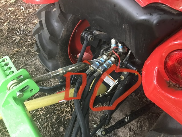

You should be able to adjust the left lift arm by moving the pin to the top hole. Then adjust the right arm to level the mower. That would give you more range of motion for your 3pt lever.
Adjust the rear wheel for the height you want then lower the front till mower is level or slightly lower in the front works best.
This is the best picture I had of the lift arm adjustments. I circled the adjustments in red. Hope this helps.

Best way to visualize what to do is remove or disconnect the top link.
1) Level the cutter side to side with the lift arm that as the adjustment, usually it's the right one as shown above.
2) Using the 3 point lift, raise or lower to set the front blade to the height you want to cut, 3", 4", 5" whatever. If you have a lift stop that can be put in place so that you always go to the same height, put it in place now.
3) Set or adjust the rear wheel so that the back of the blade or cutter is about 3/4"to 1" higher than the front. (This will probably require connecting the top link to get weight off the wheel.)
Now you have set the mower level, pitch front to back and the cutting height.
4) The top link can now be connected and adjusted. Most rotary cutters have some form of flexible connection for the top lift that allows the cutter to follow the contour of the ground.
You want to connect the top link and adjust it so that there is about 2" of slack so that when you raise the 3point lever, the mower will raise the front of the cutter a couple inches before it will start lifting the tail wheel off the ground. This is what allows the cutter to follow the ground contour.
