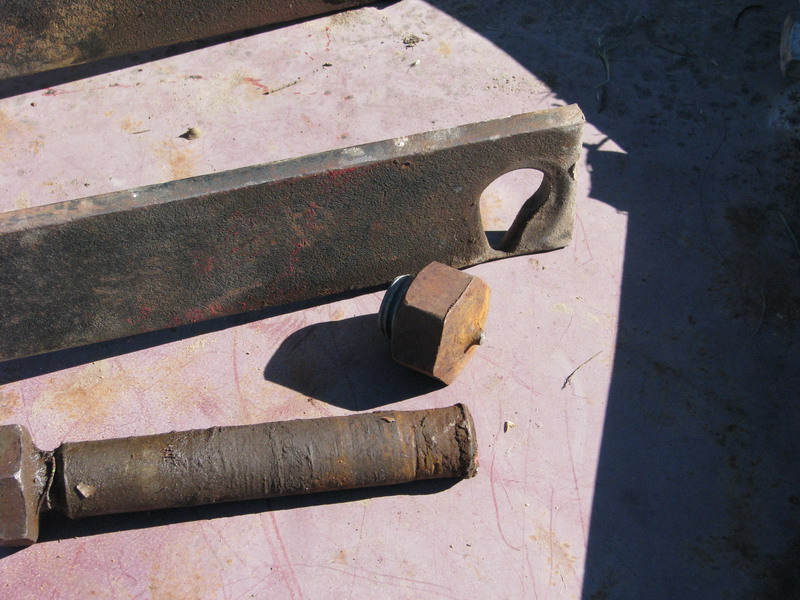

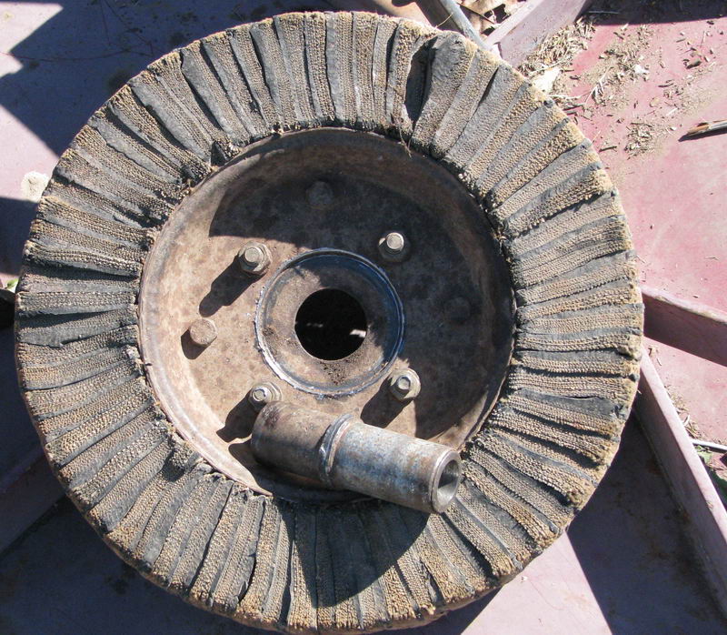

I won't go to counseling, but I'm an admitted abuser of my rotary cutter.:eek::ashamed: Even in the best of situations, using a rotary cutter at my place is gonna be borderline abuse. I have so many rocks, trees/stumps, and uneven ground that things are gonna slam up against unmovable objects on a regular basis. The shear pin hole in my rotary cutter's u-joint hub is football shaped (oval) from the dozens of grade 2 bolts I sacrifice to the rock gods.:rolleyes: That said, I grease the u-joints on a regular basis and always remember to grease the tailwheel's swivel and axle hub. I learned a long time ago that an ungreased tailwheel swivel would lead to the wheel just digging a trench instead of swiveling when changing directions.
While mowing this last weekend, I noticed a trench being dug by my tailwheel and was surprised to see the axle hub had separated from it's mounting flange. The continuous weld around the hub had just failed. I'm sure it's from frequent smacking the wheel against trees or other obstructions. The life of a tailwheel has got to be an ugly story.;) The picture of the busted hub and wheel is below.

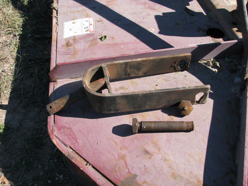

I knew I had a spare wheel on another cutter. There's nothing wrong with the other cutter except it has a frozen axle bolt inside the hub on its tailwheel. I know you are gonna think it was due to my not greasing it, and technically that is correct. I had been adding grease at the zerk, but failed to realize that the axle was frozen inside the hub and turning the entire axle bolt. Of course, it wore out the hole in the fork and rubbing wore the axle bolt down to 1/4" diameter.:confused2: Again, of course it is my fault for not realizing this was happening, but I didn't notice until the damage was done. Since I had two cutters, I set the one with the damaged bolt to the side and used the other cutter. Now that I needed a spare tailwheel, I had to face the job of removing the axle from the hub. Any person with sound reasoning would have been off to Tractor Supply to buy a new axle hub and bolt, but nobody ever accused me of sound reasoning.:D I pulled the tailwheel fork and commenced to beat the old axle bolt out of the hub. It took me almost an hour of applying PB Blaster, grease to the zerk, and smacking the axle bolt with a drift punch and small sledge hammer to get it out. When I did, it looked like the photos below.:eek: Notice the worn fork and how the bolt was holding on with only a 1/4" fragment.

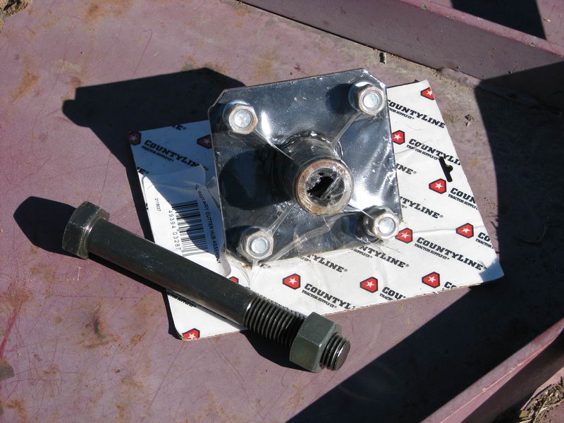

Now that I have my tailwheel fixed, I decide to go to TSC.:laughing: Of course, they have the tailwheel hub for $27 and the 1" dia x 8" axle bolt in their bulk hardware bins. I'm all set to go.:thumbsup:

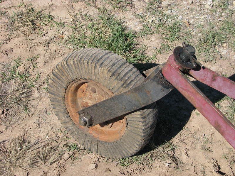

Bob, are you talking about the first tailwheel photo? That's the one with the broken hub. See the bead around the hub? That's supposed to be welded to the center of the tailwheel.
After removing the frozen bolt from the older tailwheel, I put that tailwheel on my mower. That's the one in the last photo. I used the axle bolt from the broken wheel. I could have just taken the hub into a welding shop or done it myself, but for $27, I'm sure I would not find a welding shop that cheap. I have my old buzz-box welder, but I'm NOT a very good welder.
I know this is confusing because of two wheels and assorted parts.

i'd weld it up.
I have repaired far worse tailwheel, even making nw hubs with cut down hard 3pt pins and pipe / bushings, drilled for gease zerks. All I got is a hobart buzzbox welder.
when you are welding on broke parts.. you can't get any worse than broke.. so it';s good practice :)
