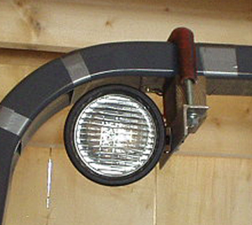

Just wanting to know have you or would you weld brackets for lights on the roll bar? I'm wanting to put a couple lights up there but am not sure what it would do to the metal integrity.
   / ROPS Welding #2
It is recommend that you don't drill, weld or cut a ROPS, but there are some that do what ever they want. It hasn't been very long since there was several pages to a thread over this. This topic is almost as bad as the hydro vs standard transmission topic as far as getting heated. There are lots of ways to make good looking brackets without welding on the ROPS. One member posted pictures of a novel set of brackets that he make a month or so ago. I have attached a copy of it. I'm sorry, but I forgot to put the members name on it. If who ever made it will let me know I will rename it.
If you have a canopy, the lights work better on the front of it.

I wouldn't worry about it if you know what you are doing. I welded tabs on mine and have absolutely no fear of a ROPS failure.
   / ROPS Welding #8
Here's how I did mine.
Some pre-drilled angle iron from Lowes/HD and some square U-Bolts. Lots of mounting places for lots of lights.
No drilling or welding required.

Thanks for all the replies! I have been on the site for a long while just reading and soaking up some graet information. I didn't see the post on welding the rops.... And while I "think" I could do this without any probems. This is one that I'd hate to find out that I couldn't..... The angle and square u bolt idea was the other idea and seeing yours has sold me on the idea! Thanks again. I'll get these mounted and I have few pictures that I need to get on here. Thanks again! Mitch
