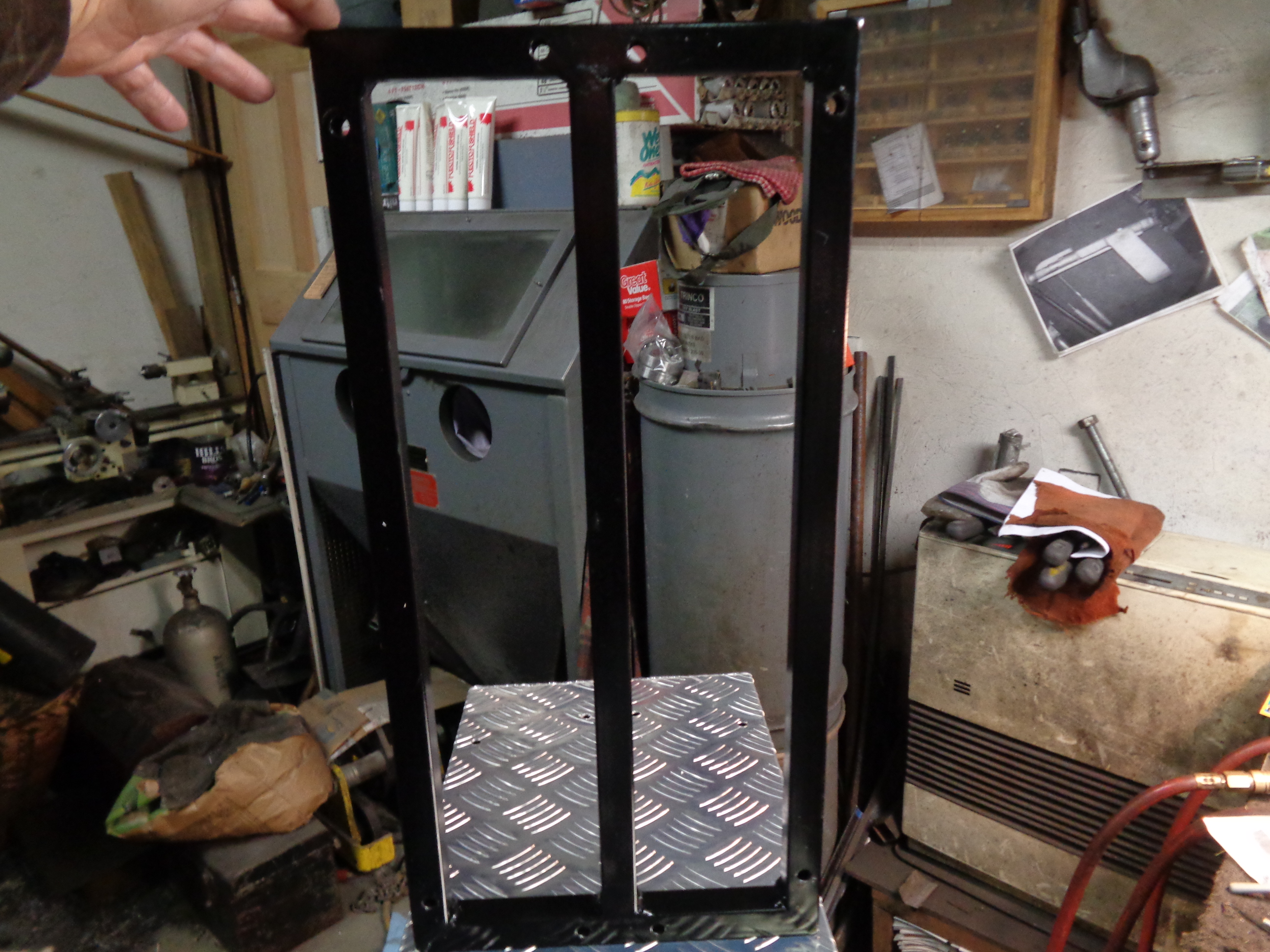

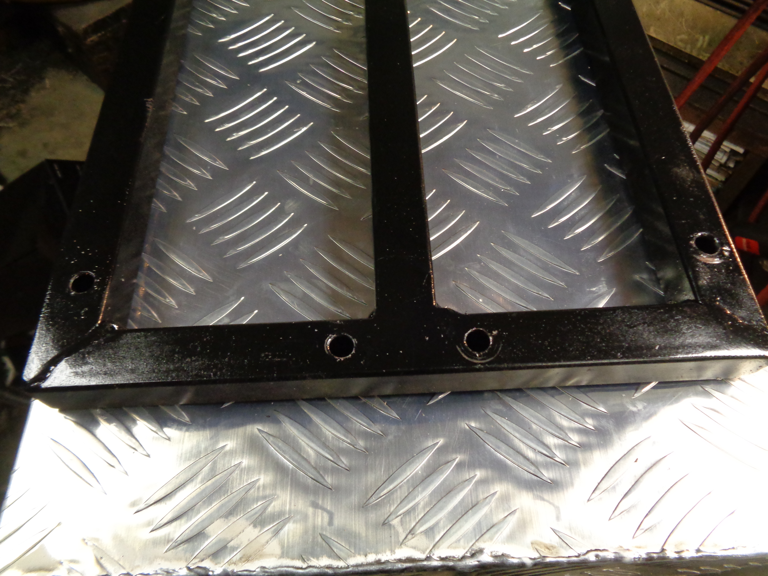

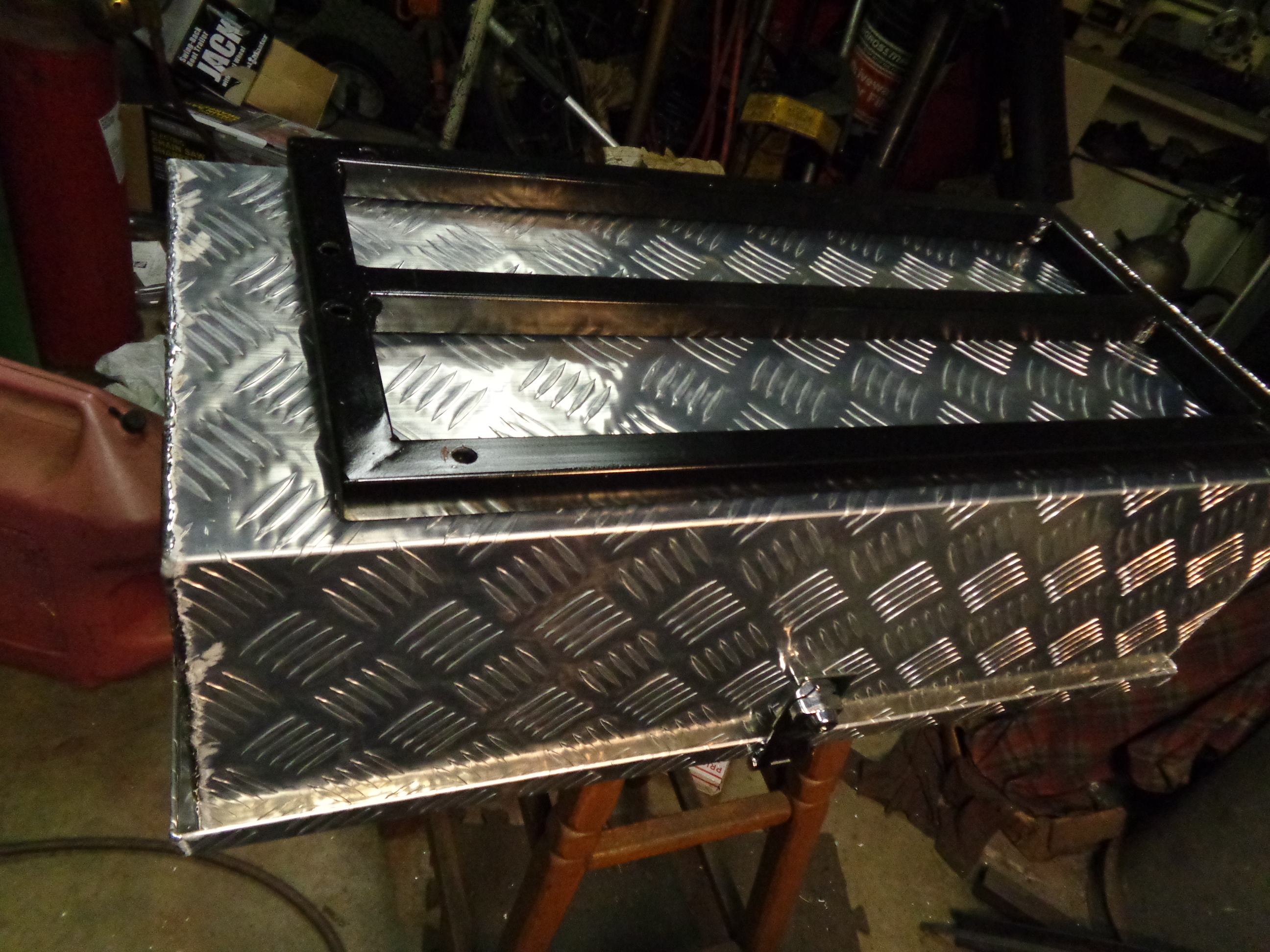

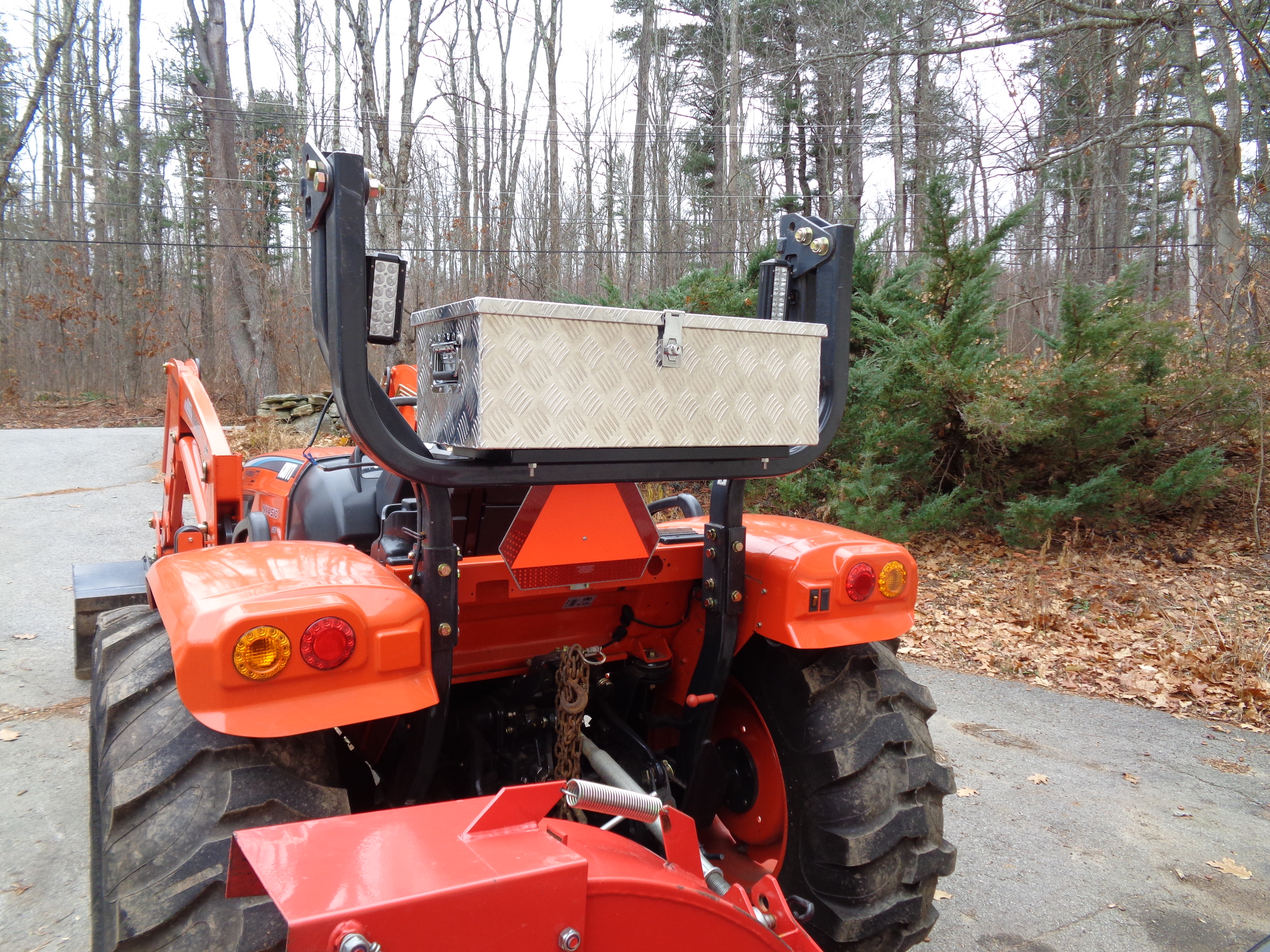

This week i installed a 30" x 12" aluminum locking toolbox on my ROPS. All totaled it cost just about $100.00 for everything. Box was $63.00, 1" square stock (2) 4 footers at Tractor Supply and stainless steel bolts , nuts and washers. were around another $40.00 - 50.00. I welded up a rectangle to mount under the box for support. The box is bolted to the rectangle on the corners. I have four mounting bolts that go thru the box and rectangle into tapped holes in the ROPS. The box can be left in place should I need to put the ROPS back up.

Looks good,thanks for sharing.
/ ROPS Toolbox Install #3
Can't have too much storage. :)
/ ROPS Toolbox Install #4
These two tool boxes all I have, couple wrenches and dont forget the ViceGrips, and Army ammo box work pretty good for tool boxes. The one in the rops just sets in that slot on that bar where the hazard sign thing was, so it can be yanked right out.
