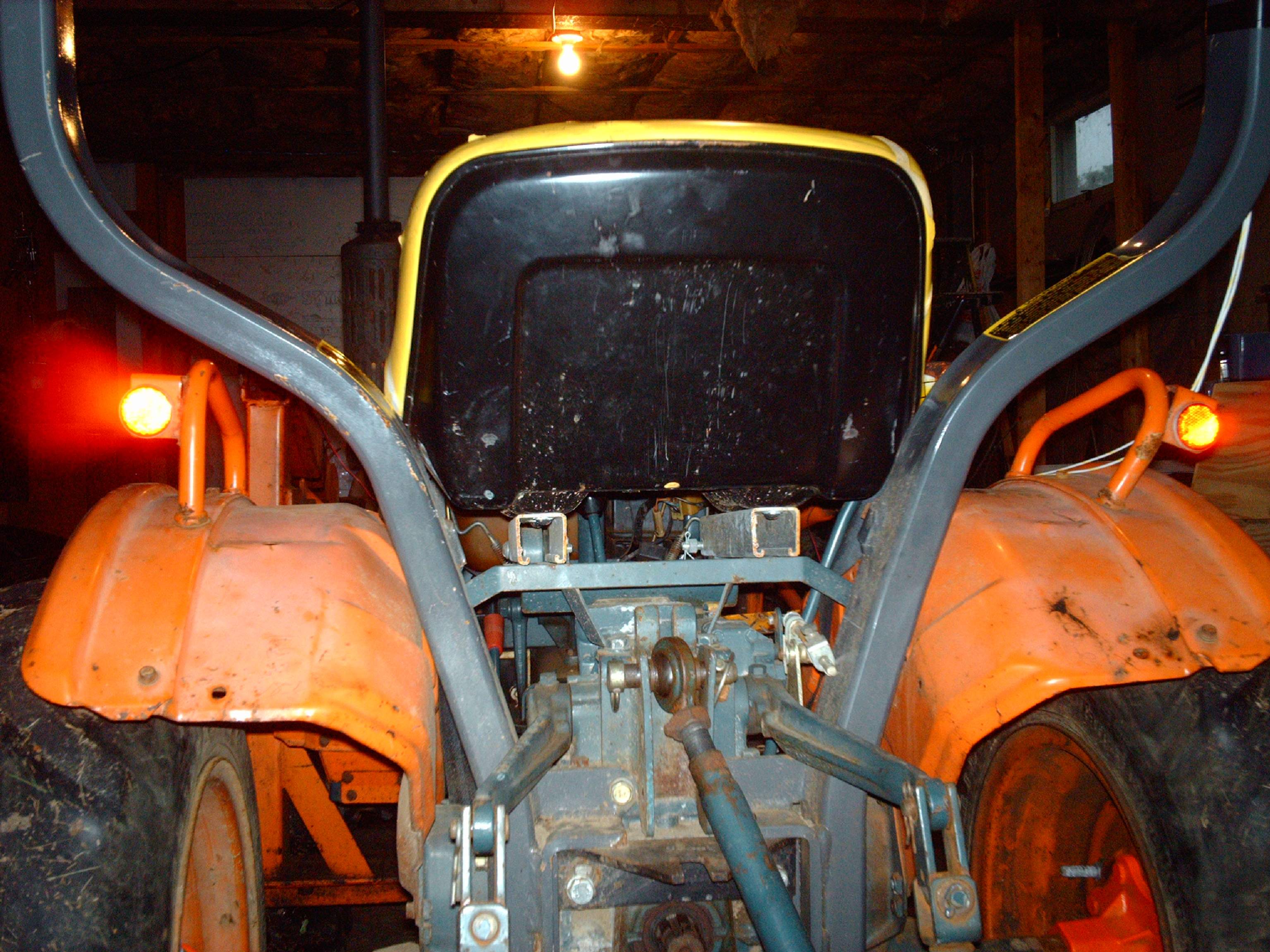

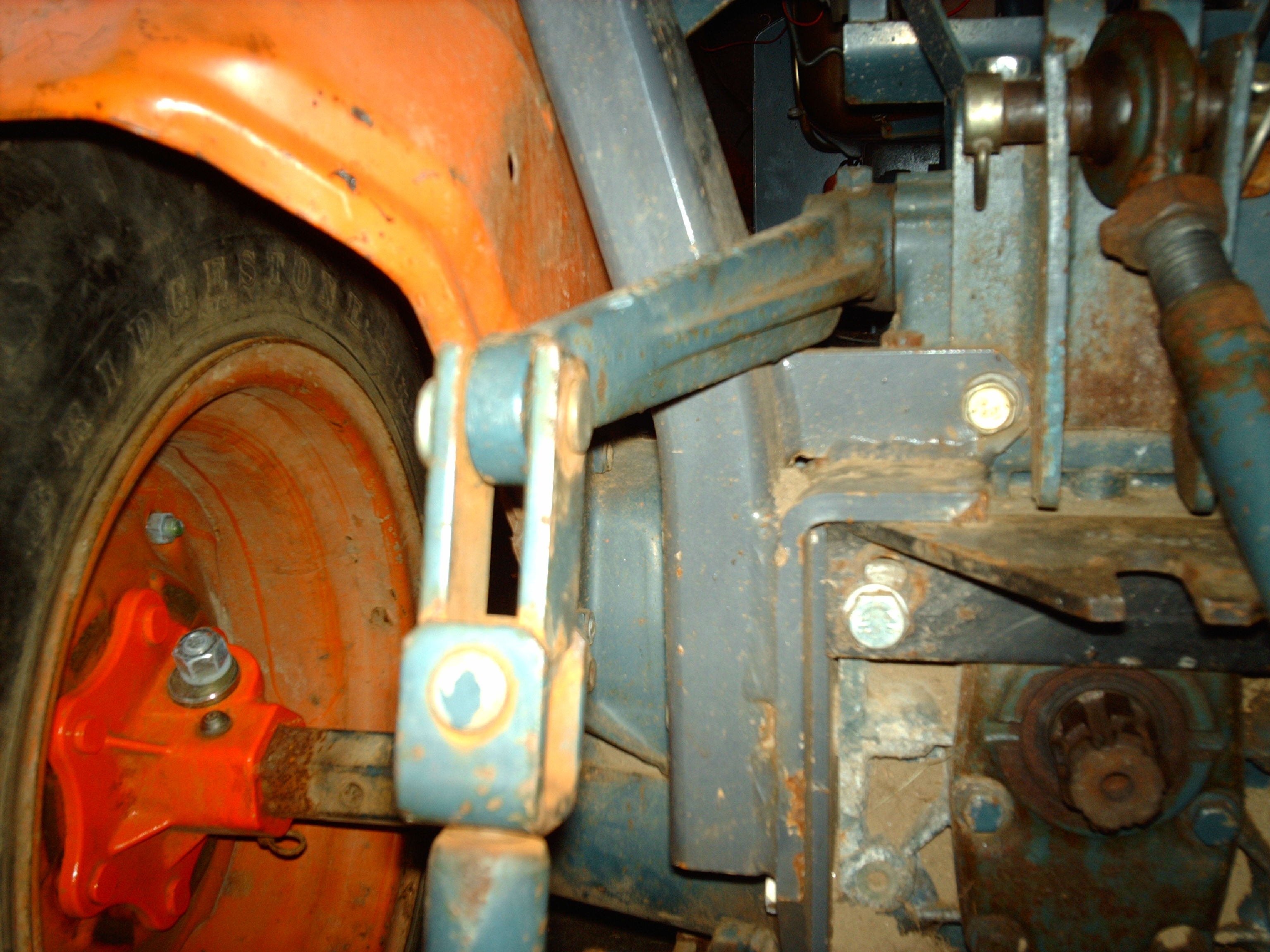

I needed to remove the ROPS from my B7100 while I was fitting the Woods Bh750 backhoe from a Yanmar to my Kubota. If I remember correctly the bar that the lower 3ph arms attach to (you refer to as an axle) also passes through the tractor draw bar (trailer hitch). If your 3ph axle was bent at all it would jam and not come out. If yours has the same setup I would suggest loosening the draw bar from the bottom of the tractor and see if that helps. Again if I remember correctly it had three bolts going up into the bottom of the rear axle assembly.

Hey, can any of you guys take a few pics of how your ROPS mounts? I have a BH on mine and have been told I need to order a special (read: much more expensive) ROPS to fit my tractor. And the dealer can't even show me a picture of what I need or what the standard one looks like!

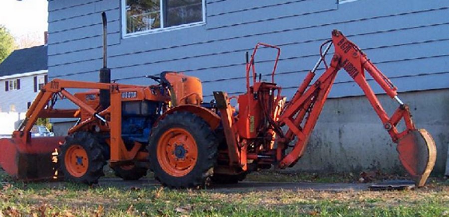

Very hard to get decent photos in the garage and it is raining very hard outside. I hope these help. I was able to use the ROPS that was already on my tractor when I put the backhoe on. Mine is a Woods BH750 with a subframe. What type of backhoe are you using?

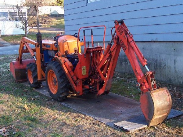

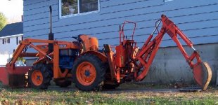

Thanks Sam.
That looks like the one I can't use. It goes right through where my legs and feet would be operating my BH.
I have a Kubota (maybe made by Woods???) B670. It tucks in so tightly to the rear of the tractor that the 3 point hitch has to be removed. To operate it you turn the driver's seat around 180.
