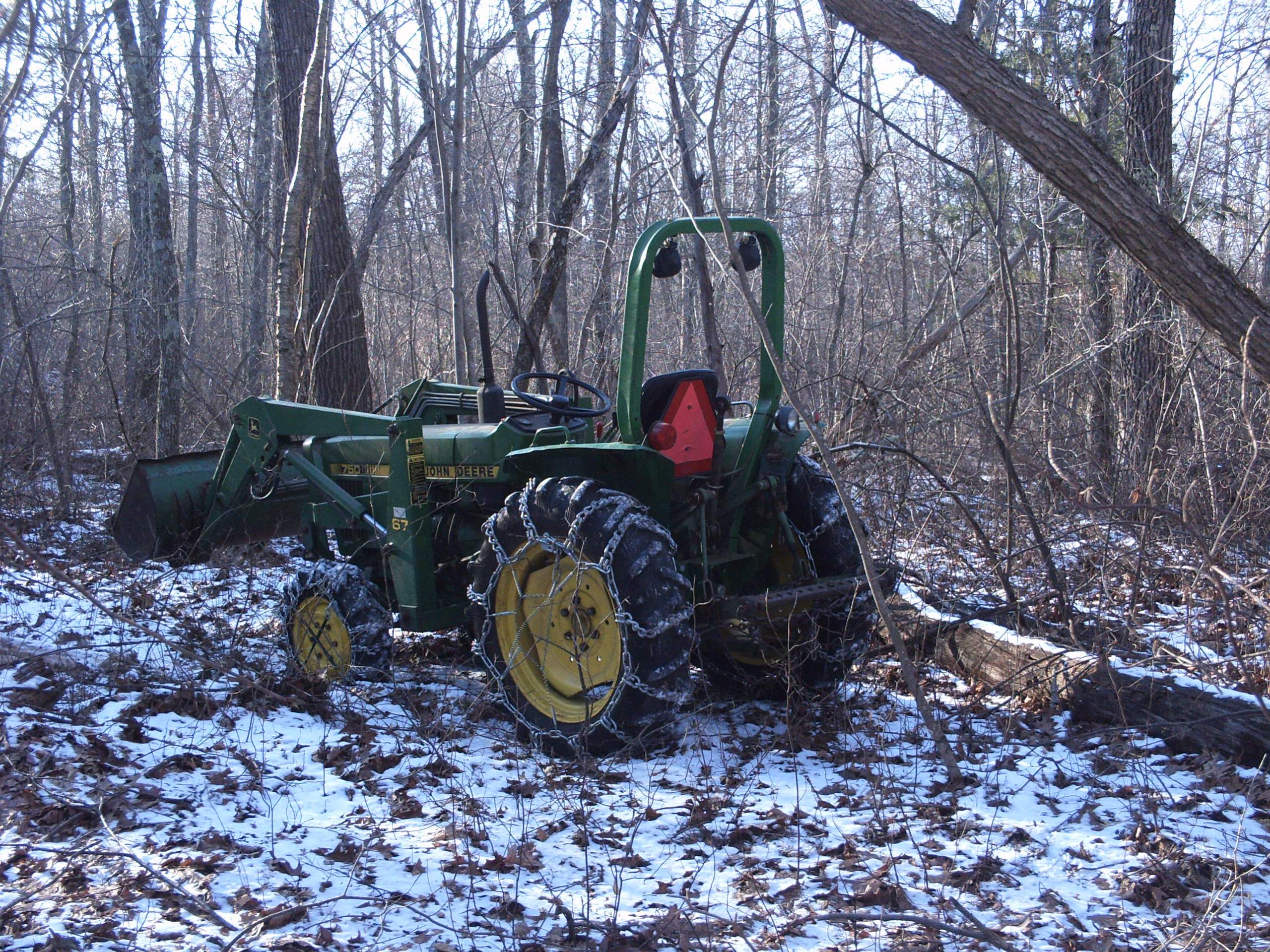

I did do this with my old JD I had. I also live in the woods and quite dense. One thing I did was to mount the lights with a rubber isolation disc about an inch thick. It worked out well.

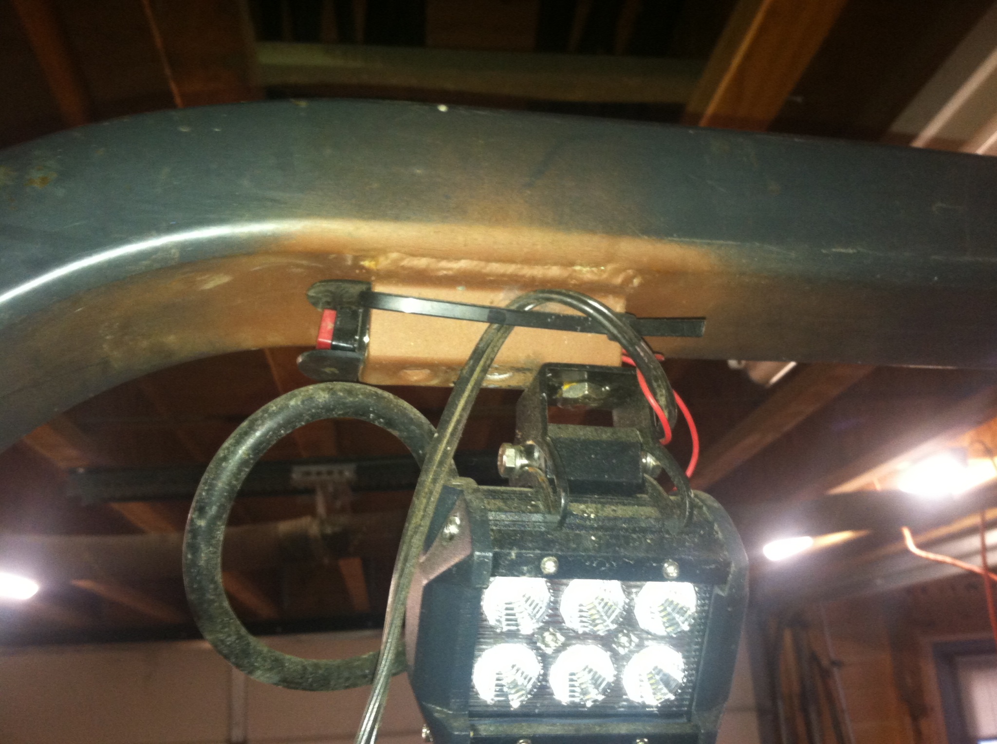

I removed the top part of my ROPS bar and welded on the piece of metal, I then attached the light to it, and used a zip tie to attach the switch. I can turn the light to have it shine forward or backwards. I have a second light mounted to the tractor body beside the tool box tray that is behind the seat, that switch in behind the speed control knob. I didn't want both switches in the same place. The second light illuminates the 3 point hitch from a lower angle that it's not blinding.

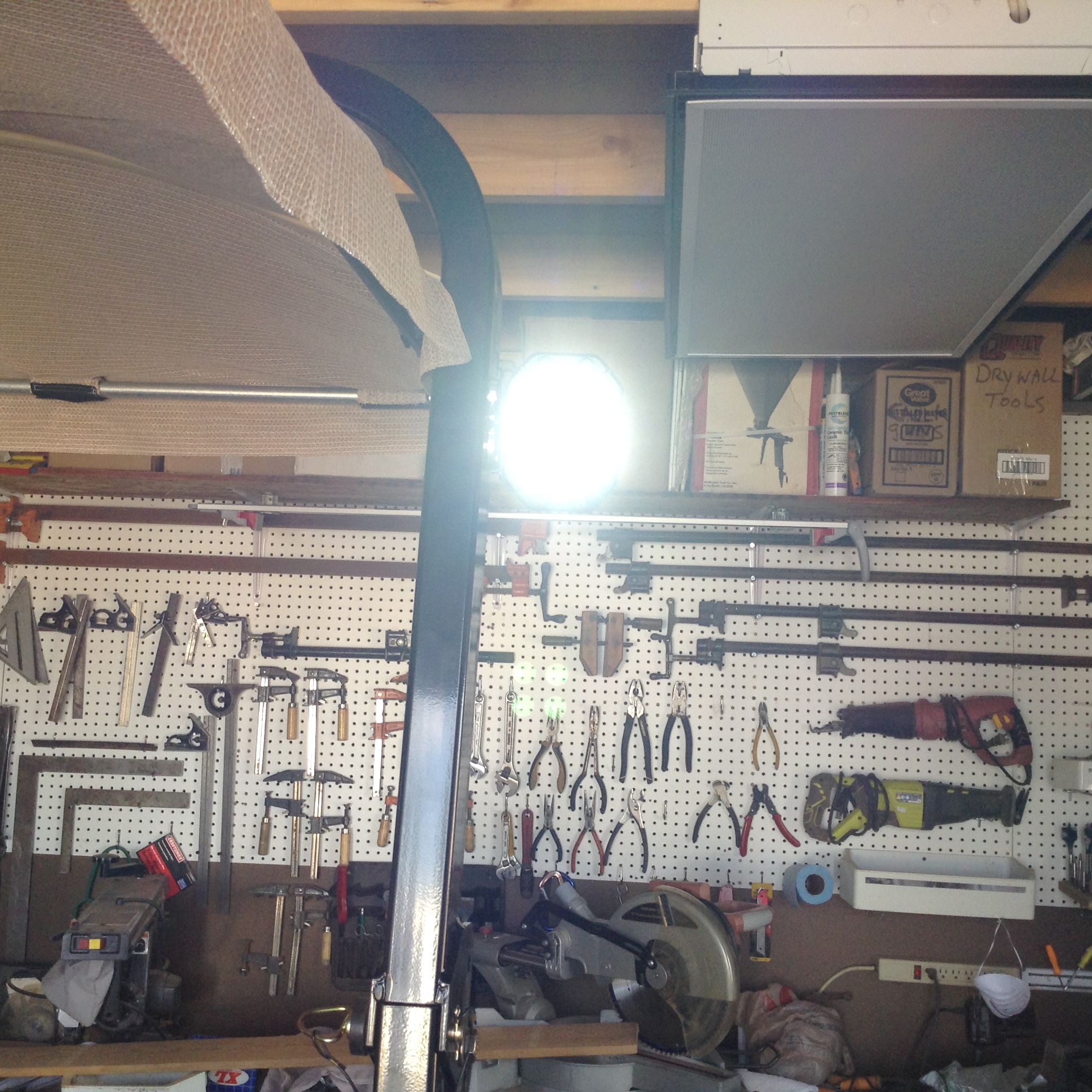

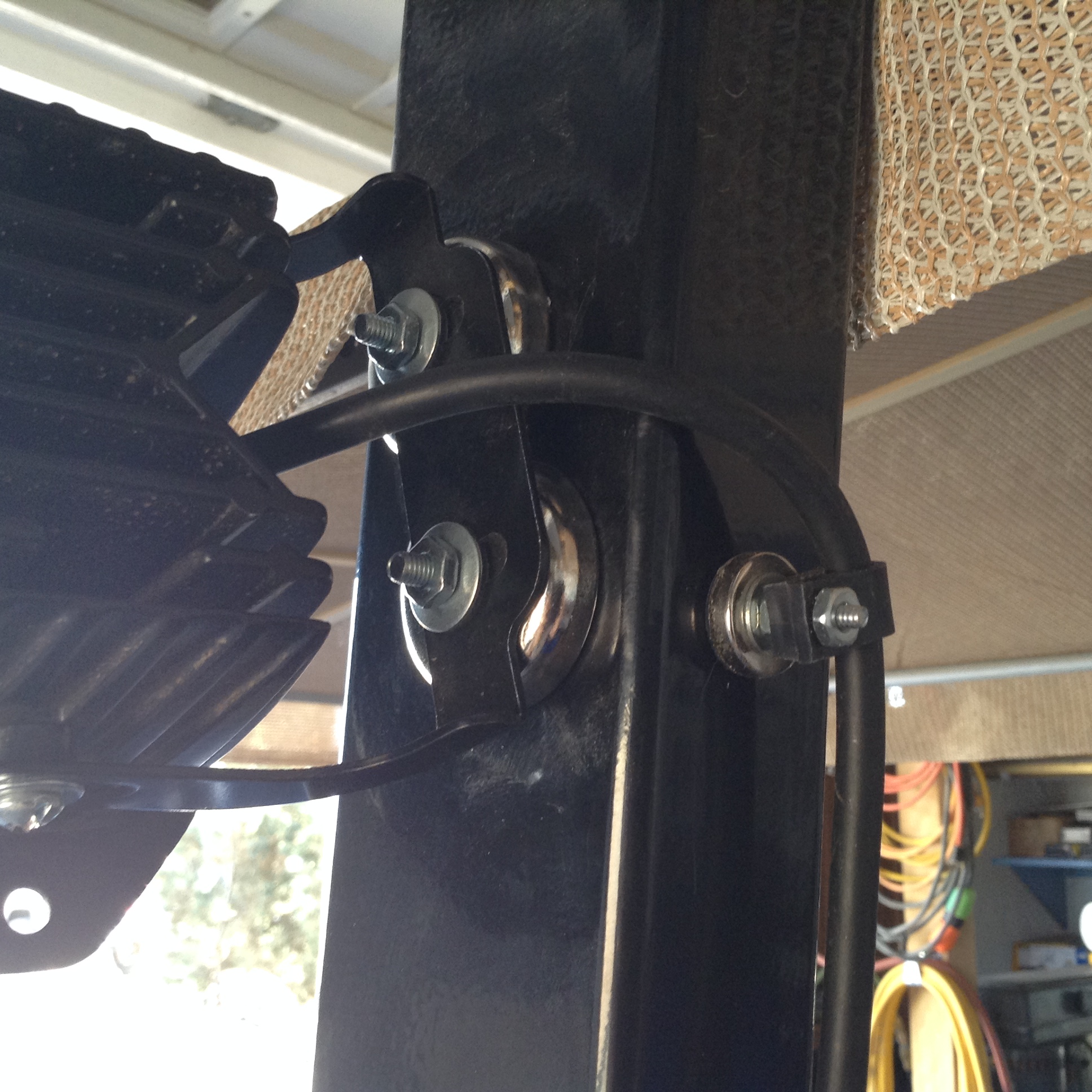

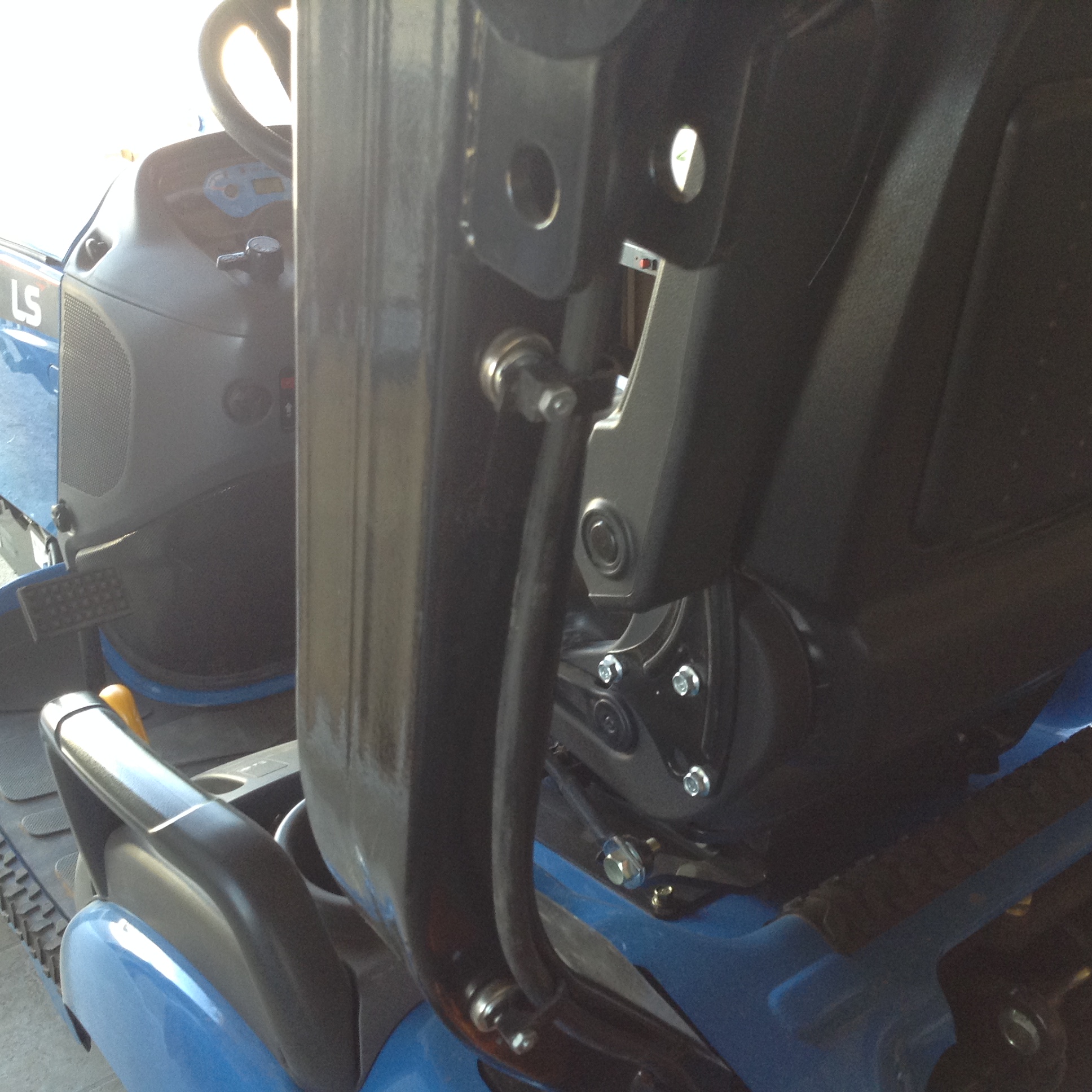

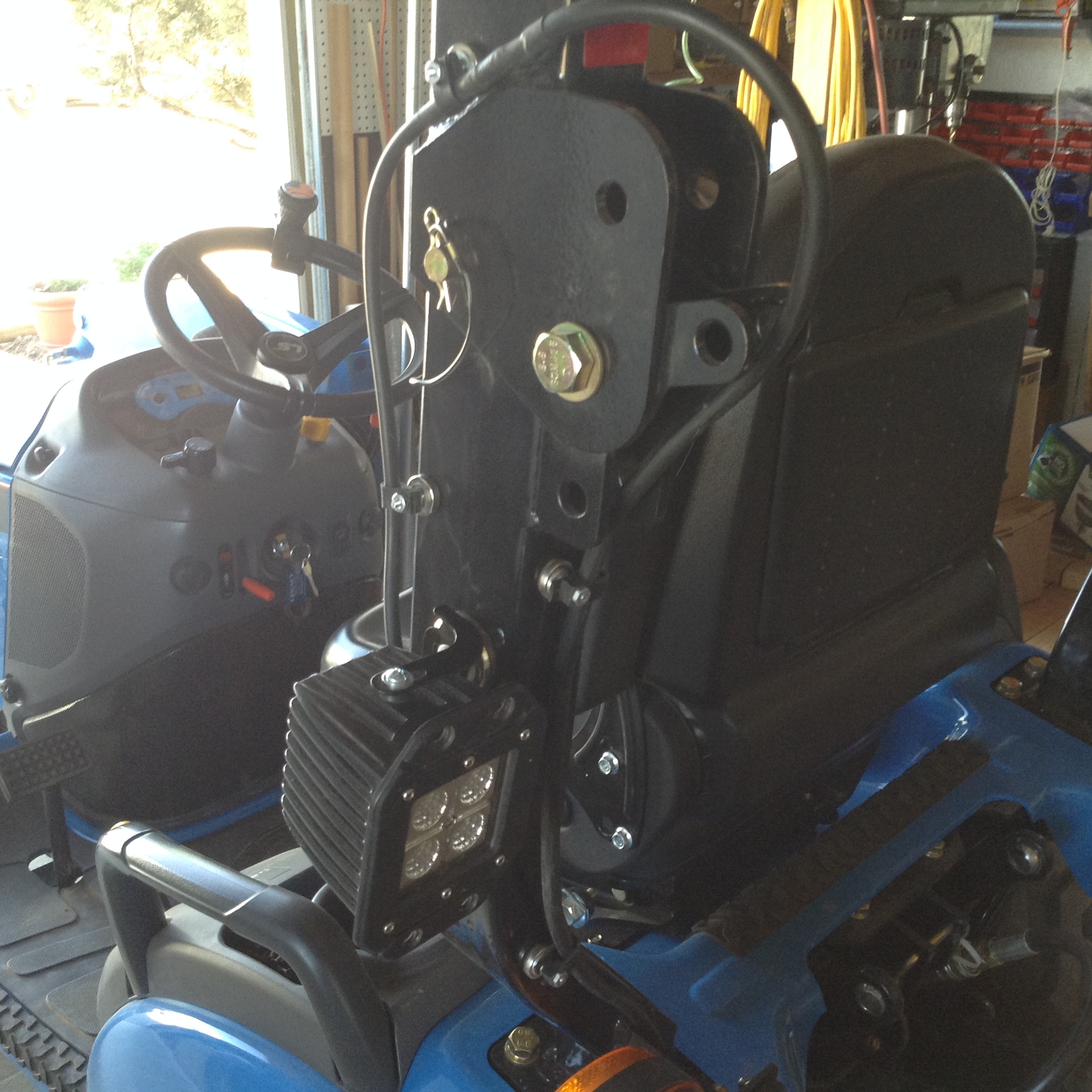

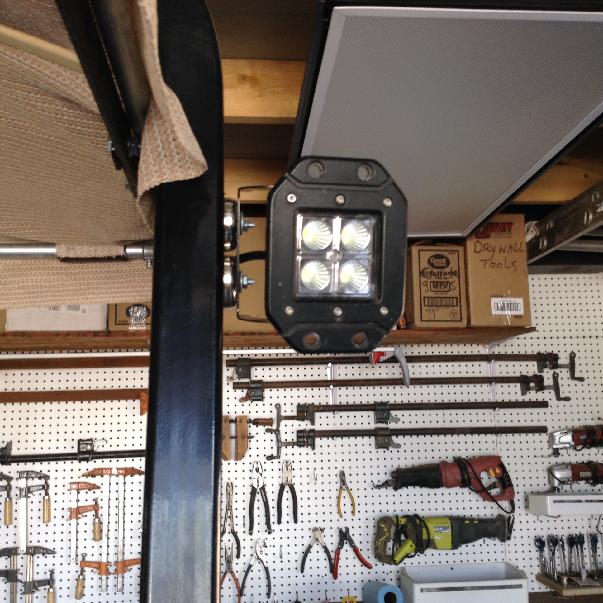

I used 2 30lb magnets on the mounting brackets for my cube lights. I have hit them with branches and they just get knocked loose or moved. I can just move them back to where I want them. This also allows me to position them for the best angle depending on the task. I can turn them easily to face the back or side when needed (backhoe work, mower, etc...). Worked so well, bought smaller magnets and bolted cable clamps to them, which holds the wire. I can remove the wire / magnets and have enough length to put the lights under the tractor if needed to see something under there.
I am impressed. Good idea and good execution.
