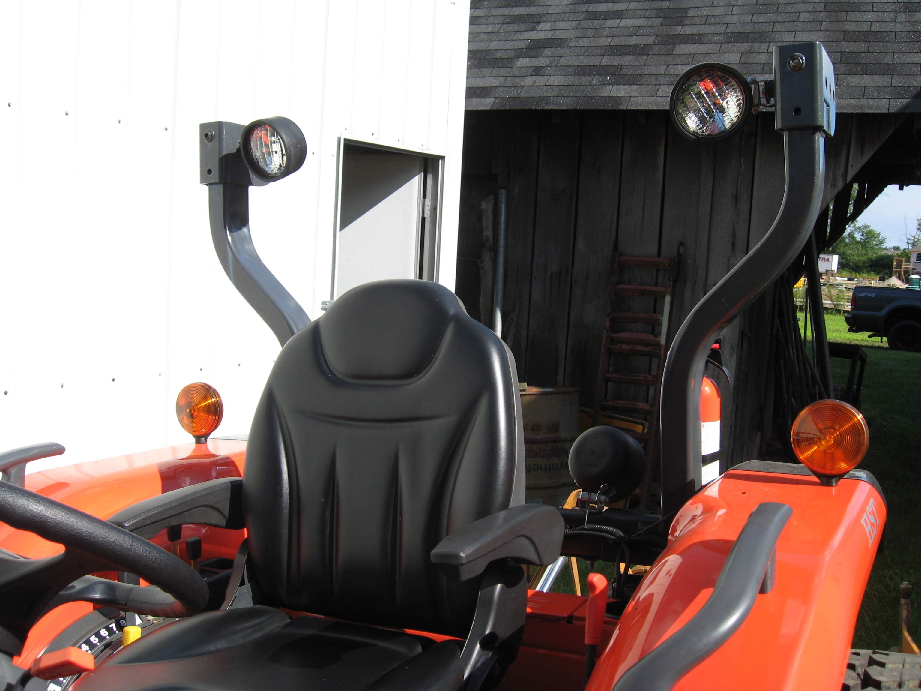

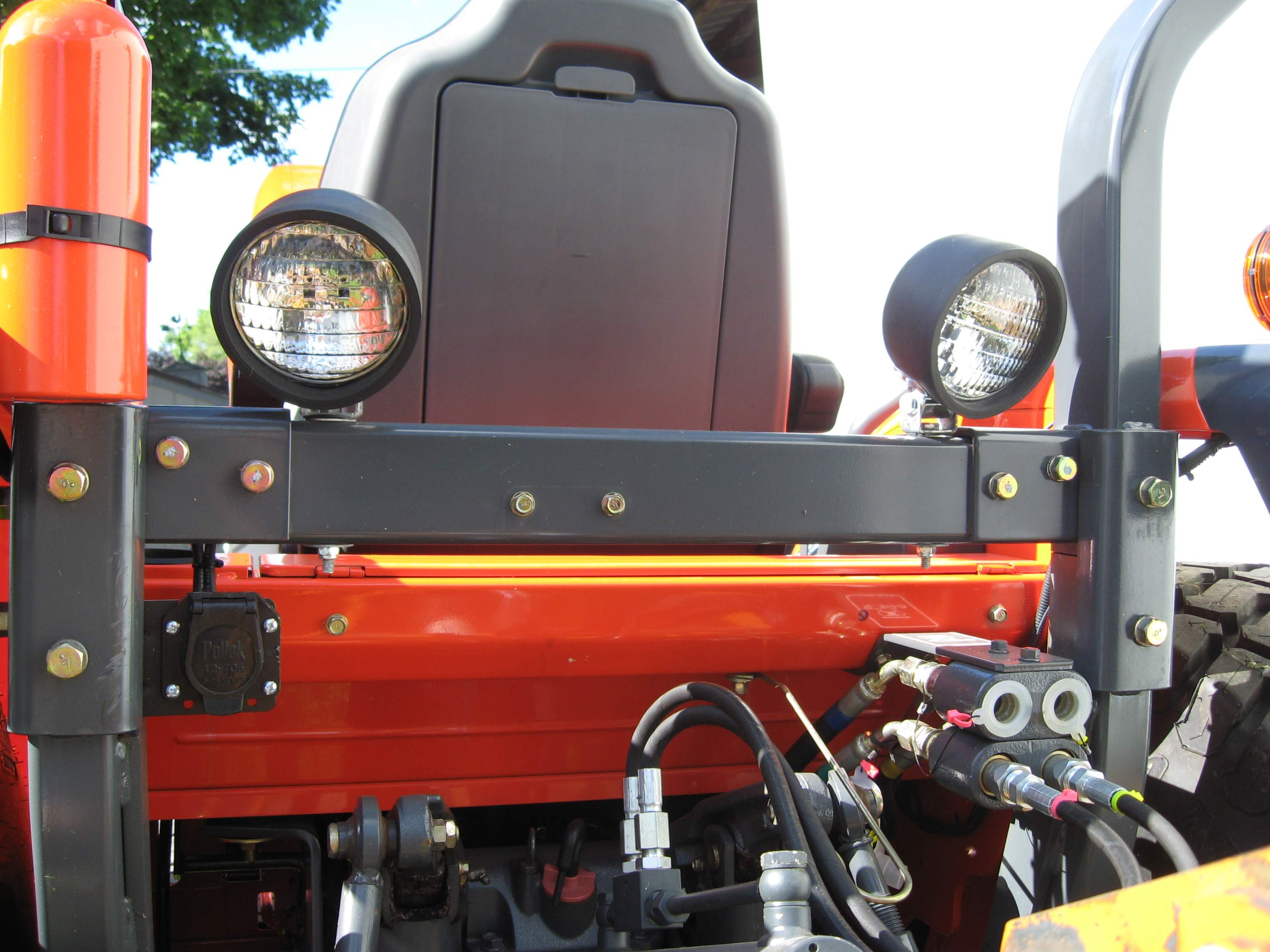

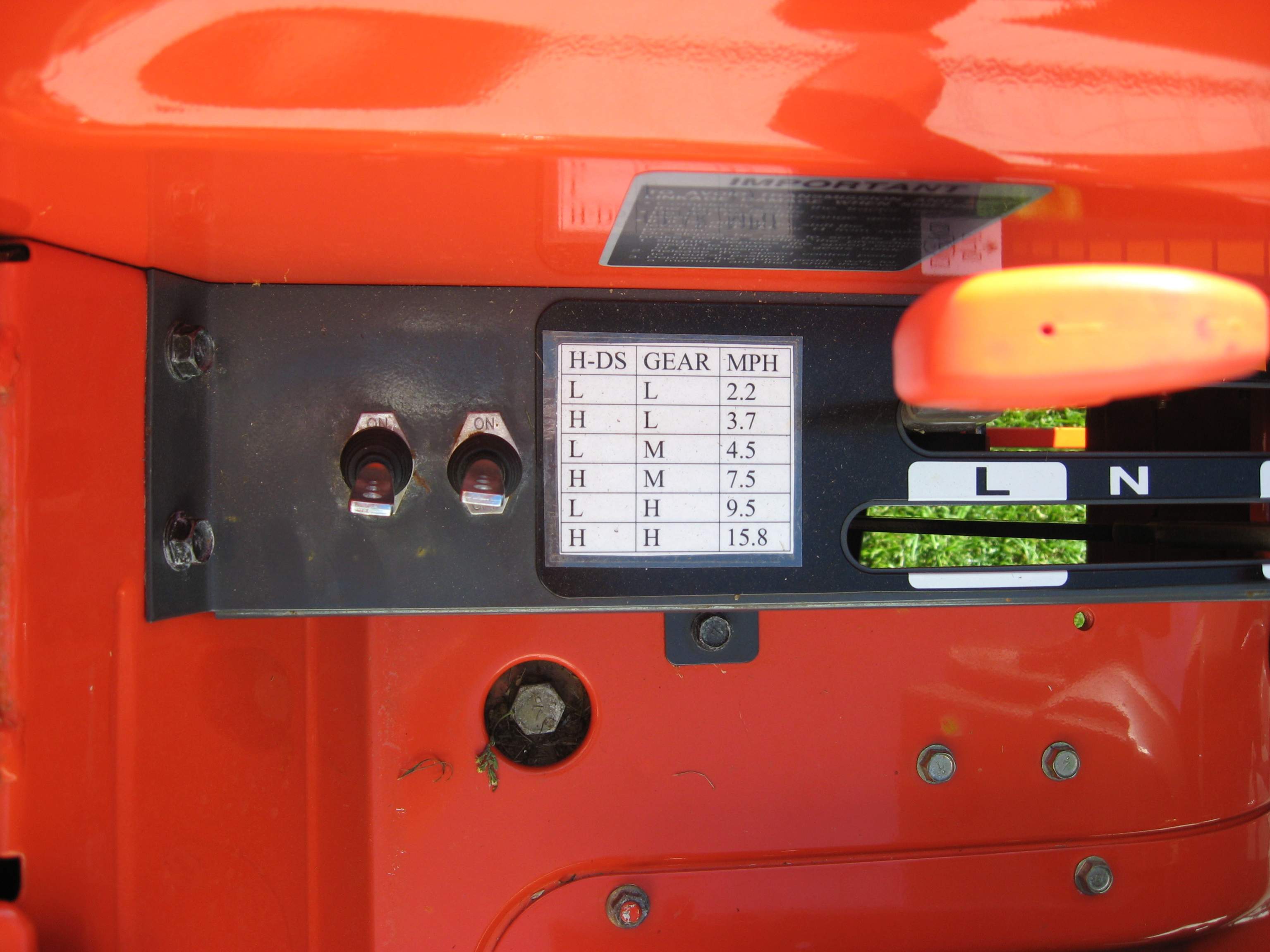

The way I mount the lights may not be for everyone, but it works for me. The switches and wiring turned out nice. Philip.

Looks really nice. Great install
Mike

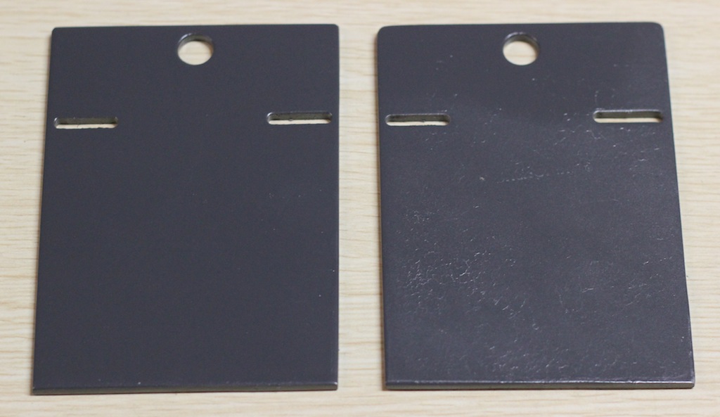

I just finished creating these, partially inspired by the stake bracket design. I decided I could make it even simpler by just using 3" hose clamps.
/ ROPS light bracket ideas #9
Simple is good. How did you cut the slots for the hose clamps?
Mike
/ ROPS light bracket ideas #10
Originally the slots were hand cut with a Dremel tool, which is easy but looks rather hand-made. So I went overkill and chucked them into a little CNC mill and milled them to look nice. Really could have done the entire part in the mill, but it's small and takes forever when working with steel.
Although I've been wondering if steel itself is overkill for these light brackets, and if aluminum would be sufficient.

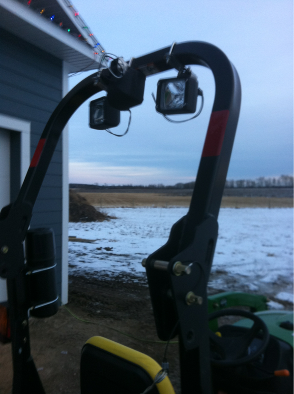

I used a hose clamp to attach my LED work light to my ROP. I rapped a piece of velcro around the roll bar first before putting on the clamp. I used the soft side of the velcro so the clamp had something to get traction on. Also if I hit a low hanging tree the light has a chance to spin instead of getting broken.
