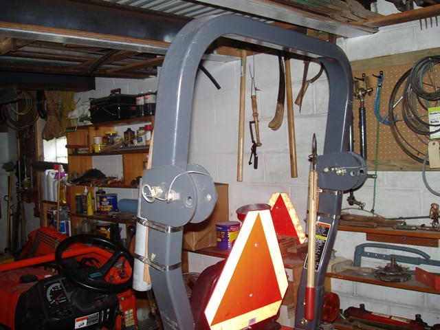

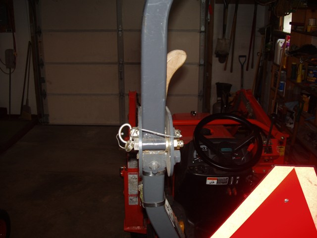

What do you mean by that, Kevin? Did you modify your fixed ROPS?
Don't tell the rops police!!!!!!!!! :D I shortened the top section and then welded all the hardware back on to fresh metal. It is still nearly a foot over my head and I am 6'1" so I feel plenty safe. :cool:

If I ever trade it I will deal with that issue. It would only need the top piece.
My dealer has seen it and did not believe me when I told him it was shortened. It looks factory in all aspects except the welds are a whole lot better!!!!:thumbsup:

Nice job on the shorter ROPS. I really dont think its a big deal to modify this stuff. Its your life.....and if you feel safe with it....go for it.
I feel plenty safe. It is the same height as the fixed ROPS Kubota offers.
The dealer said I could trade it for a fixed even though I got the tractor used but sometimes I need to fold it mowing around the trees.
