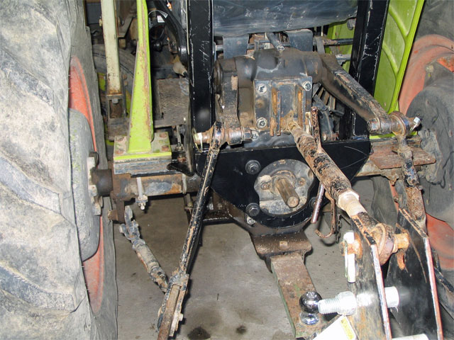

ROPS for YM2000's are now available from several suppliers.
I bought one for my YM240 (US version of YM2000) from Hoye.
The main attachment is into four empty threaded holes surrounding the pto. There are also tabs that bear down on top of the axles.
Attachment: View from the rear.

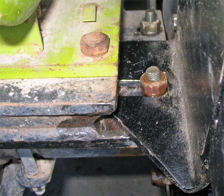

Attachment 2: The fit was near perfect. I had to take a small notch out of the fender-spacers to slide the ROPS forward into position.

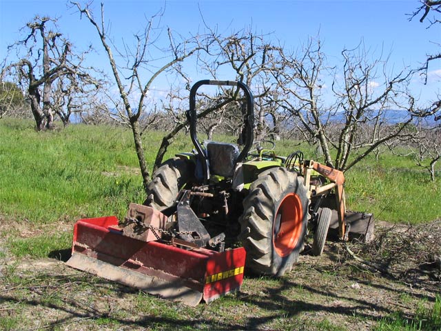

Attachment: The finished project.
Everything around here is on a slope. I feel more comfortable operating the tractor now.

Another ROPS photo, front view.
Aint she purty? /forums/images/graemlins/smile.gif
Never 'reconditioned', doesn't need it, just aging gracefully like me!
(But I wish the first owner had stored her indoors!)
