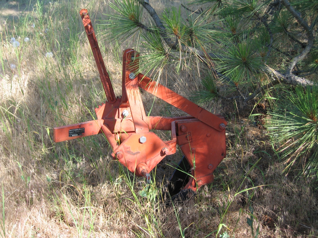

I have a single bottom moldboard plow. It's very HD - Pittsburg Mfg. It can be "taken down" and become a single shank ripper. Even attached to my M6040 I must be careful. Hook on to a root from one of my ancient Ponderosa pines and everything can be brought to a rapid stop.
