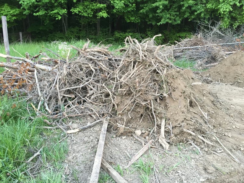

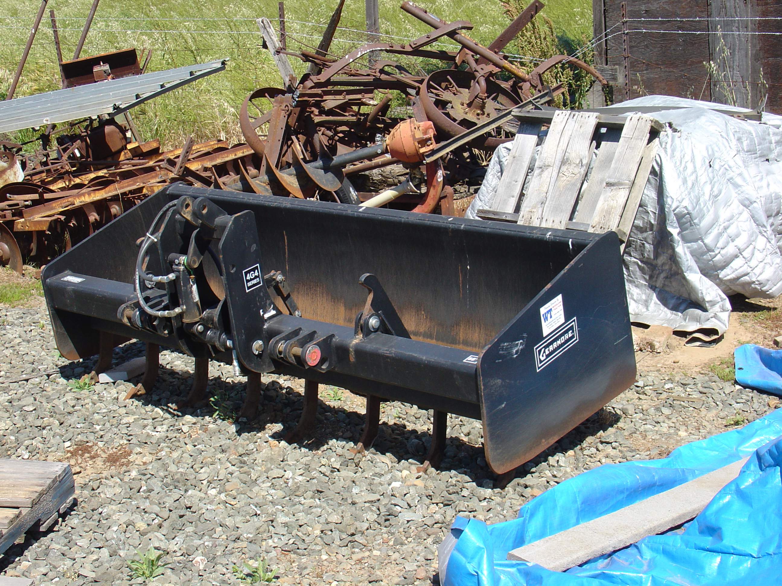

Neighbor asked me if I would consider removing tree roots from his yard left after he had several hard wood stumps removed. I have a 4WD, 4K LBS, 40 HP tractor with a MD 6' box-blade, is it up to the task? The ground is fairly soft and the largest roots are about 2 - 3" diameter.
I know "try it" is the obvious answer but my tractor is about 50 miles from his yard and I would like some idea before I haul it.

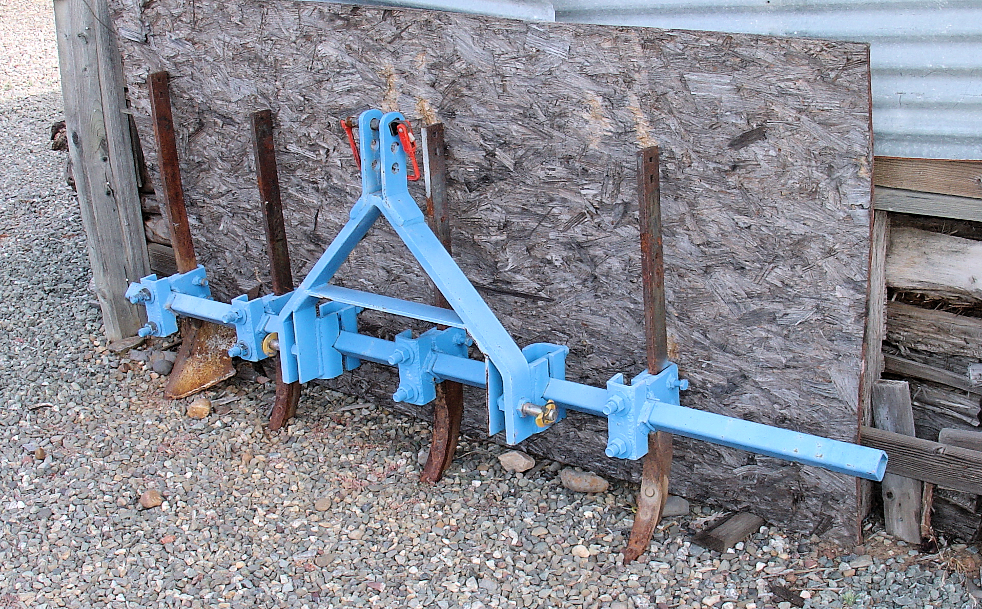

Park on a flat surface with scarifiers fully down, top link shortened, and resting on the scarifiers. Then measure how far the main cutting edge is above the surface. The scarifiers will go a little less deep than that measurement.
Bruce

If you get the roots out it will be a bear of a job on the equipment and there will be lots of irregular divots near impossible to get out without a bulldozer. You'll never get them all out. Then next year the ground will need to be worked all over again to get it smooth. Hardwood roots give up very little and very slowly. Plus it will take forever.

Don't bother trying it, I have on my 3320 and once the ripper grabs a big root all that happens is 4 wheels spinning, power isn't the issue. A backhoe or dozer is the answer. I was able to dig out 2-3" roots with my 447 backhoe on the 3320 but even that was a slow go and took several days.

I helped take out a large eucalyptus orchard for a neighbor. I wouldn't even think about using scarifiers on my 3PH for taking out the roots (and stumps) and I have a fairly heavy-duty BB. Using it would lead to tractor damage, BB damage, or both.
Here is another option that I also wouldn't use with my M7040
As the others have said, a small backhoe or excavator is the ideal solution. It will make a total mess of the lawn but the roots will be able to be effectively removed. It might take a couple of hours.
The best bet is to rent a small excavator from a local rental center.

+1 to all previous posts. My tractor weighs ~ 7k pounds, depending, with filled rear tires and a 2"+ root will stop it dead in its tracks using my 720# ROBB with its shanks down. Maybe if I were only using one shank- maybe I could break a 2" root... maybe... But it would not be removing anything. I have also used a heavy subsoiler to better effect but it still does not remove anything- only break through it. I would not waste my time nor potential damage to an expensive tractor and implement.
