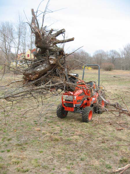

I have a Kioti CK20 with KL120 loader. The loader capacity at pivot pins is 1070lbs to full height. I took off the bucket, added a 125lb QA adapter and a 280lb Millonzi 48" root grapple. I have plenty of lift capacity for brush and can lift a big enough log that even with a bush hog on the rear and loaded rear tires I have to be careful driving forward. Of course there are some things I can load into my grapple that I cannot lift but so far those are limited to huge roots/stumps that I can just push along the ground. Photo of what I can and cannot lift attached.
I think with your loader you'll be fine. On the other hand, why not make your grapple a bit narrower? You shouldn't feel compelled to have a grapple the same width as your bucket. Wider grapples don't really add that much and do lower your total payload weight.

Thanks for the comparison. That helps a lot and appears as though I should be OK. So I guess there's no excuse know and I need to start welding!
