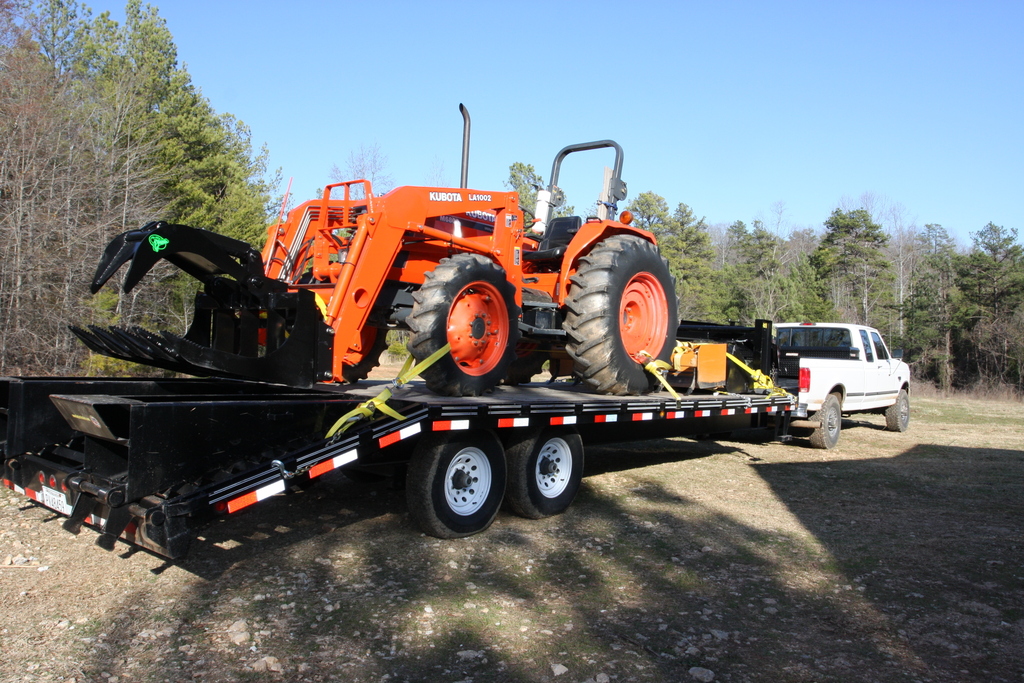

Definitely not the grapple for you!! Read the many post by IslandTractor (the grapple guru on TBN) For years, Markham Welding made a great grapple for a great price. Gator Attachments bought them out and I think is still in business. What you need is a 48" light or regular duty grapple, no wider! The costs should be under $1500. Don't forget to factor in how to control it, either the cheap way (running hoses from the rear remote, or the best way (an electric over hydraulic control) from someone like WR Long, who makes the complete kit ($600 ish). Also make sure your FEL is skid steer compatible or you will have to buy an adapter.
I assume your FEL has about 2000lb. lift capacity. A heavy grapple will eat up your lift capacity. A compact tractor does not need the same grapple as a skid steer. He is giving you bad advice.
I have a bigger tractor than yours, a M 6800 with a 2500 lb. capacity, and my 48" grapple is a beast. Many reasons for a narrower one, including better digging or uprooting power, less weight, lower cost, more simple, and absolutely no limits as compared to a wider one. Don't fall into the trap of thinking a grapple needs to be the same width as your bucket. Think of a grapple as a shovel. When you dig up a tree, you would not use a wide bladed snow shovel, but rather a narrower digging shovel that can be plunged into the ground with force. A 48" is a good balance for good digging penetration yet plenty of pick up ability to carry off debris. I can easily pick up more debris than I can see around and never have a problem dropping stuff. One upper thumb holds stuff just fine.

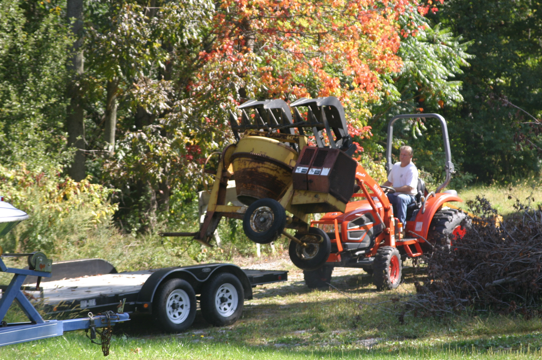

This is one of those 'too heavy skid-steer grapples', and the only time I've maxed out my lift capacity with it..
Not advocating over-buying, but 99% of the time it makes no difference, in my experience. If you're operating near your lift cap. on a regular basis, you probably need a bigger machine..
