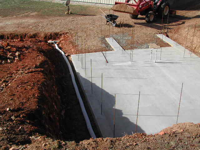

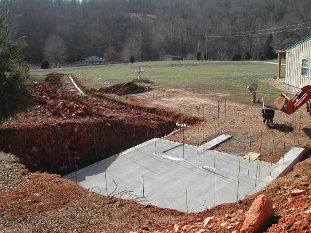

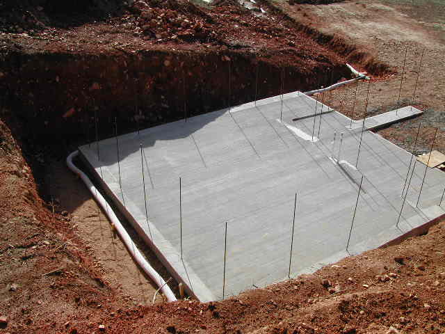

I'm doing this very project now, although my room is a bit larger and taller. I excavated the hillside out with my Mahindra and then hired a backhoe for trenching the utility, french drain, footer trenches out. I've gotten my slab poured with rebar every 4' or closer coming up about 5' high. I'm going to try the dry stack method of wall construction - I'm doing 8" block and using the surface bonding cement and then will core fill the walls completely and pour a 6" thick roof on the place and then cover with a couple of feet of dirt. My room will be approx 17' x 14' inside and I'll have an exterior closet attached about 5' x 6' to keep the generator, gas, chainsaws etc. in. Mine is mainly for a storm shelter but of course will be great storage for our canned foods etc. I wanted to build something large enough to have a bed in so when threatening weather is around, like tonite, we can go and get some sleep. Our severe weather seems to mostly come nights around here when all you can rely on is the radar & weather radio. We're working people and can't stay up all nite watching the radar etc. and then go to work the next day. The two extensions you see in the slab are for retaining walls that come out and will be backfilled - my hill wasn't quite deep enough to get the facility back as far as I would have liked but it will do just fine with what I have planned. The drain pipe is regular 4" slotted pipe with the poly sock over it that I got at Home Depot. I'm using creek gravel over & around it and will backfill my walls up some with creek gravel to keep drainage going good long-term - our dirt is mostly clay with chert rocks mixed in.

Run dual drains (side-by-side) while you're there. Tie them in to the downhill single at the corner...
