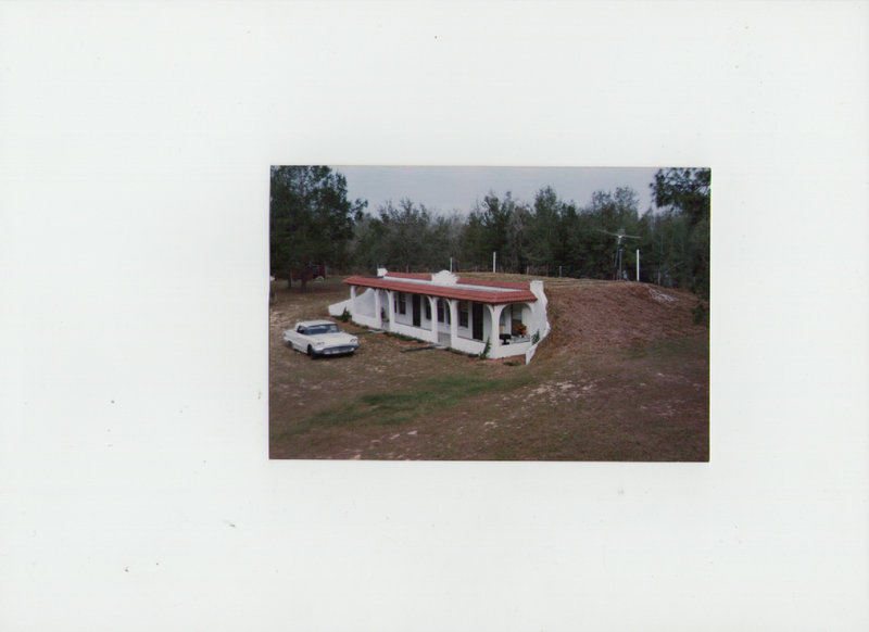

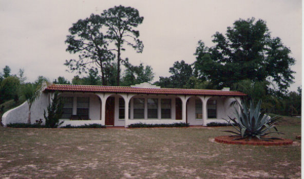

I mentioned in that thread about building a block inground shelter when we had a mobile home in Fla. The photos below show why we no longer needed that shelter. We built the whole house inground. The reason I mention this is that we used a unique (for houses) construction technique and that is that we used bridge decking for the roof. Bridge decking is nothing more that real heavy duty Galvanized roofing that is laid on bridges, roofs etc and concrete poured on top of it. The advantage of it is that it has it's own structural strength. We put steel I beams 4 ft on center and if I remember correctly at that spacing, would carry about 250 lbs. per sq ft.. about double our planned load. We DID NOT pour concrete on top but simply coated the roof with a roof coating, laid a double layer of 4 mil plastic, 4" of insulation board and covered it with a foot of dirt. As far as we know, this house built in 1984-85 was the first time it had ever been done this way and it's still there as good as the day built.
Now after that explanation, I'll get to the point. A friend from Alabama had visited and helped on the house, then went back to Alabama and built a storm shelter/root cellar using the decking for not only the roof but walls as well. He dug into a small bank, framed it with PT lumber, and put the decking on the outside of the walls and roof then used the excavated material to finish mounding it up. It was only about 4 ft wide and maybe 8-10 ft long but with proper design could be done larger. The decking at that time was only about double the price of steel roofing.
It wouldn't work well in a real wet area, but a cheap easy way to consider and one person can do it alone.
