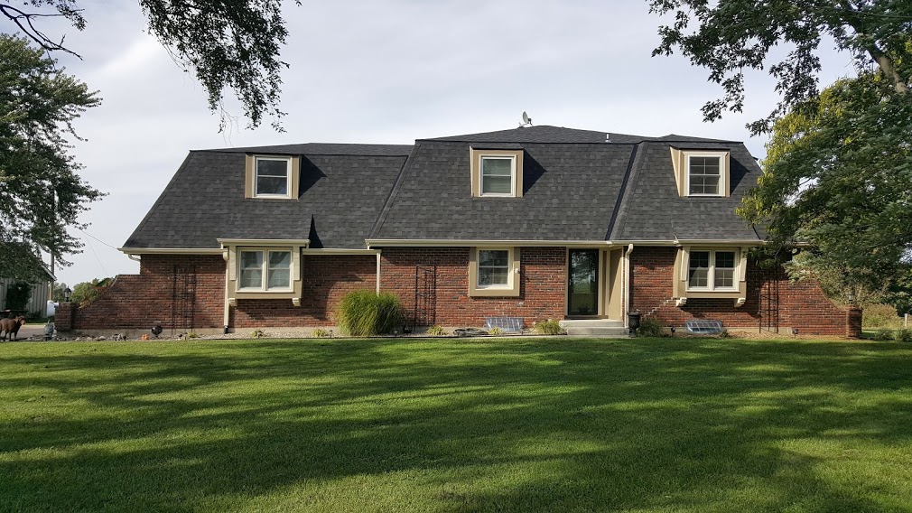

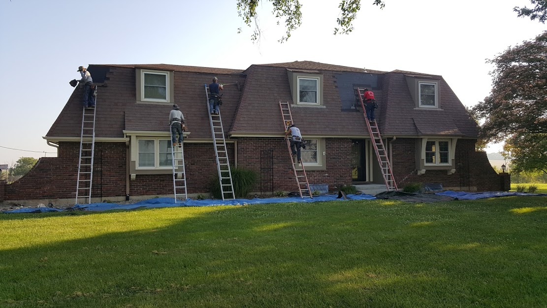

Well, just like anything. You gotta do your homework when looking for a roofer. For me, it was a pleasant experience. I watched the whole process. They started on my house on a Monday and finished on Saturday. I believe the whole project was around $14k. They did the tear off, installed all new paper, not tar paper, something new lightweight and better. Installed all new flashing and Owens Corning shingles. They also installed a new roof venting system. Here is the beginning and the end
