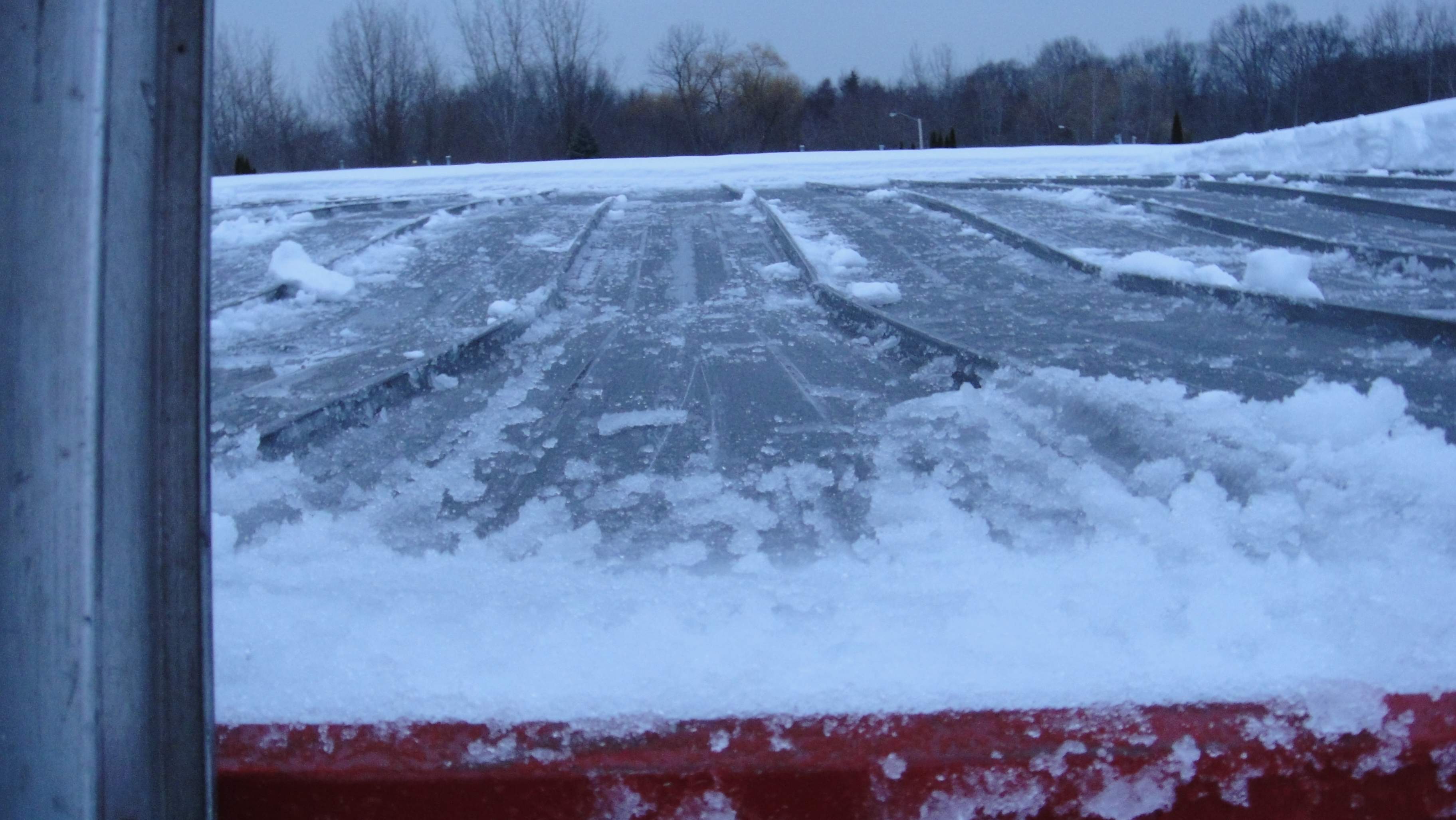

Do you mean feet? cause that's what we've had, No roof around here is going to collapse with 1-2 feet of snow on it, these roofs have been there done that over the years.
Sure this situation is gonna cull the weakest but some of those buildings are 100 plus years old, seen alot of snow in their lives.
The snow compresses down, the killer factor is the areas where the snow drifted to 2-3 times the snowfall. Some parts of roofs may be blown almost clean where others are 4-6 feet deep of compacted snow.

No, I meant inches. I didn't see a single roof in that slideshow with more than a foot on it.
   / Roof Collapse Slide Show

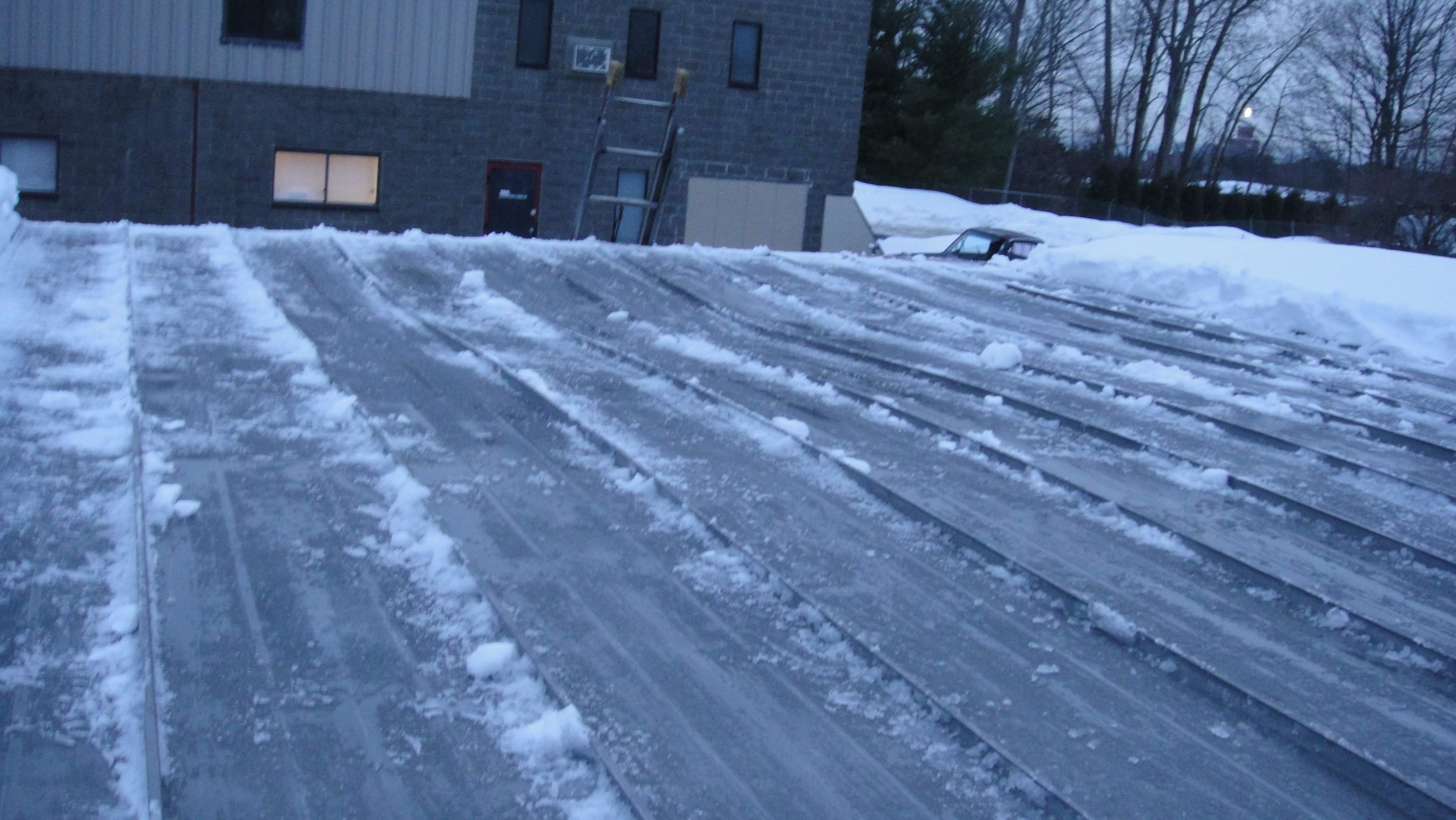

It's very deceiving, I agree it doesn't look like much.
Here's a pic of a newer self store building I was working at yesterday, this snow was as heavy as concrete, you can not pick up a snow shovel full with out hurting yourself. Look how it buckled the metal roof, this was made worse by the bozo renter who removed a partition wall between 2 units, the walls are just corrogated sheets but they do provide support as well as divide.
I've cleared this roof twice and have to install temp shoring.
JB.
