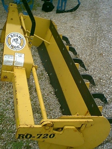

Here is a picture of the one I bought, taken by Sweet Farm Equipment:

I have the 60" BH - ROBB. It has been useful and dependable.
Torque the hex nylock nuts which secure the rippers.....mine were loose on delivery.
Lube the rollover hinge regularly to prevent rust/seizing....I use Fluid Film
Lube the draw pins occasionally.....I use spray graphite from Napa auto store. Graphite does not hold dust.
ROBB shelters outside under an 18 ounce canvas tarpaulin. I wish I could store ROBB in my humidity controlled garage but garage is full up with Kubota stuff, car already displaced to the driveway.
I had a difficult time loading mine on the 3-Pt. at first.
I am giving you the link to my thread on this, hoping to shorten your learning curve.
Now I get the beast on/off in three minutes.

I have the Dirt Dog 6' RO BB and I am very pleased with it. I think it is the same as the Bush Hog branded BB as they make them for Bush Hog. It's not for sale, but I thought I would chime in with the others as it is a great BB. With the rippers down it is all my MX5100 wants. I had to replace one of the springs on the lever return this year when one came loose from the lower connection and it wedged between the frame and the box and bent it. I bought a replacement spring from TSC, they have them in stock @ $2.99 for a package of two. I also bent a ripper when I hung it on a large rock, but it was no problem to straighten it. This is a functional, useful attachment.
