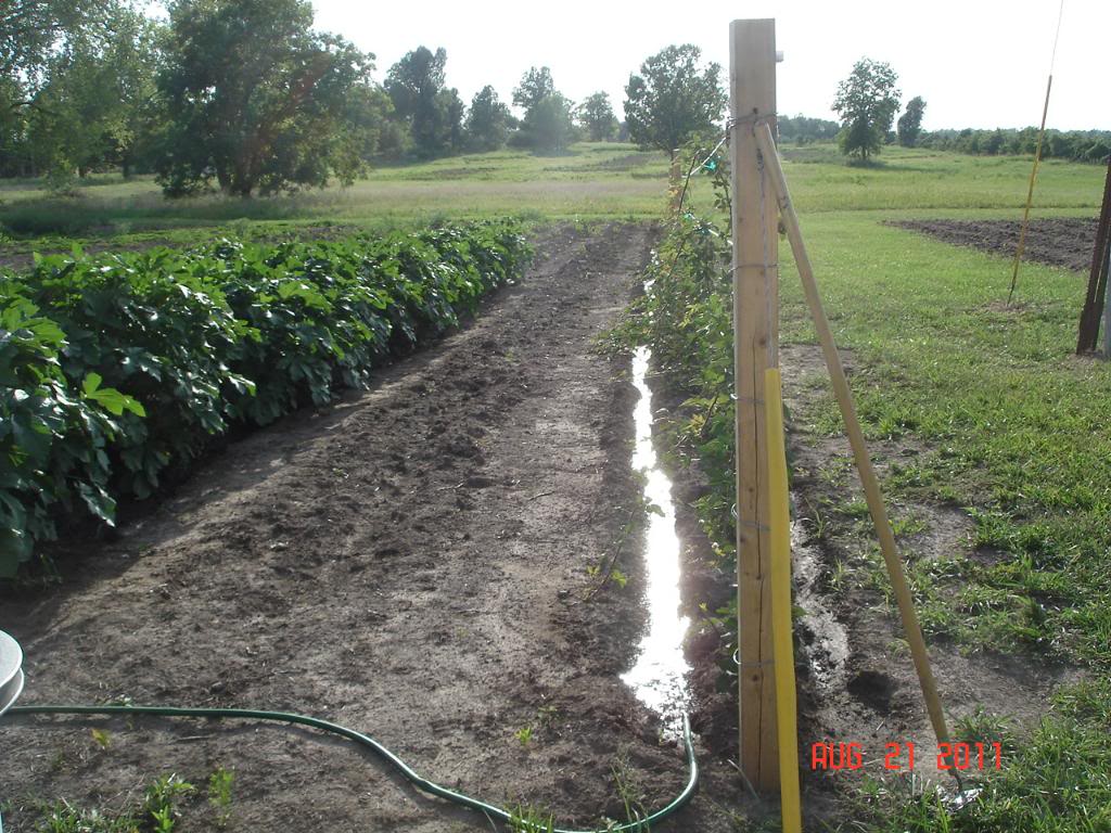

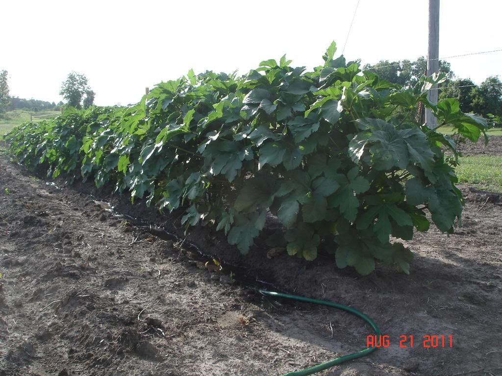

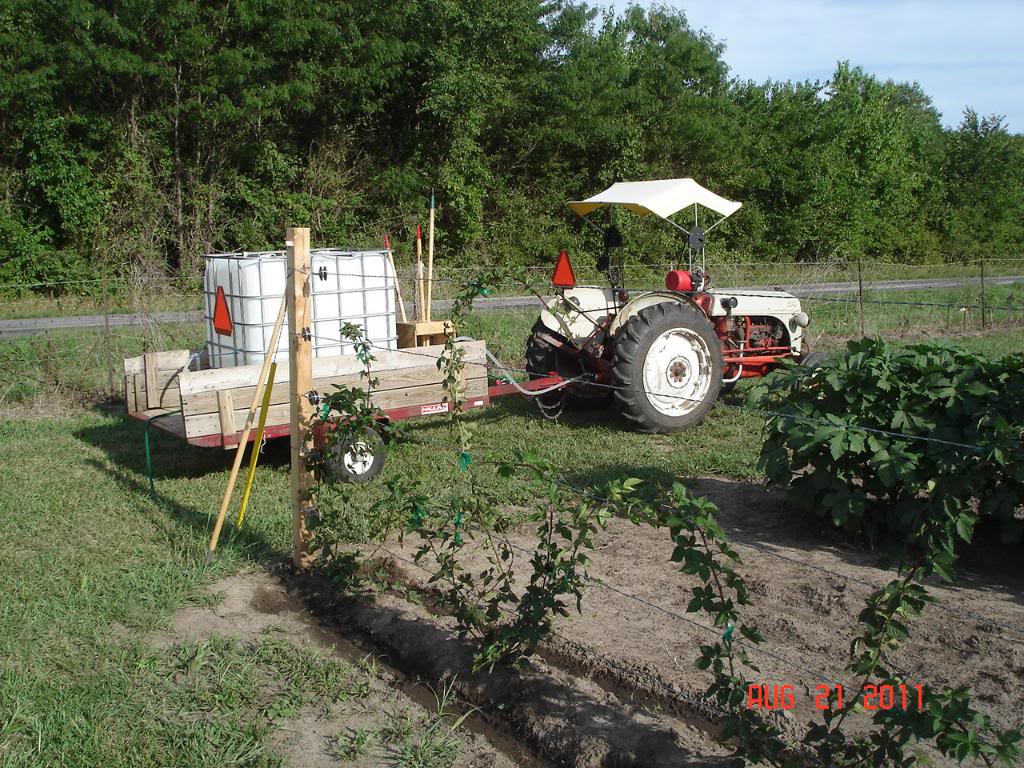

I use one with a tote tank to flood the furrows at our market patch. Usually just run the pump a little over idle to get a nice flow going, that doesn't carve out the furrows. I pump from the high side of the garden, it runs slowly down to the end of the rows. If it starts running off, I move the hose to the next row. The furrows alongside the row were created by my disc hiller. Mark

It's a 6 roller, Silver Series Hypro. The Silver Series is supposed to be "Round Up Ready". Got it off ebay, NOS, for a song. I fill up the tote at the river using the same pump and hose, and have to haul it to that garden location. I like TRR's suggestion, I'd need a couple of more totes. There are 3 patches about 140' square. Each patch has several rows. Not sure how I could make the drip work, but open to suggestions. Mark
