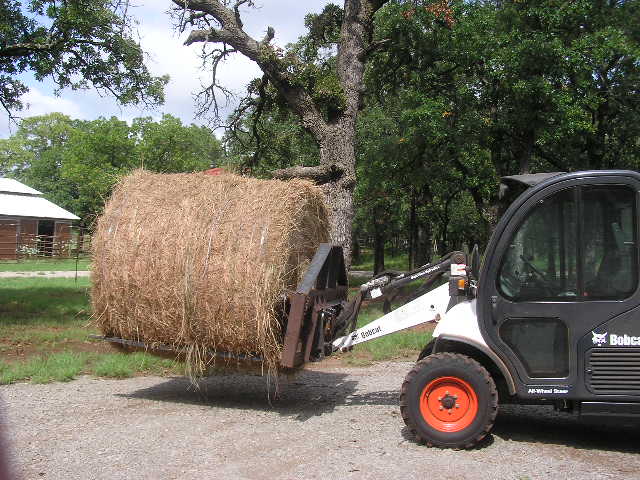

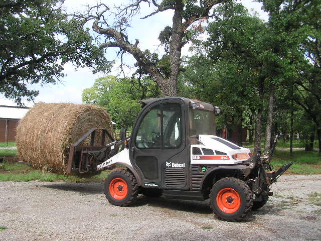

Re: rollback force on SSQA
Just for future info seekers on rollback, forks and frame weigh 715 pounds, total weight on SSQA is 1847 pounds. About 3 feet out to the center of the 5x6 bale.
G series rolled it back no problem and no counter weight on the 3 point hitch:

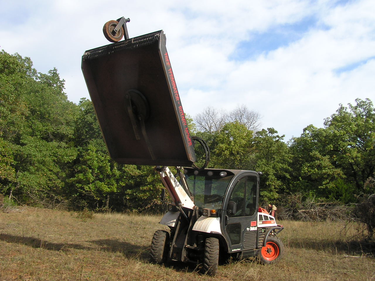

Some more rollback pictures, this time on the F series.
The 7' wide, 1800 pound brush hog:
