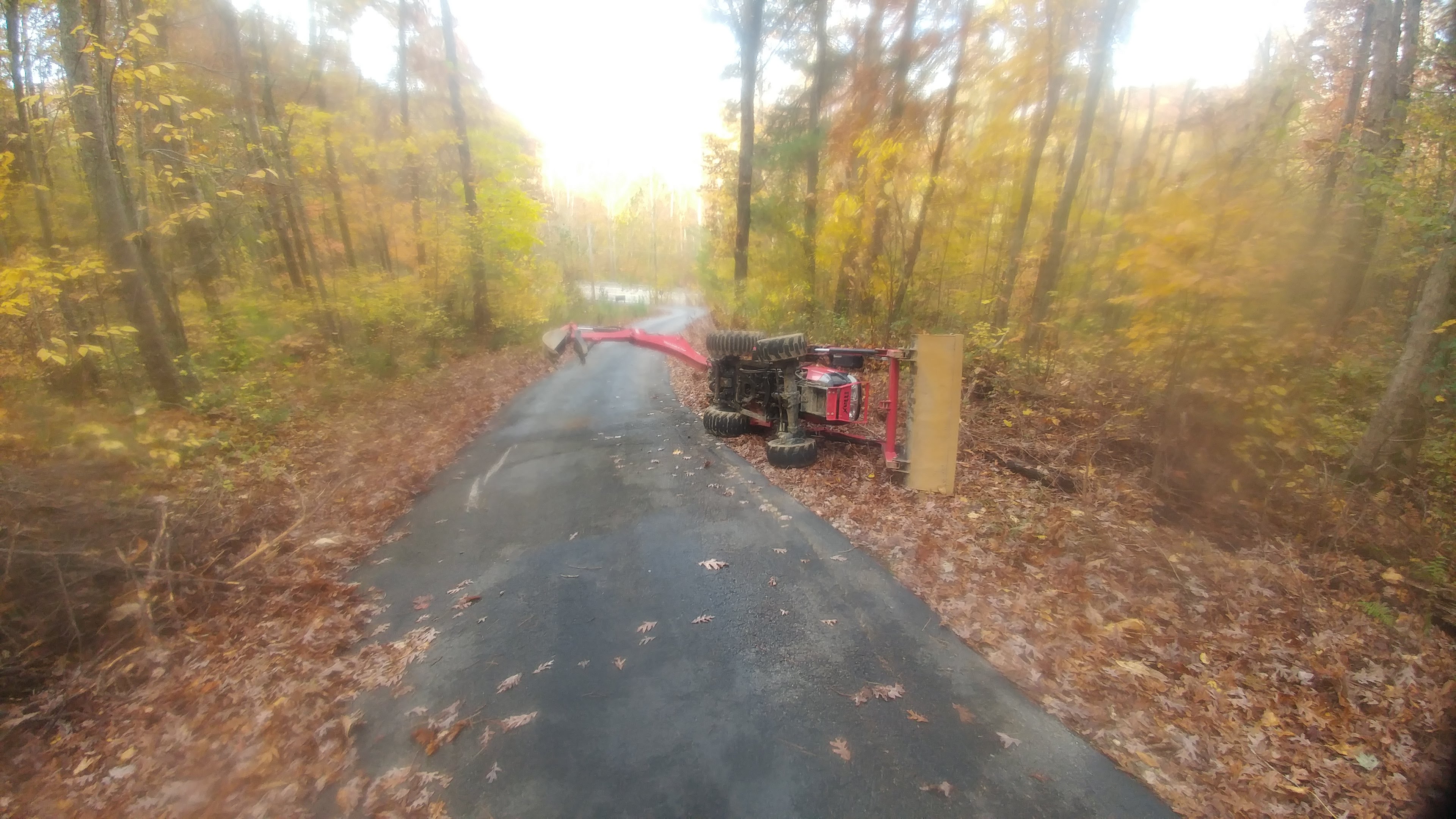

Max 22 2015
Here's my story: I have a long steep driveway covered in leaves. I hung my backpack blower from the rollbar behind the seat so I didn't have to walk. Worked fine on the way down but on the way up it swung out and pushed the backhoe controls. That caused the backhoe to go to the side and then down and down and down. Before I knew what happened, the bucket was on the blacktop and pressing down flipping the tractor on its side. Somewhat of a ride! No damage to humans or tractors but from now on I'll put the pins in the backhoe! Learn from my mistake!

Wow glad your ok, did you bail out as it was going over?

I found a "hole" to hide in on the way over. It all happened in slow motion. The tractor was still running so I had to shut it off and the leaf blower was also running.
Used my F150 to upright the tractor. Locked the brake down before flipping it back on the wheels so it didn't roll down the hill. Pulled it up to the barn and checked the oil. Got it started and it smoked a little for a second or two but that cleared up and it's fine. It was on its side about an hour.

Good idea on locking the brakes before righting, there's a lot of videos on youtube where people forget to do that. It doesn't turn out well. Vehicle either rolls down hill causing more damage to itself or something else; or it twists the pull vehicle sideways and rolls that over as it rolls downhill.

Other's may chime in and I've never messed with injectors (knock on wood), but I think people sometimes pull or loosen them before turning motor over in case there's incompressible fluid on top of the piston to give it somewhere to go instead of bending a rod.
