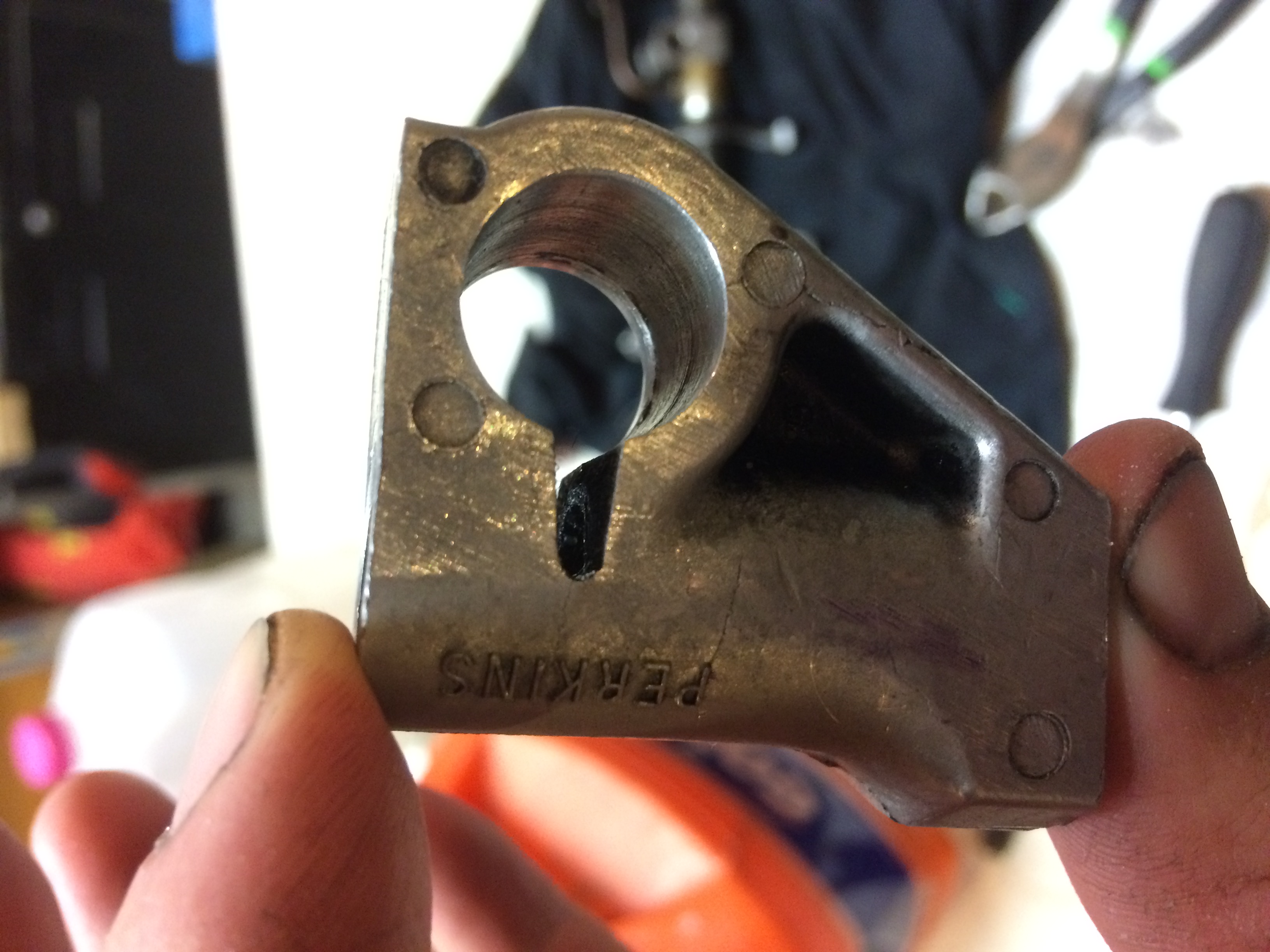

Putting the rocker shaft back together and I'm unable to get the last bracket on. The bracket was a PITA to remove and required some heat. I gave it a light tap on reassembly then took it back off as it's not sliding on smoothly. Any suggestions?

It's a burr likely created when I gave the bracket a light tap with a hammer. They are made of aluminium. Noticed a bit of shavings when I was finally able to separate the SOB.

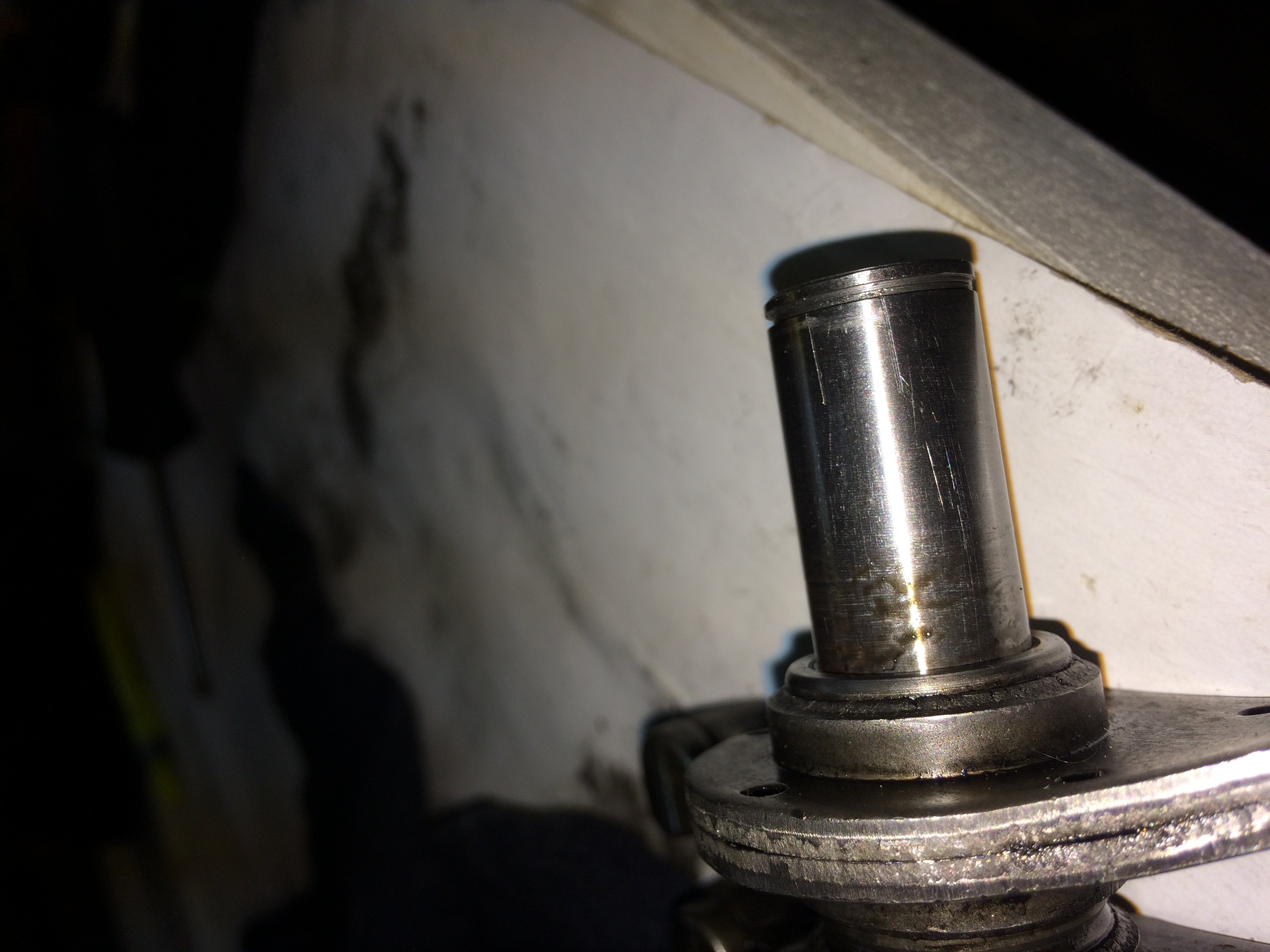

Closer examination shows some damage at the start of the assembly shaft.
That's where I'm getting hung up.

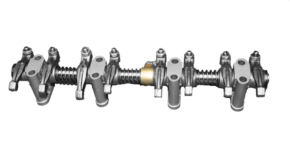

The last bracket also has some damage.
It's the far left bracket in the third picture.
It doesn't show well but in picture number two there's some damage visible in the 1 o'clock position. It's likely from lightly tapping on it in the removal process.

The plan is to file off the flat spot of shaft with a metal file.
Then I'm going to take 60 grit sand paper and clean up the gouges in the aluminum bracket.

I wouldn't use the sandpaper. Take a 3 cornered file and grind the teeth off two flats to make a sharp edge. Use that to scrape only the highs out of the bore. You might be able to do the same with a pocket knife. I have a file ground that way with a wooden handle and it is very handy for deburring parts. The hone would work too, but be careful to only take the burrs out. You don't want to make it loose.

My neighbor came by with a small file and touched up the end of the shaft.
He also deburred the inside of aluminum bracket with the same file.
He then took 120 grit sandpaper her and worked the last 1.5" of the assembly shaft.
Everything slipped back on real nice.
