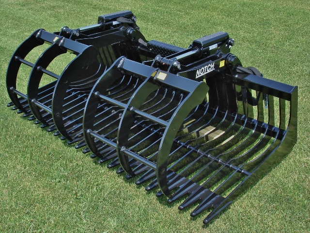

There are many to choose from: rock bucket/grapple - Image Search
I don't think normal use will damage any well built grapple. Mine have survived abnormal use :D.
I would recommend this style without the side plates: NOTCH Manufacturing Inc.

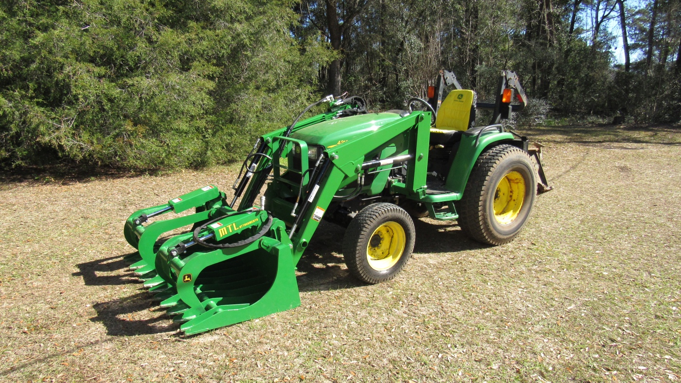

I got a chance to use my MTL rock/root grapple some yesterday.
I like the solid back but as far as having the closer tines I think they are just extra weight with little benefit. I was hoping I could use it to sift dirt from my piles of debris but the dirt doesn't come out easy and the action required to make it come out results in a fair amount of debris falling back out. The dual lids have a pretty wide space in between and that is part of the problem.
The work I did yesterday could have just as easily been done with the 48" single lid root grapple and had less weight on my loader. I would like to try one of those and weld some expanded metal on it but an actual dirt sifter is probably what I need.
For moving tree debris it works fine but you can use a lighter weight root grapple for that. I went with a diverter type setup for the third function and it took a little while to get used to remembering to move the loader handle back to center before releasing the button. Now that I have that mastered the diverter use is seamless. I have added about 1200 lbs of ballast to the rear and do not plan to load the tires. Takes less than 5 minutes to connect and disconnect the grapple and ballast with the quick hitches on both ends.
