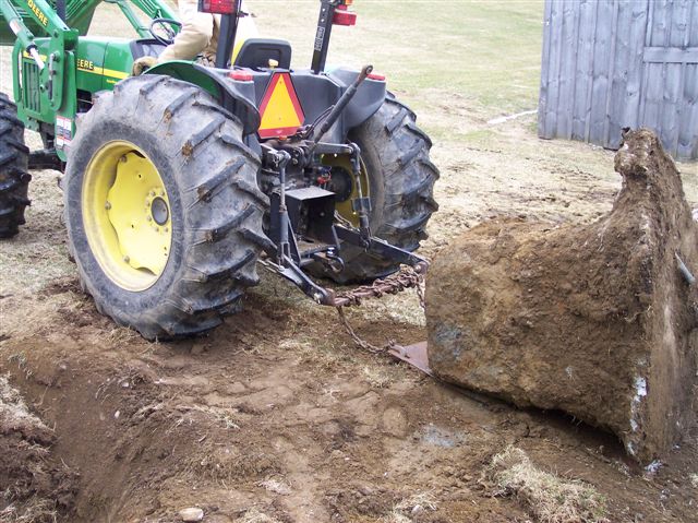

Mornin Jim,
We used this setup a couple of weeks ago. It was 1/4" Diamond plate steel with torch cutouts in the corners for chain hooks. The playe was 2' x 5' approx. This chunk of concrete was heavy /forums/images/graemlins/grin.gif

I have never hauled anything that heavy but I have a piece of 3/4 inch plywood that is 2'x4' that has a hook bolted through the front end that I have loaded with rocks as high as I could stack them with out falling off. I have been using this plywood for over three years. The bottom of the plywood is really polished from all the moving it over sand.
The plate steel will work for anything that is not too big for your tractor to pull. If you can have the weight a little towards the back of the plate the front end won't dig in.
That is one huge hunk of concrete.

That steel plate is a good idea. If you use a very short chain to hook it to the drawbar it will lift up on the plate when you pull and transfer some of the weight of the rock(s) to the tractor. This will give the rear wheels more traction and also make it easier to pull since you will be dragging less weight .
