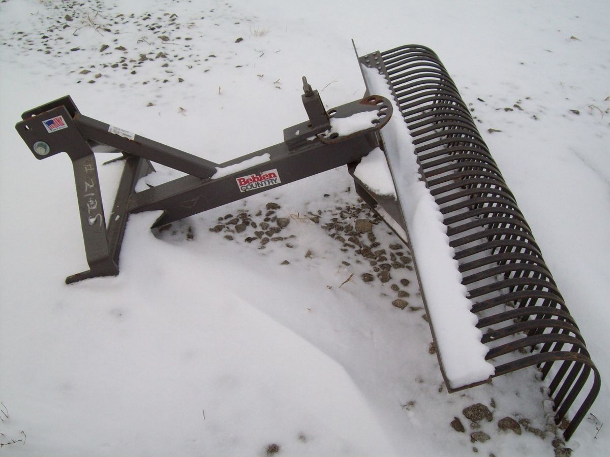

/ Rock Removal? #6
Like a landscape rake? B.

If the rocks are simply lying on the ground, loose and out of the soil, a landscape rake would be worth a try.

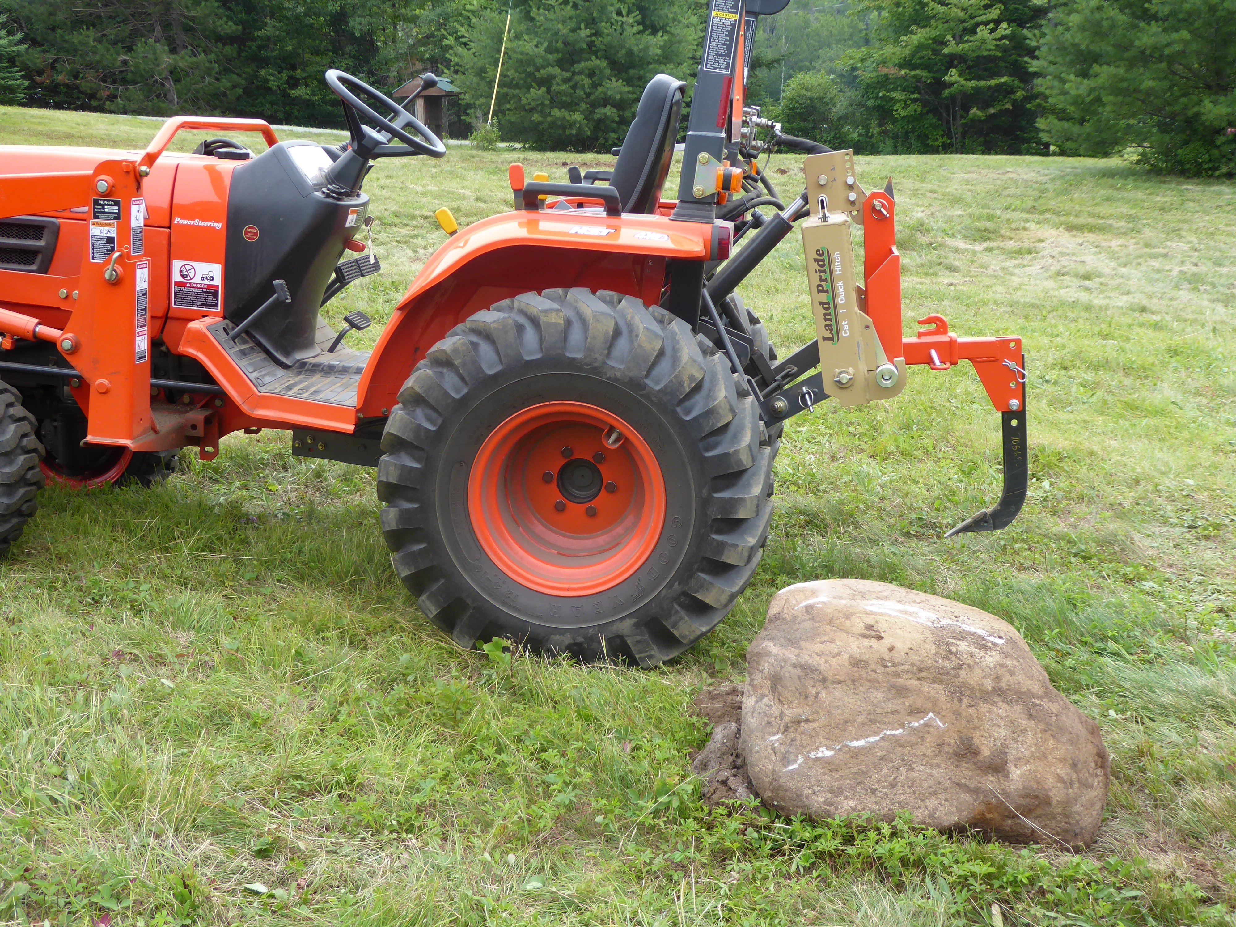

You want to remove rocks??
I recently bought a Heavy Hitch with the subsoiler attachment. I was absolutely amazed at the ease with which this implement rolls pretty big goonies out of the ground, and without any digging or manual labor whatsoever. Worth it's weight in gold to me!

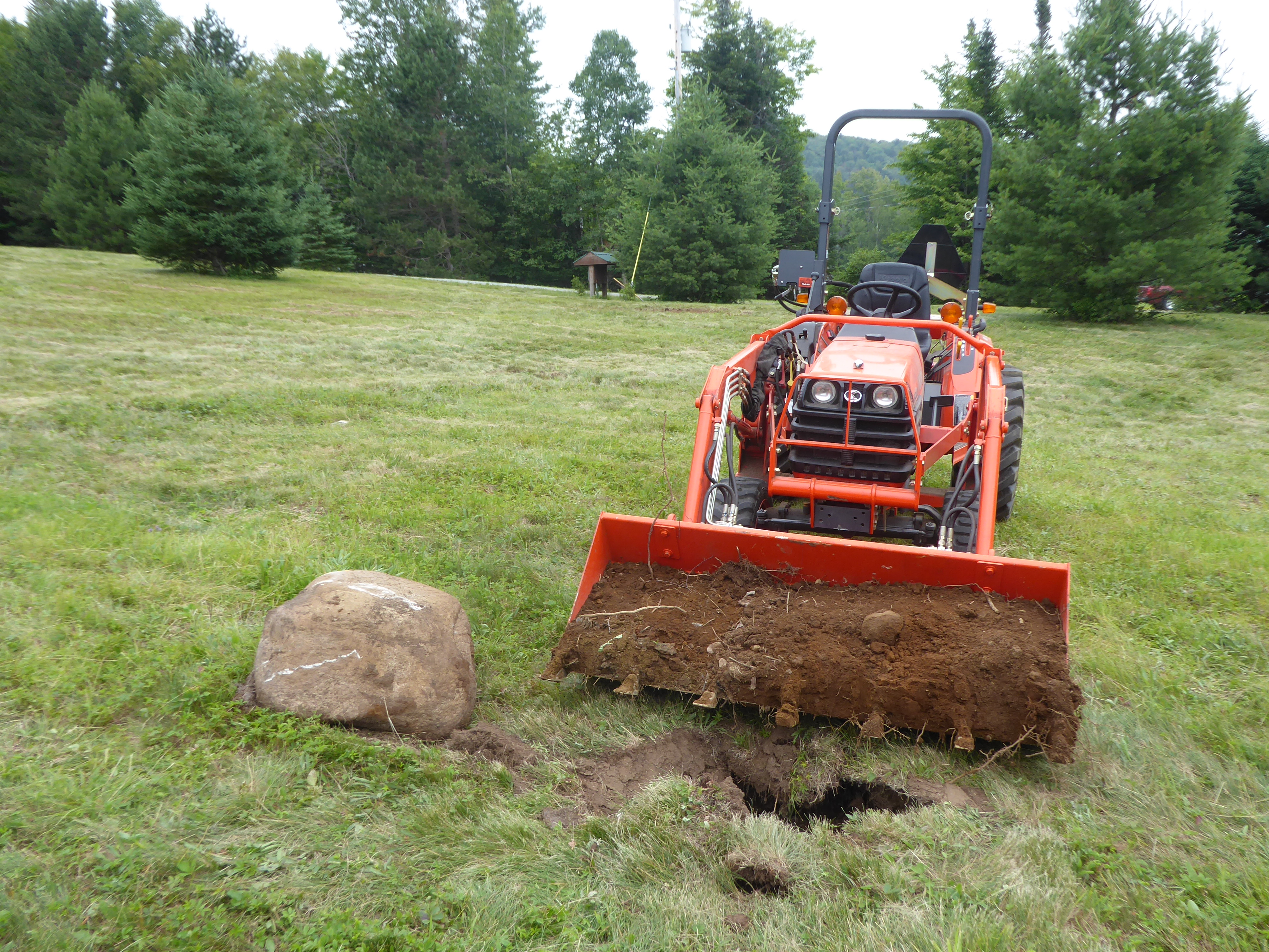

/ Rock Removal? #13
I made a HD 'tooth' that I clamp onto my FEL bucket.
Used an old axle shaft that was about 1 inch in diameter and 16" long.
Since it was tossed together in about 1/2 hr or so it is not pretty but sure does the trick.
I drive it in and under the rock and tilt my bucket with the heel resting on the ground.
I have 'popped' up to 2ft rocks that are mostly buried with relative ease.\
That big 'tooth' is also great for smallish saplings, cedars and firs.
Usually the saplings come out clean without clumps of soil.
Since I am driving a single tooth penetration is good and relatively easy.

/ Rock Removal? #16
Why wouldn't a single pallet fork do the same thing??
On MY tractor, I do that with both of them on, pushed together.

/ Rock Removal? #19
That's exactly how we hope & plan to pull larger rocks out via sub-soiler. Do wish you'd have shown a "before" photo of that rock.
Thanks for posting this blacknTan
