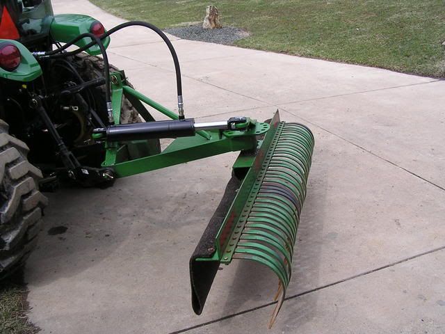

CadizHunter, Tractor Supply has the KK rakes for $300 or $400. I've owned one for about 12 years and use it probably 50 hours a year for snow removal and maintainence on about 3000 feet of slag road. The Landpride,Fronteer and York Rakes are probably built heavier than the KK, but are also somewhat pricer. The KK has given me good service and I don't have any complaints. You may find one at a farm auction or maybe a landscaping company auction. Pick up a copy of Farm & Dairy at TSC and check out the sales and auctions in there. Once you get the rake be sure to try it out on snow removal. You will find that is is the best implement there is for removing snow on a stone road.
Here's a couple of pics of my rake and tractor, just added hydraulic angle to the rake this week, but have not put it to work yet.
