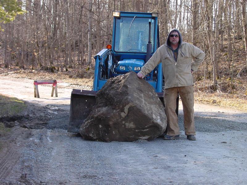

If you can move the rock at all you can put some smaller rocks or blocks of wood around it, then as you shift the rock these will slide under it, maybe throw in some dirt or sand, and you might be able to get the rock up higher. Then maybe scrape out a bit of a slope down to it, just to make it easier to drag out. This rock kept poking up out of my road a little more each year and that's how I got it out. I've dug out a lot of rocks and stumps, and found that once I can get them to move just a little, they are history.

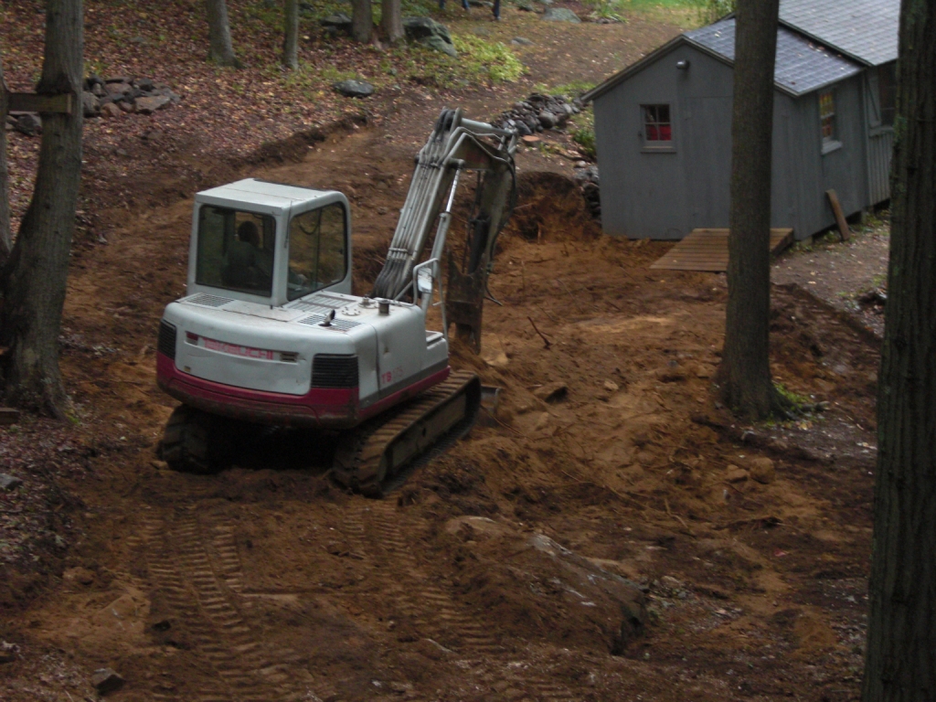

This is what the guy with the excavator did in about the same amount of time that it took me to dig, chain, winch, and pull that one rock in my previous post.
After this guy got finished, I started thinking of excuses to go get an excavator for myself....but way too much $$$ and not enough excuses...

That was my point. I've done alot that I can lift, alot. One or maybe two grand, grand ones is OK but when there are multi's get a machine made for it.
I spent weeks cutting down pine and cedar trees (8"s to 14"s and some bigger already down) and left the stumps. Had man come in with dozer to dig my house hole which ended up being on solid rock. While he was here I had him push out/clear a section while leaving larger nice selected trees. He did that in a few hours and knocked down my 30 or so stumps and cleared out all the undergrowth and debris and leveled it out. He did in hours what I hadn't even finished in weeks of dangerous and hard work.
