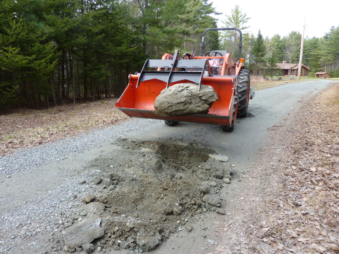

I have taken out more than my fair share of road rocks, all sizes, with my tractor. If your road freezes solid in winter and then you have a muddy season when the frost starts to come out; that is the absolute best time to get the rocks out. It seems they almost float out in the mud and water that fills the holes. Once the road drys out it is much harder to free them.
Also in addition to your tractor you would be surprised at what a heavy 5 foot bar can do to help you.
Up to this size is easy. Bigger ones are more work. I took this when I was testing my new grapple. That is why the road is dry.
