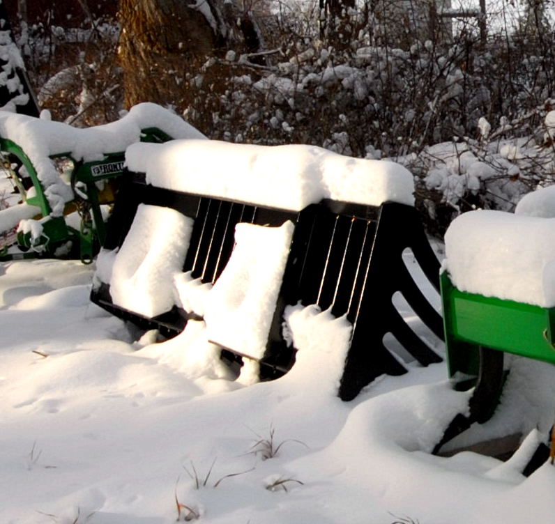

Thanks guys. I bought this one back in early December along with the tractor.
Nice pic. Ok.... is that a Virnig or a WorkPro or a Bradco or a....

Sorry, I don't know. It was at the dealer when I decided to purchase. It looked like what I wanted, so I just said add the rock bucket to the order. I'll have to check and post back later...

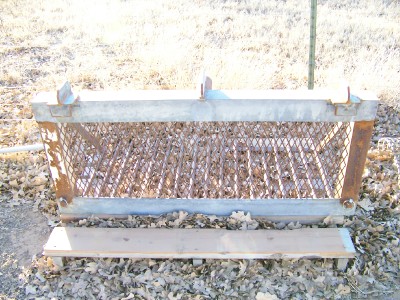

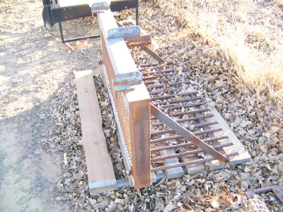

I needed to reseed the pastures but had alot of sandstone rocks. I priced out the JD rock bucket at $1800. So I said the heck with that and built one useing 1 inch round stock and some 3 x 3 angle. Its only as wide os the FEL arms but worked good. The spacing on the round stock was 2 1/2 inches but should have been 3 or more.

Good job! Is that what they mean - "Necessity is the mother of invention" - when somebody quotes you $1,800...
