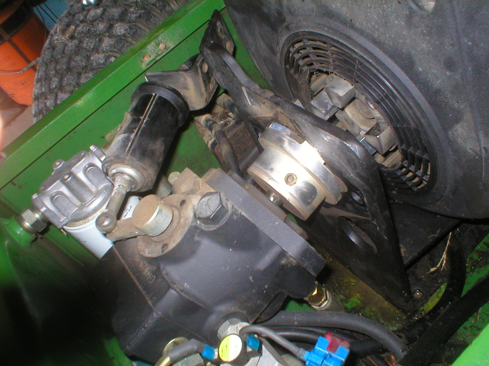

Has anyone ever replaced the ignition coils on their Robin engine? Mine started back firing the other day, Terry thought replacing the spark plugs would fix the problem, no such luck,checked and reset the valves still back fires some , the spark to the left cylinder is not steady, so we think the ignition coil is the problem. I guess the engine has to be pulled to get to the ignition coils. This is my first major problem with my power trac over 10 years old and almost 1,400 hours on it.

   / Robin Ignition coil #4
Ernemats:
I replaced my robin engine coils as part of a recall. Here are the major steps from what I remember, you will fill in other steps as you go. In order to get to the coils, you have to remove the engine shroud. That means pulling the engine up out of the tub enough to get clearance. That means, removing the muffler, removing the battery, disconnect the hydro cable to the tram pump, removing the front tram and rear PTO hydraulic pumps. Try to match mark the engine to the engine mount, and then unbolt the engine. Using a chain fall, lift engine just enough to remove the shroud, and then replace the coils.
When reassembling, re-align the engine to the front tram pump using your match marks and confirm the alignment with straight edges. If you search for lovejoy alignment criteria, you can find the specs. As I remember, the engine sits a little high, but within specs. It is tight getting to the engine mounting bolts. Have the PT on jack stands with all 4 tires off of the ground so that when you restart, if the hydroback cable is not properly adjusted, the machine does not take off on you. You can adjust the cable for neutral with no creep while on the jack stands. One other member who replaced the coils forgot to connect the ignition ground wire, and when the PT restarted, it took off because the hydroback cable was not properly adjusted, and he could not turn off the engine. A wall stopped the PT.
Hope this helps.
   / Robin Ignition coil #5
I replaced mine (for recall reasons) without lifting up the engine. I took the pump in front loose and then could slide the engine shroud forward enough to barely access the coils. Removing the engine would make it easier if you have the engine hoist. I have a model year 2000 with pumps in front of and behind the engine. Your machine may be different.

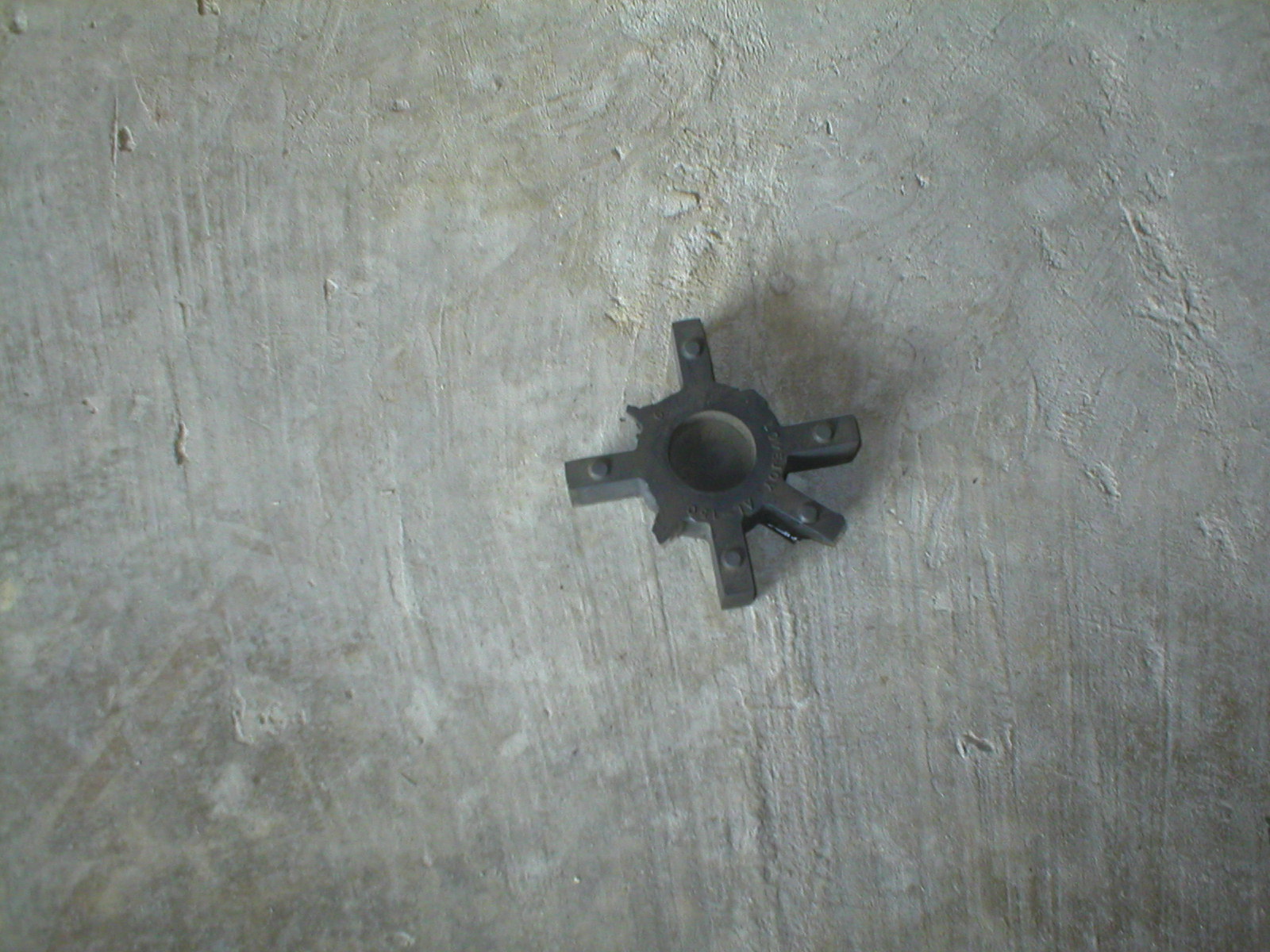

I finally finished replacing the ignition coil ans some other things. I did not do everything the same as Bobrip or Duane suggested they had done. I unbolted the engine platform from the tub as Terry said, I then took the muffler off, took rear pump off, took front pump off , removed the battery and fuel tank. Then I could slide the motor back enough to get the shroud off enough to get at the ignition coil on the left side. During this process I discovered the front lovejoy spider was bad, had to wait several more days to get a new one,(picture of old one). Got everything together today and ran it for about 30 minutes repairing my driveway the rain had washed out yesterday. It seems to be running good. Thanks for the helpful suggestions.
