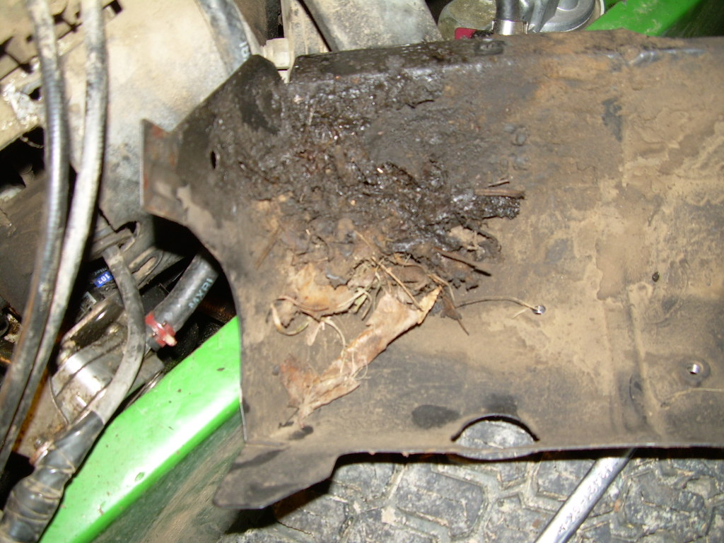

3. Remove four bolts between the tub (back section of the PT) and the engine mount. The bolts are accessed from underneath the PT and from inside the engine compartment. I had a lot of trash (mostly leaves and oil) in the tub. It helped to remove the cylinder baffle from the left (fuel pump) side of the engine. The baffle (sheet metal cover) had a lot of leaves and oil in it. I ended up cleaning out both sides.

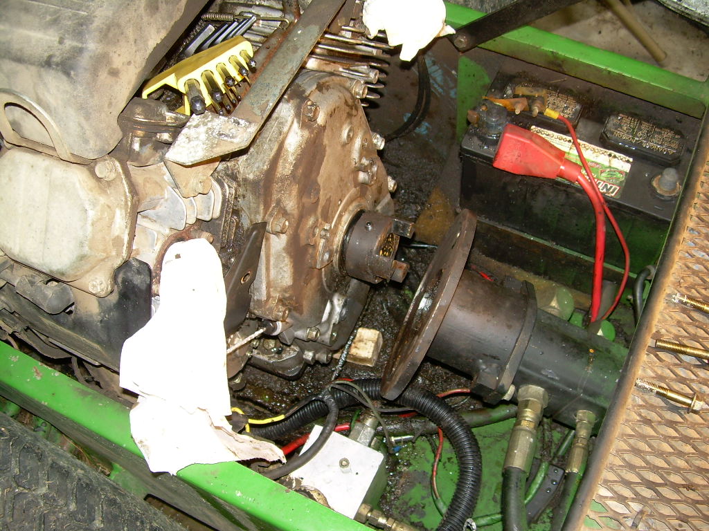

To Continue

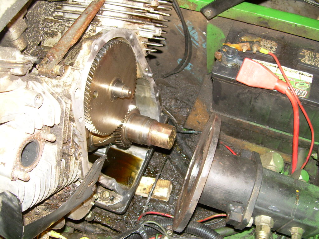

6. I removed the bolts from the main bearing cover and pulled the cover off. I scraped the gasket off using various devices (razor blade, chisel, and wire wheel on a Dremel Tool to get the last bit off.

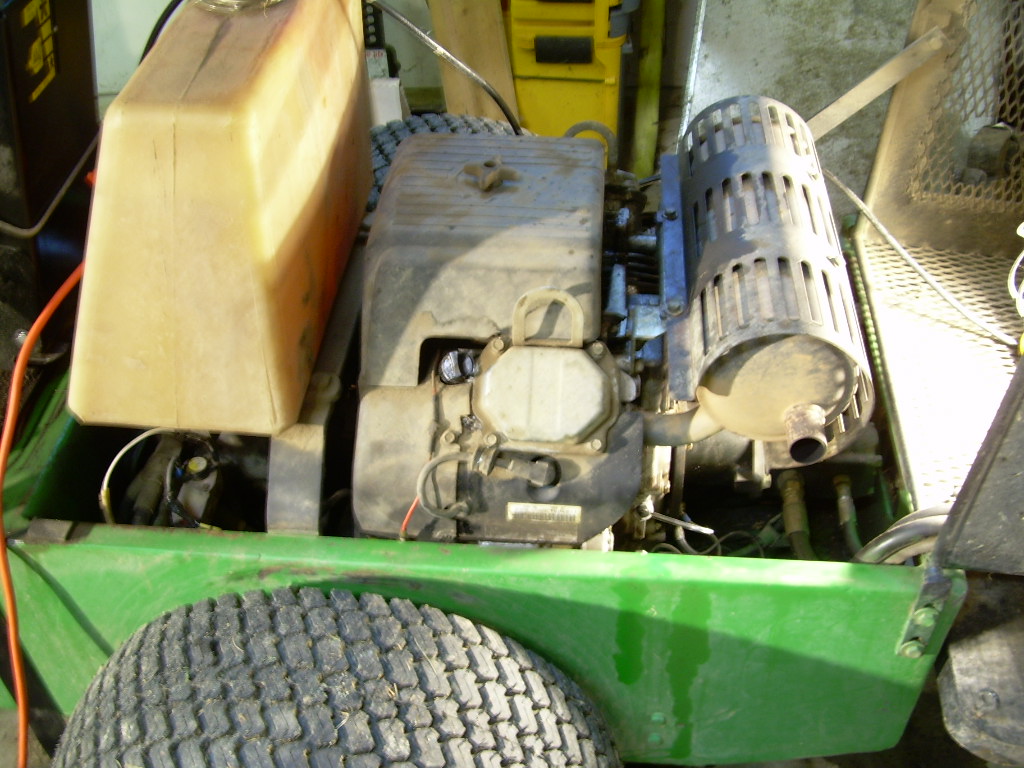

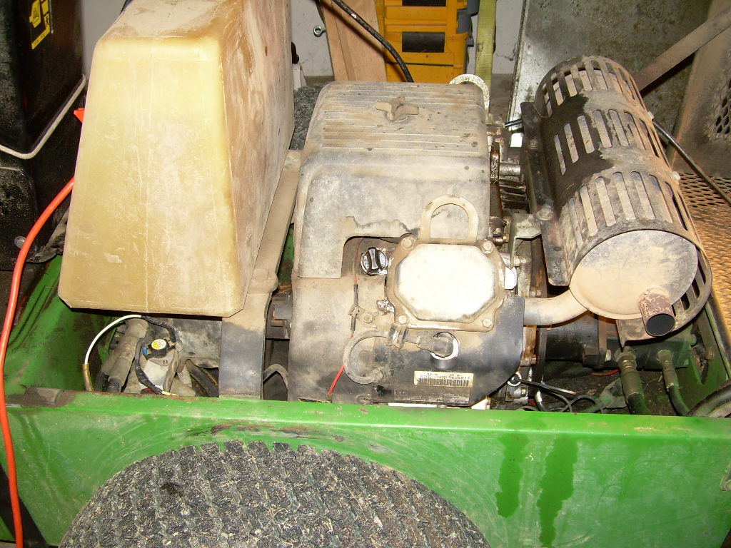

I have many pictures. Notice that the engine is centered between two sets of pumps. The back pump which I believe is for the PTO and aux functions (lift, steer, tilt) was the one I dropped. In 004 I have removed the muffler

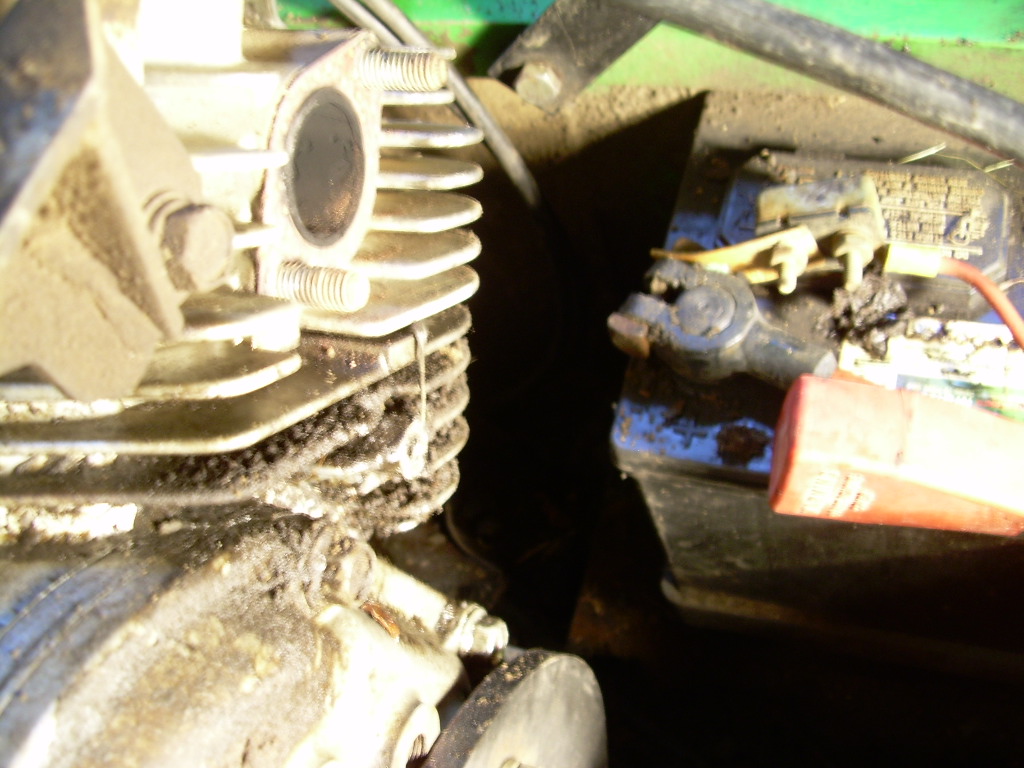

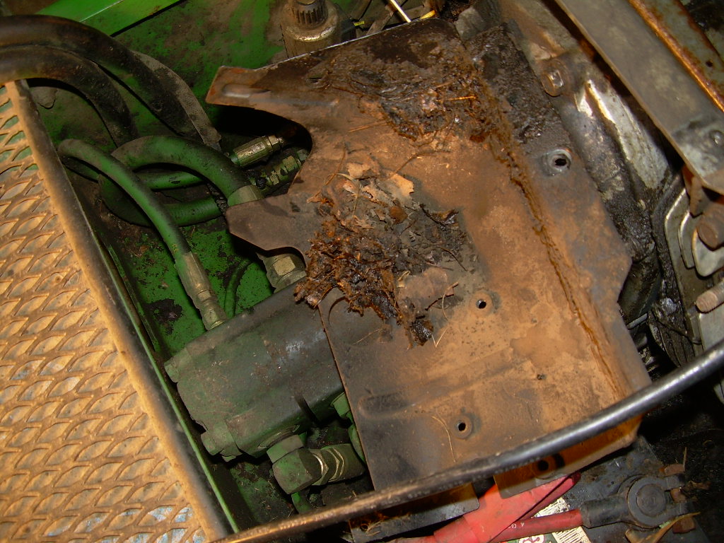

In these pictures you can see the leaves in the cylinder baffle and the trash on the cylinder fins. I will try to clean these areas every 250 hours from now on.

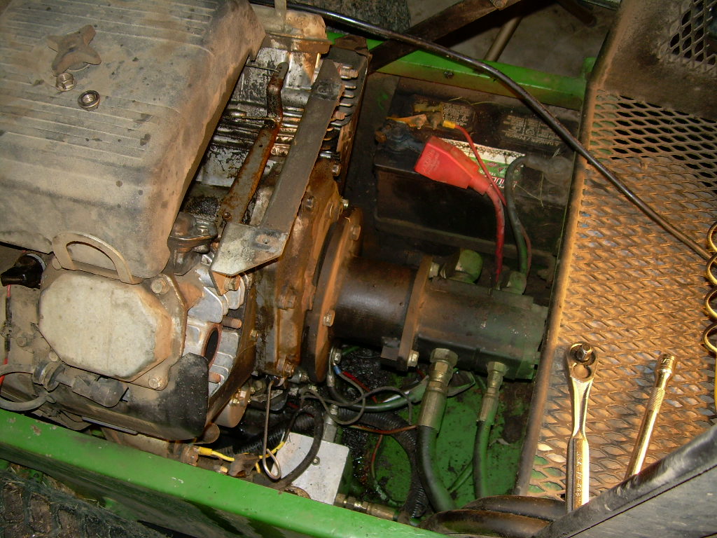

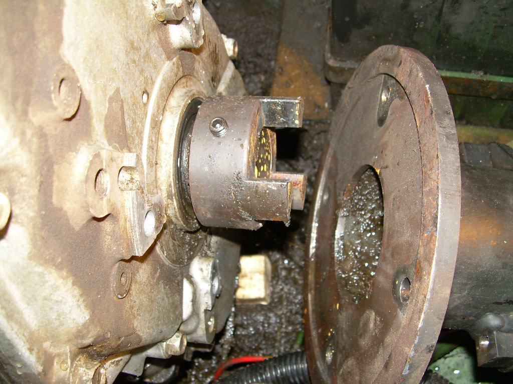

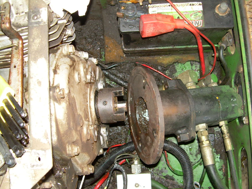

In picture 11 you can see that there is not enough clearance to remove the pump. It is hanging on the Love Joy connector.
In the other pictures I have removed the gas tank and taken two of the four bolts out of the gas tank support bracket. This gave me enough clearance to slide the engine forward and drop the pump. No hoses were disconnected. I should have gone ahead and removed the gas tank support bracket since I had to remove it later in order to turn the engine over by hand when reinstalling the pumps. This helped to align the Love Joy connector.

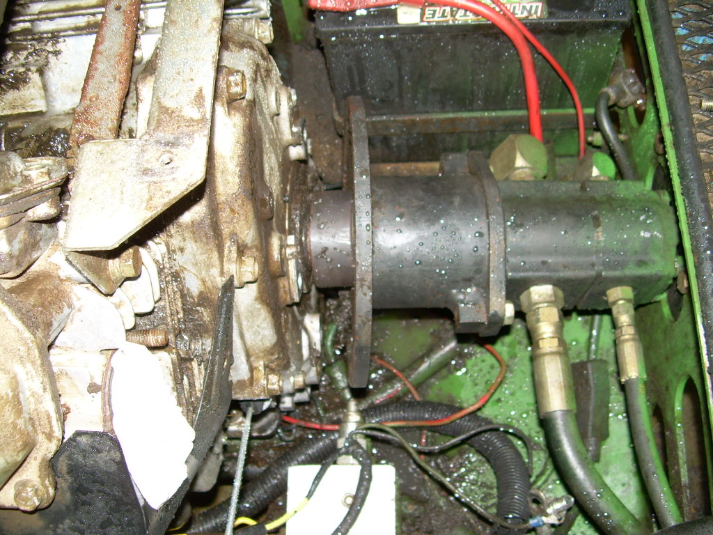

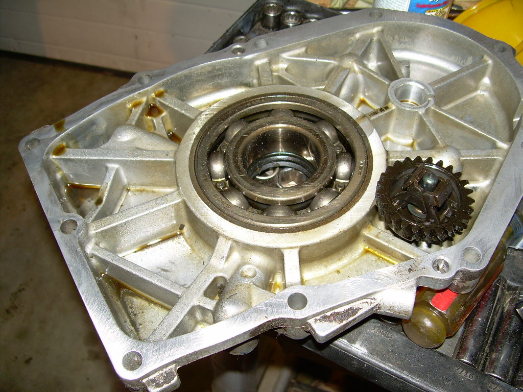

There was a lot of dirt and oil on bearing cover near the bearing seal and this makes me think that the bearing seal was leaking. I had planned to replace it anyway. I had actually power washed this area so it is not as dirt as it had been.

I forgot, but I had to pry up on the engine and put a 1 inch thick block of wood under it to get enough clearance to remove the love joy connector from the engine shaft.
In picture 19 I have cleaned off the gasket. I removed the bearing seal with a punch from the back side of the cover.
I then started reassembly. I used grease on both sides of the gasket to get a little better seal.
Aligning the love job connector took two people. I turned the one on the engine to where one tooth was at 12 o'clock. I rotated the one on the pump to have a notch at 12 o'clock. It was still difficult to put the pump on. I had my neighbor put channel locks on the front of the engine and rock it back a forth while I lifted and pushed the pump on. This took 15 or 20 minutes trying various things. It finally went on.
The rest of reassembly was pretty straight forward. I did clean the cooling fins on the oil filter support. They were completely clogged. The total job took about 3 to 4 hours. I was interrupted several times and had to clean my hands to take pictures. Also I sometimes had to stop and think about the next steps.

In your last pic, the main bearing cover. I see where the pump is connected (in the center) but what is the small gear to the right (in the pic) used for?
Great job on documenting the project.
   / Robin 422 engine main bearing seal gasket replacement
The gear is for the governor. I was a little hasty in posting this I hope I did not mess up too bad.
