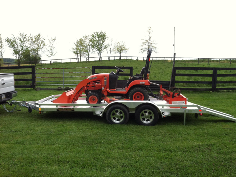

JohnThomas and Dodge Man are correct...think of your future implements. I bought a 10' trailer for "stuff", then when I got the BX, I traded up to a 12' - wide enough for the mower deck when I took the sideboards off. I thought I had the perfect set up. Then, I got a brush hog... Ended up trading up to a 16' dual axle. With the loader and brush hog mounted, the hog's rear wheel hangs off the back of the trailer. I went with an aluminum trailer (car hauler) cause I cant stand watching trailers rust. :)

16' TuffTrailer for my BX24. With the hog mounted, the hog's wheel just hangs off the back of the trailer.
Dual axle with hydraulic disc surge brakes on both axles. Same setup I use on my boat trailer. It works very well and doesn't require an in-vehicle controller. I'm probably the only one around here who prefers surge brakes. Comes from dipping a trailer in salt water on a regular basis I guess.
Z.
