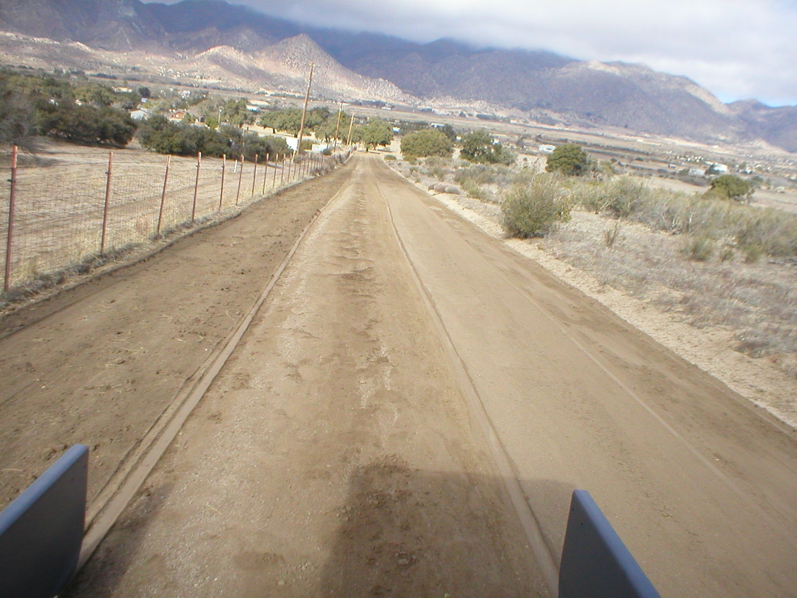

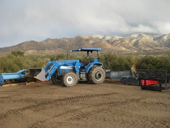

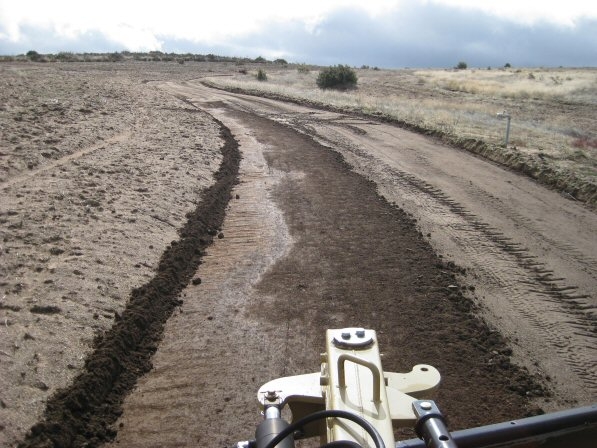

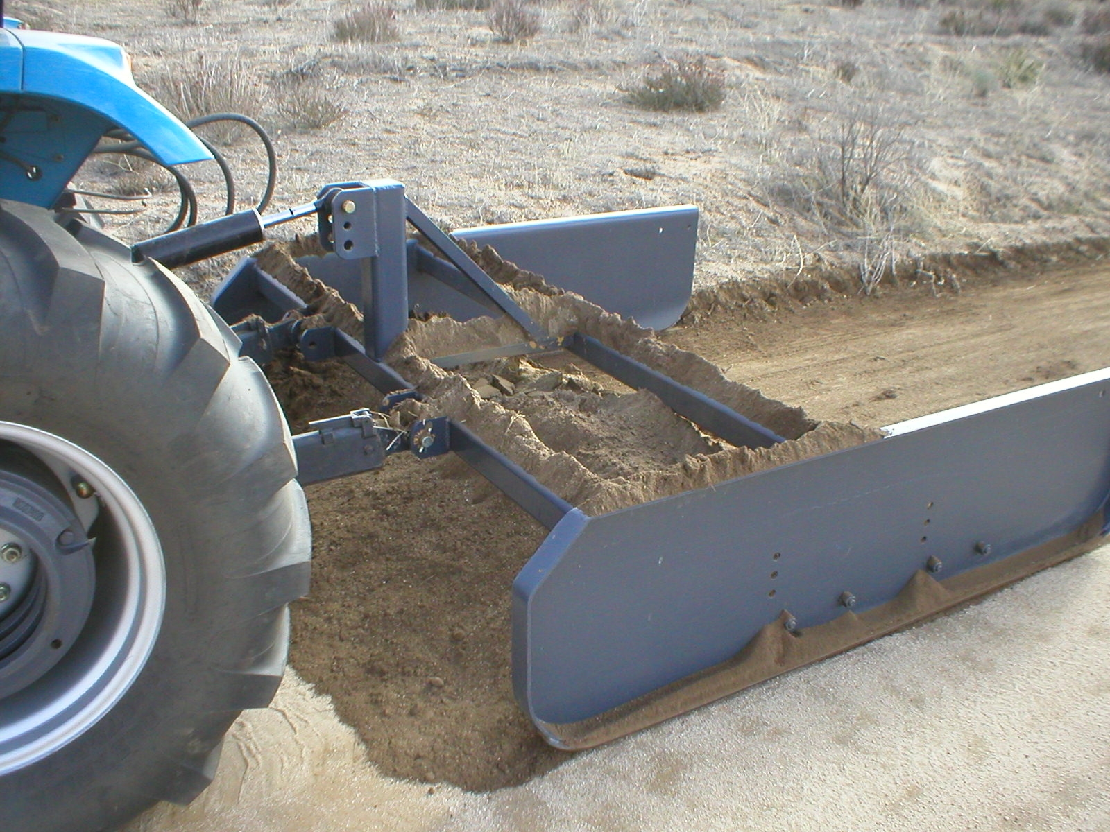

It's not the HP, but the weight of the tractor pulling the implement. You should be over 10K pounds with the loader, more so if you have additional ballast. You can pull the 8 footer no problem, just depends on the conditions of the ground.
I have a 1400lb 7 footer that I pull with a 12K pound 75hp tractor.
One of the things that I have learned, use draft control, you will never bog down.

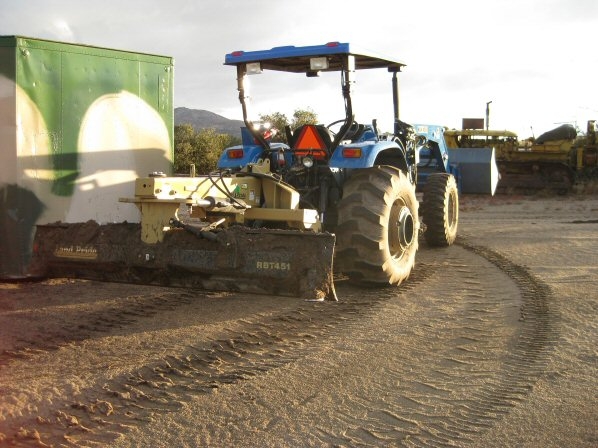

Yes typically the said width is the blade cutting width. (Distance between insides of side panels.)
I am happy with my 7 footer, because I would still have areas in the road that I would need to go over 3 passes wide.
Forget about pulling material sideways, it just does not happen. I have painted the ground to check to see how much it moves from side-side, the ground itself moves about 1".
You want to pull material from the sides toward the center, get a rear blade.
