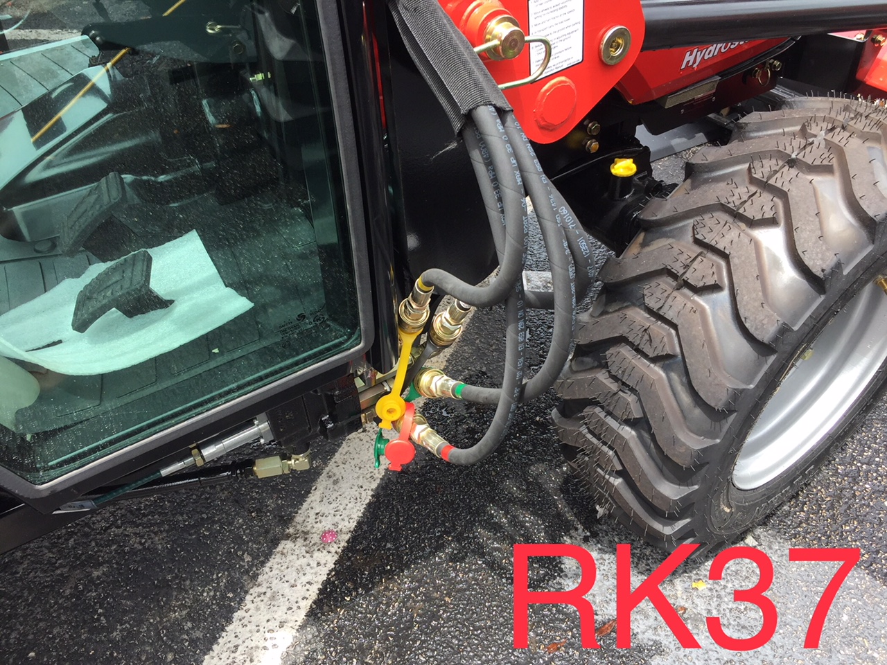

Looking to find out of overall length of rk55 with fel
I looked at a 55 sunday. I'm not a fan of the left side lower mounted fuel tank that is basically designed to be hit by a stick in a field, vs the behind the back of the seat location on a 37.
I'm torn between the two...
I'm fine with either gas tank location. I bet something could be fabricated to protect the RK55 tank. However, if you're trying to decide between the RK55 and RK37, and are worried about field debris, you may want to look at the hydraulic routing of both tractors. The RK55 routing does a much better job of protecting the lines in my opinion (pics for reference below).
Thanks for the pics. Yes, I see what you mean, the 55 is muuuuch better.
I too thought about something fabricated to go under the tank and in front of it. I hate modifying something under warranty though, so would have to look into what complications that may cause.
Thanks.
