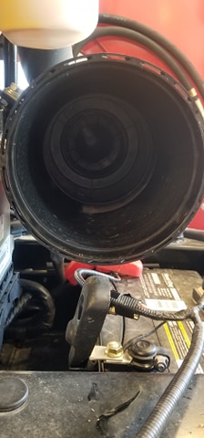

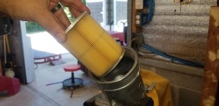

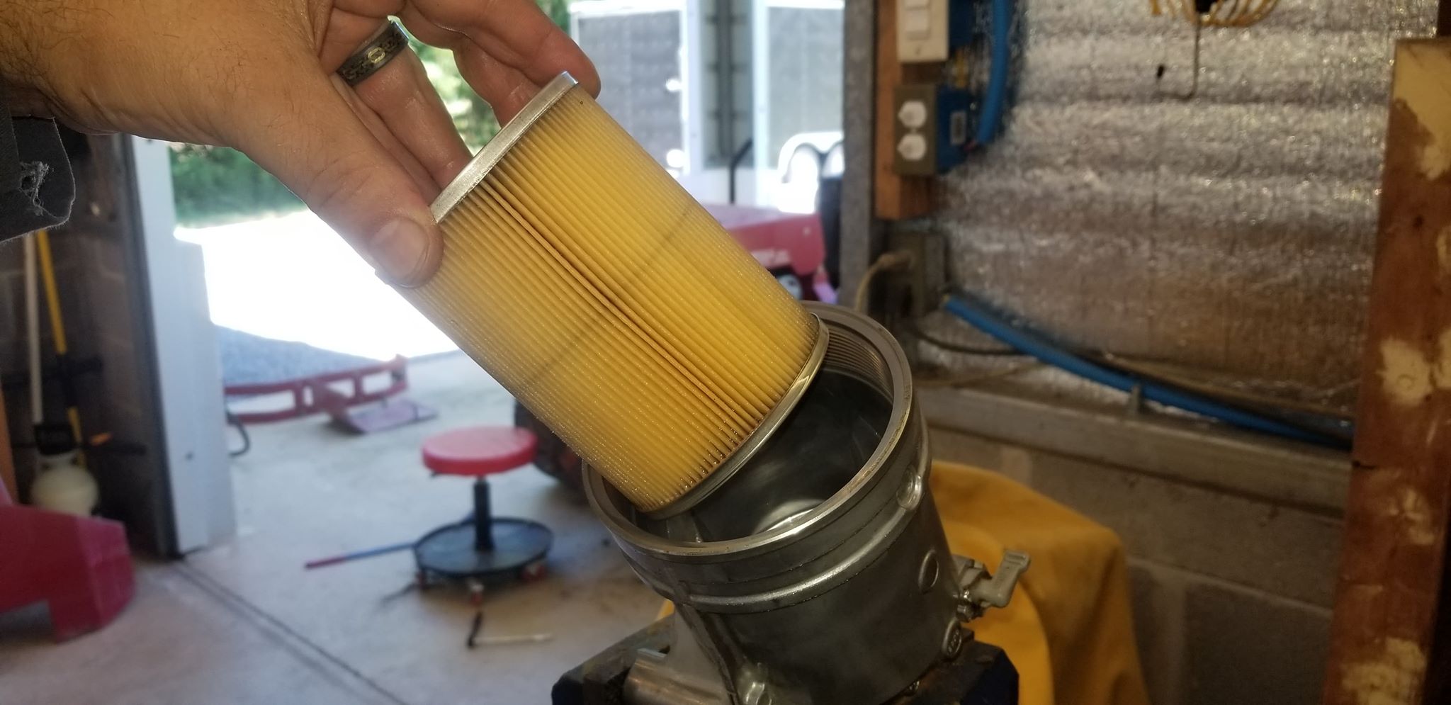

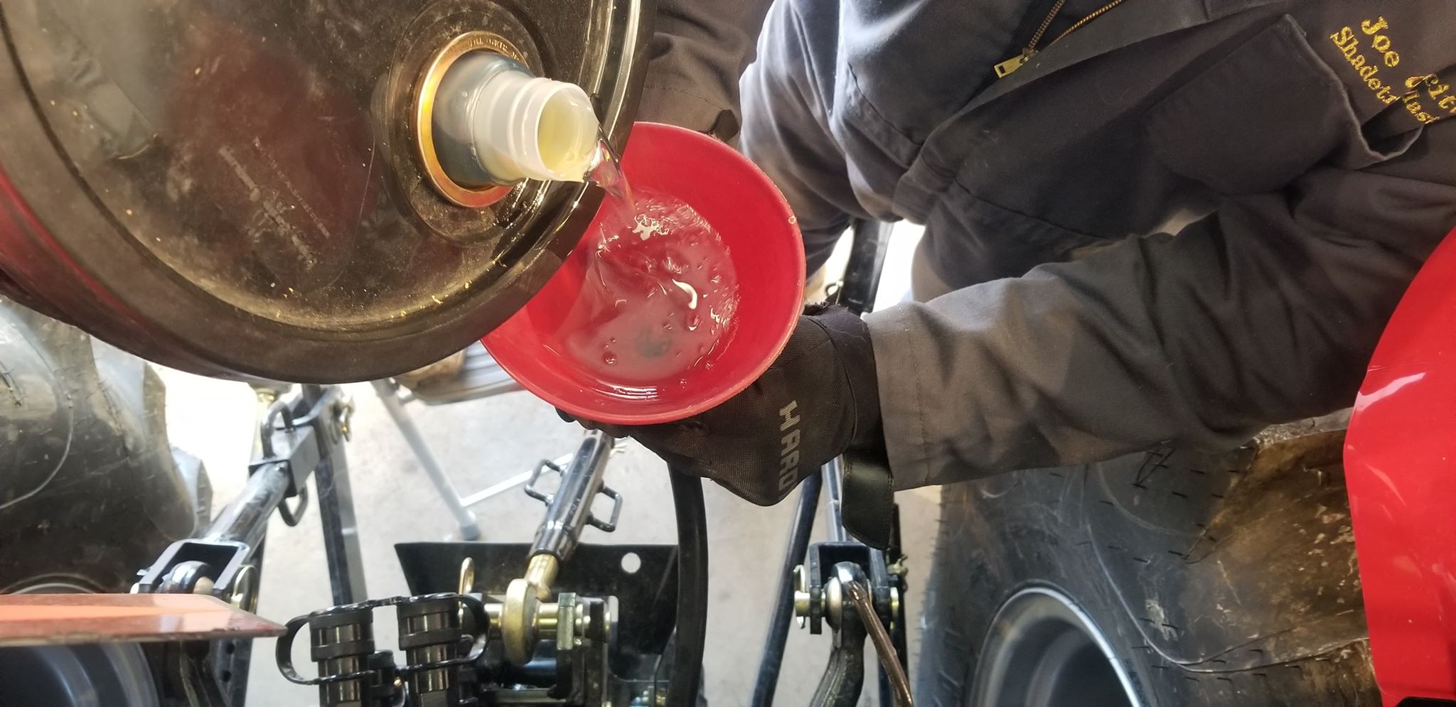

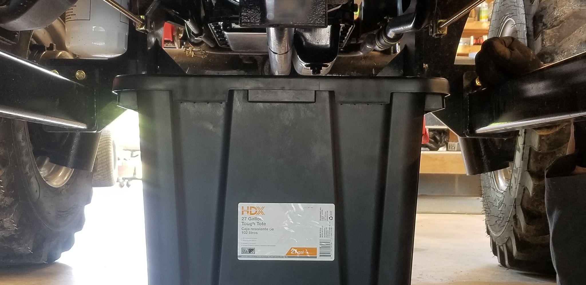

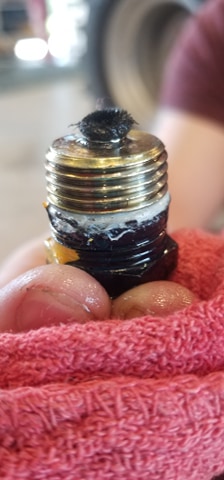

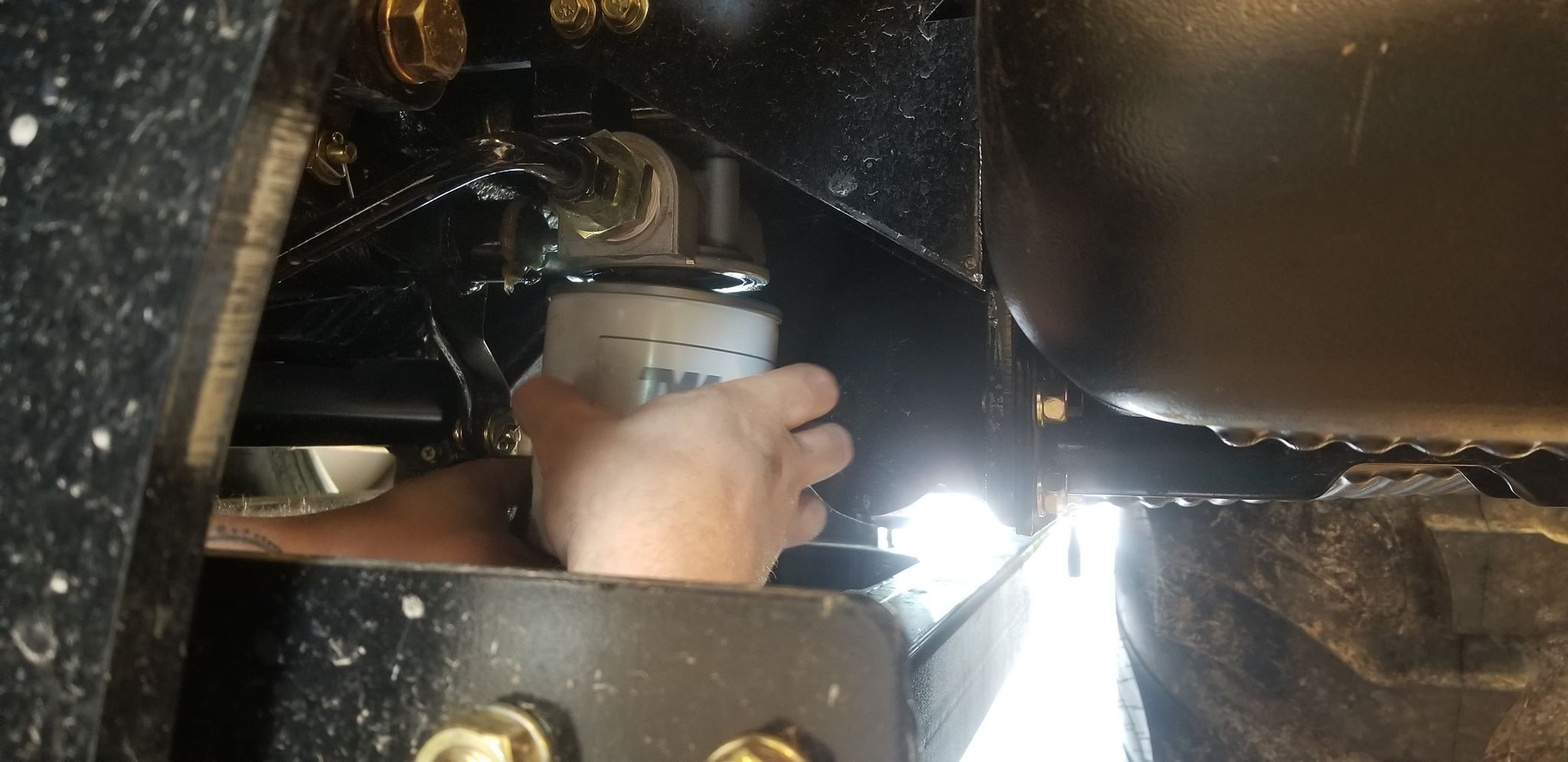

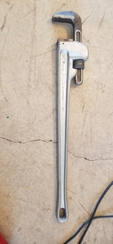

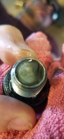

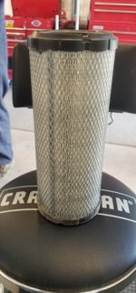

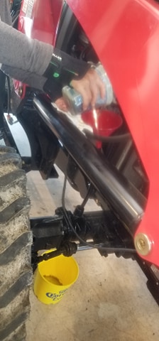

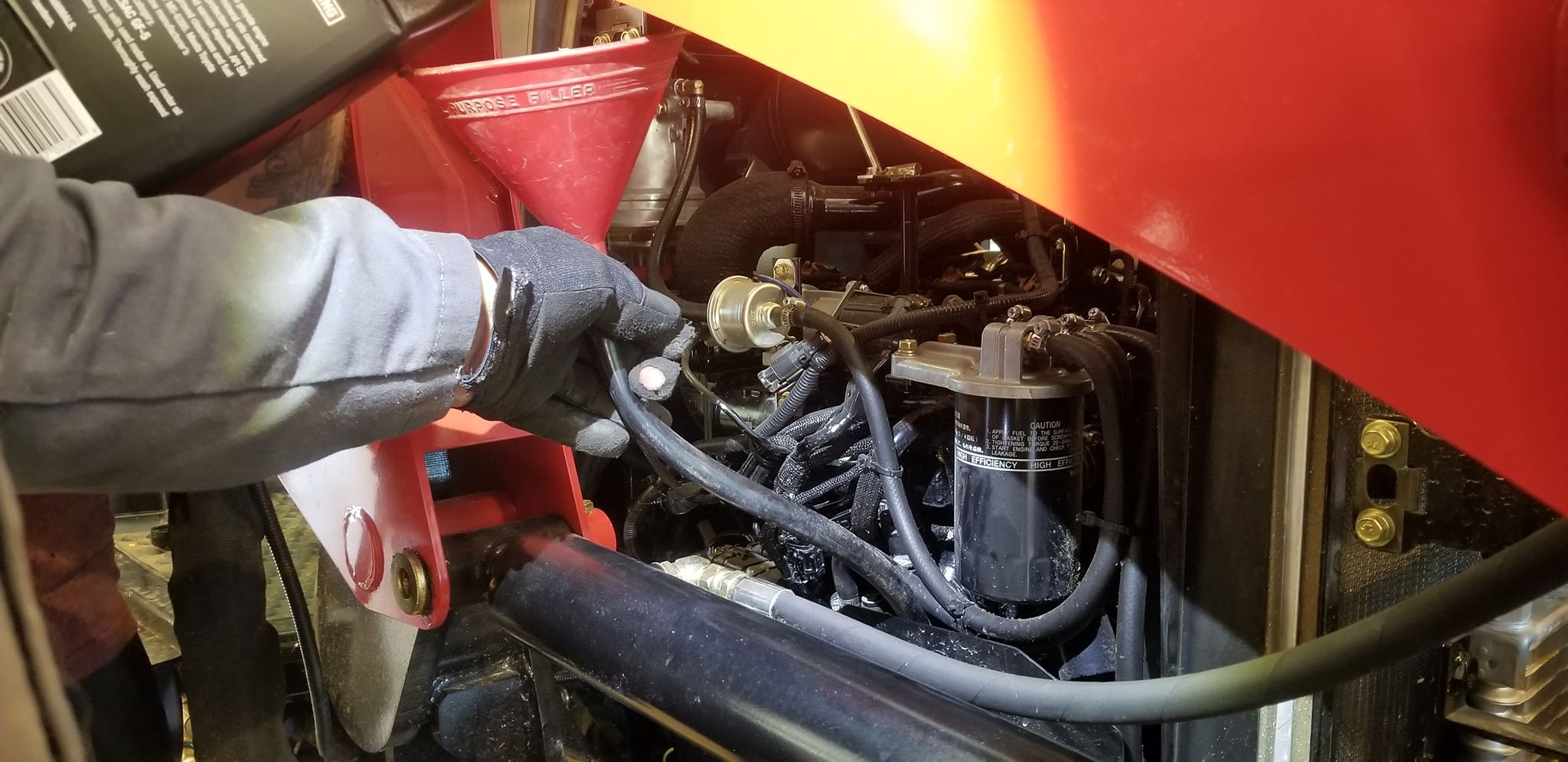

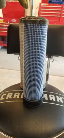

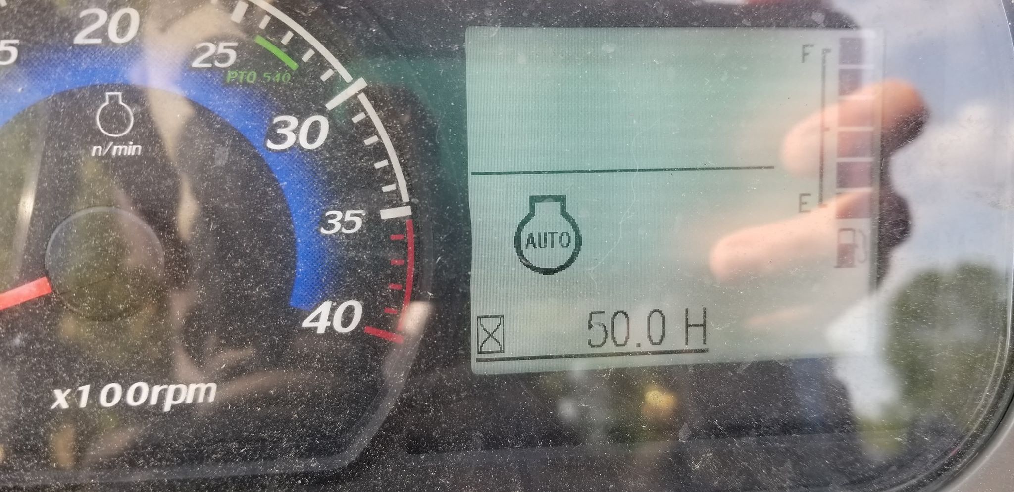

Not a terribly difficult service. The two real sticky points were the Fuel Filter bowl and the vertical hydro filter. Had to remove the whole fuel filter to get the bowl off. And used a 36" pipe wrench to break free the vertical hydro filter. Axle plugs were pretty easy using a 1/2 inch impact extension and 12" adjustable wrench. The Yellow top tote worked well for capturing the draining. We removed the Back Hoe Fram Cross Plate to avoid spillage. The multi purpose filler funnel was excellent for getting around angles and fitting in pour holes. A little slow for the 10 Gallon pour, but I used a strong young man to pour the 5 gallon buckets...I can answer any questions....
Hydro Fluid and Funnel.jpg Filling the Hydro Fluid..
Air Filter canister.jpg Air Filter Housing
Adding engine oil.jpg Filling the engine oil
Air Filter.jpg Outer Air Filter
Big Hydro Filter.jpg Big Hydro Filter
Fuel Water Seperator Filter.jpg Fuel Filter
Hydro and oil drain bucker.jpg 27 Gallon tote to capture fluid
Second Air Filter.jpg Inner Air Filter
Oil Plug  II.jpg Engine Oil Plug
36 inch wrench for big Hydro Filter.jpg Vertical Hydro Filter Wrench: 36"

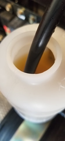

Coolant Color, Axle fill, Axle Plug, Hour Meter

What color was the coolant?
Didn't look like the old style green.
I found out that some of the newer long life are not compatible ith the old style.
   / RK55 HST 50 Hour Service notes and pics....Facebook Rural King Tractors Nation #5
My coolant is green. According to the stickers under the hood and the manual, its the old style green stuff mixed with water.
