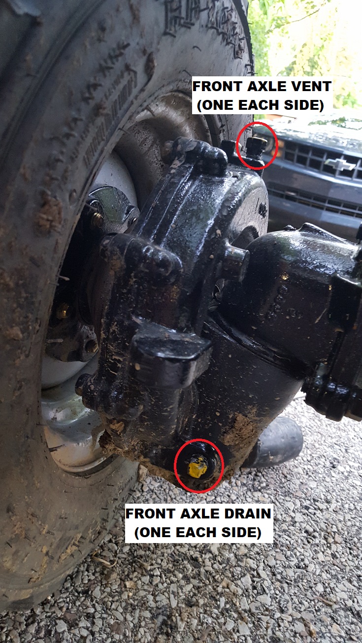

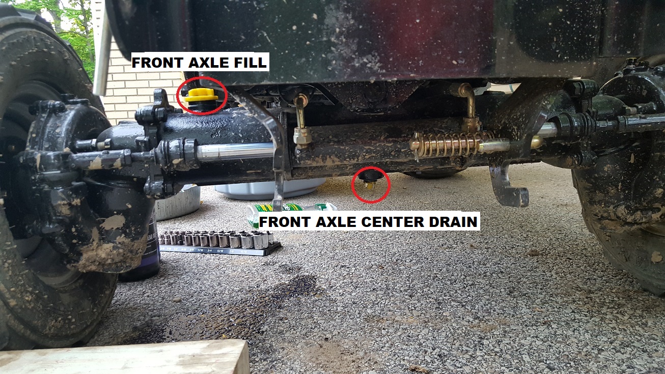

Front Axle Oil
[Note: Plugs may be very tight due to paint from factory.]
1. Remove fill cap (has integrated dipstick) and 2 vent plugs.
2. Remove all 3 drain plugs and drain oil. (It's thick. It may take a while.)
3. Reinstall drain plugs.
4. Add new oil slowly. It needs a chance to drain into ends of axle. Make sure the vent caps are still removed.
5. Check oil level with dipstick and reinstall the fill cap and 2 vent plugs.

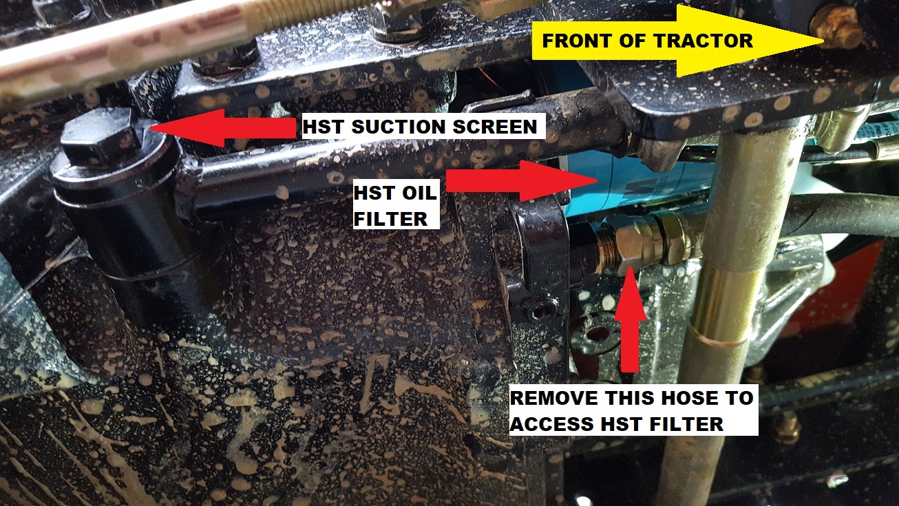

Transmission/Hydraulic Oil
[This one is a little more involved.] [HST = Hydrostatic Transmission]
[WARNING: When working under tractor with wheels removed, always use jack stands!]
1. Block front tires.
2. Jack up left rear of tractor and remove left rear wheel.

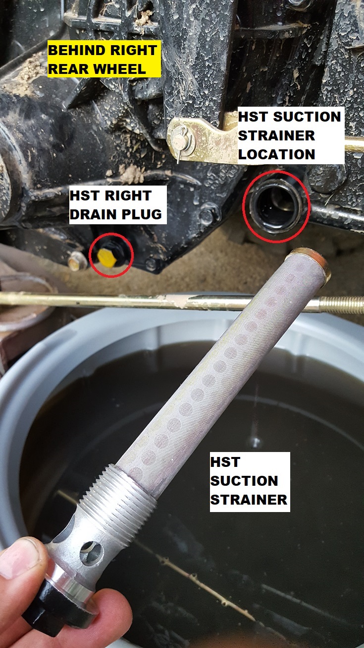

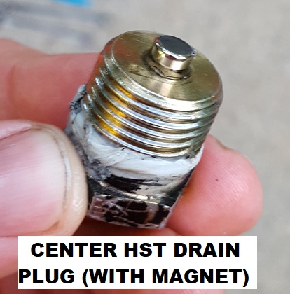

3. Remove left and center HST drain plugs and drain oil.
4. Wipe any metallic debris from center drain magnet.
5. Reinstall left and center HST drain plugs.
6. Reinstall left rear wheel and lower tractor.
7. Jack up right rear of tractor and remove right rear wheel.
8. Remove right HST drain plug and drain oil.
9. Reinstall right HST drain plug.
10. Remove HST suction screen.

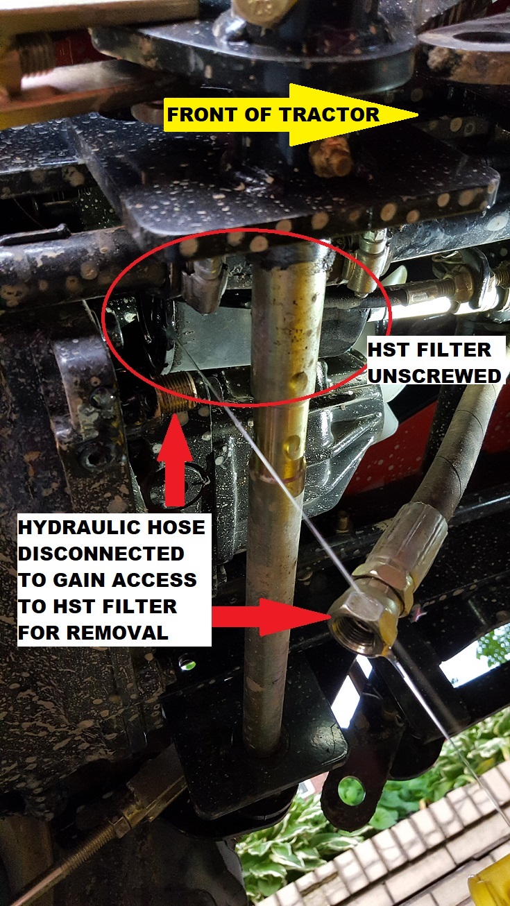

11. Remove debris from screen and clean with diesel fuel.
12. Reinstall HST suction screen.
13. Disconnect hydraulic hose from HST. (It's the one in the pictures, directly below the HST filter.)
14. Remove HST filter. (It will just fit between side of HST and pipes/cables with the single hose disconnected.)
15. Install new HST filter. [Tip: Use a black Sharpie to mark the date and engine hrs on the filter for future reference.]
16. Reconnect hydraulic hose to HST.
17. Reinstall right rear wheel and lower tractor.
18. Remove HST fill cap on rear of HST. (Has 2 yellow dots and a breather on it. Sorry, no picture.)
19. Refill HST oil, keeping an eye on sight glass on rear of HST. (Stop when oil level reaches red dot on sight glass.)
20. Reinstall HST fill cap.
21. Remove front wheel blocks.
22. Start tractor and cycle FEL and 3 point hitch.
23. Verify that tractor operates normally in forward and reverse.
