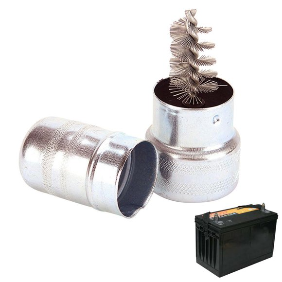

As has already been said in so many words, i suspect you will fix your problem entirely by spending 2 minutes with one of these:
Aka 'battery brush'
