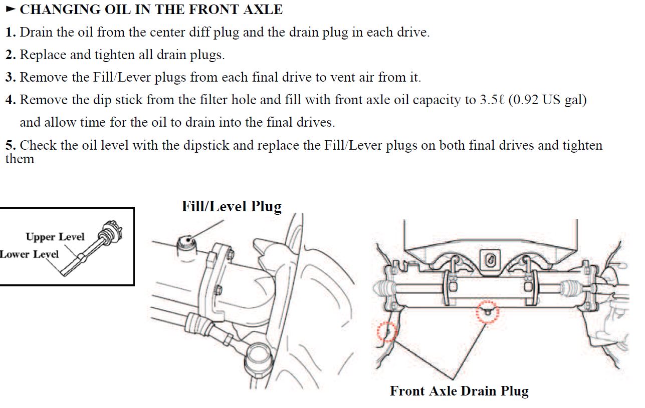

2. The manual states to open the Vent plugs on the front axle after changing fluid, to allow fluid to run into final drives (pg 5-17) but I can find no image referencing the vents. Anyone know what they may be referring to?

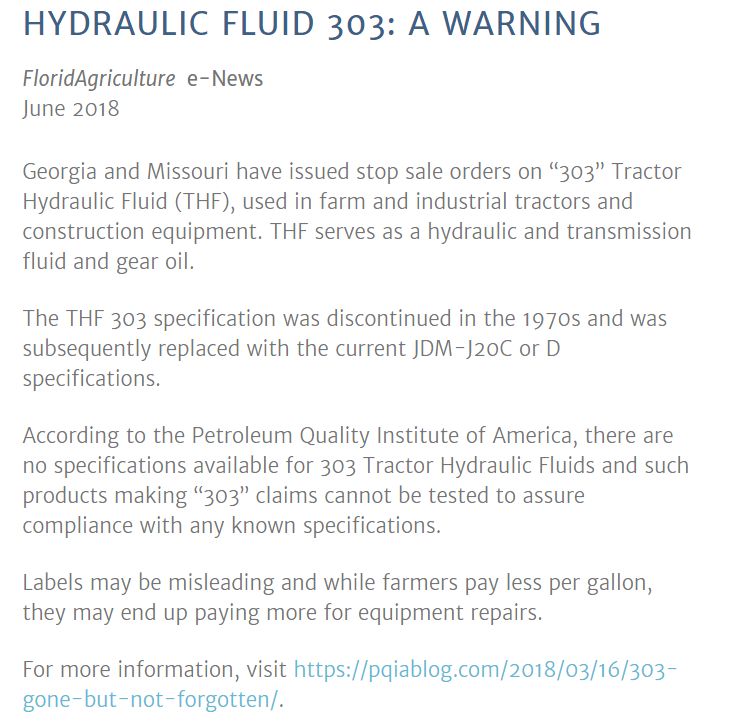

2 months ago I asked at Rural King and was led over to the CAM2 PROMAX Tractor Hydraulic 303 Oil and was told that's what they use in the service area for the RK24. Then I read the following:
Not wanting to take any chances with warranty claims, I bought gear oil that specified it was API GL-4 80W gear oil. Cost more but how many times will you be changing your front axle gear oil at every 500 hours?
As for the second question:
I think the vent plugs are the Fill/Level Plugs on the upper side of the axle.

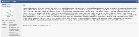

Reading your first question again, I notice that the manual calls for (API GL-4 Grade) Tractor transmission and hydraulic oil and recommends RK universal tractor fluid. But, for the front axle they spec "Gear Oil" at either #80 or #90 I'm not an engineer, but there is a difference between gear oil and hydraulic oil. So the way I read it they are specifying one type of fluid for the transmission and another type of fluid for the front axle. Not sure, but I use the 2 different fluids in my RK24. Maybe someone on the forum can explain the reason. It's too specifically referenced as different to be a translation issue IMHO. Here is the page in the RK24 manual that I'm looking at. Page 5-11

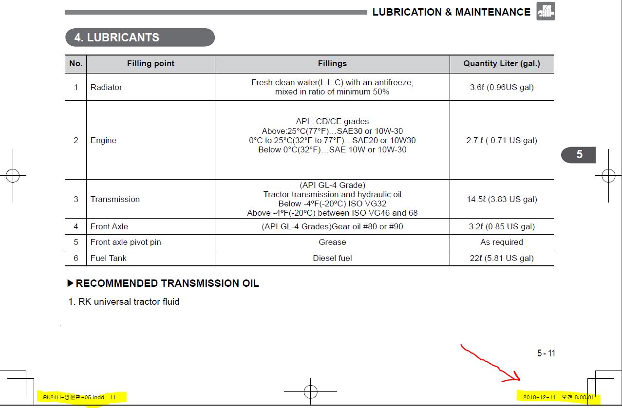

Just to clarify, my manual (page 5-11) shows a table listing recommended "Lubricants for the Radiator, Engine, Transmission, Front Axle, Front axle pivot pin, and Fuel Tank. The table specifies the transmission to use "(API GL-4 Grade, Gear Oil 80W) -3.83 US gal". It specifies the Front Axle to use "(API GL-4 Grades) Gear oil #80 or #90 - 0.85 US gal". The only difference I see in these two listings is the front axle also allows use of 90 weight gear oil. I do see beneath the table that Rural King Recommends universal tractor fluid for the Transmission oil, but doesn't that conflict with the table entry for the transmission?
   / RK 24 H TRANSMISSION/HYDRAULIC FLUID TYPE
OK - just thought about checking for the online PDF Manual on Rural King's website and they are now up! Page 5-11 of the paper manual I received at the store on Monday does not agree with the online PDF manual. My paper manual shows to use Gear Oil and the PDF version states to use Tractor transmission and hydraulic oil. OhioCowboy, I now understand your response. I guess my problem now is which manual do I use to keep from having warranty issues?
   / RK 24 H TRANSMISSION/HYDRAULIC FLUID TYPE #7
Rick, I agree. I'm looking at the date & time stamp at the bottom of page 5-11 in the PDF manual.
It is: 2018-12-11 08:08:01
No idea for sure what format they are using for date (is it Nov 12 or Dec 11? Not important for our discussion.)
Do you have a date on the printed manual you received with your tractor?

   / RK 24 H TRANSMISSION/HYDRAULIC FLUID TYPE #9
RickD, I agree. I know that it's very difficult to find GL-4 gear oil for the front axle. Doing a search of GL-4 vs GL-5 gear oil presents a ton of discussions about the differences. It goes from "it will destroy your differential" to "GL-5 is an improved GL-4". Personally, until the warranty is up, when I do my own maintenance fluid changes I'm going to use GL-4 gear oil for the front axle . I'll use the RK Universal Tractor Fluid or a synthetic tractor transmission and hydraulic oil if it meets the specs in the PDF manual. Unfortunately the RK Universal Tranny and Hyd oil did not say it met GL-4. I think RK should carry a fluid that lists their own tractor on it. Or their manual should list a spec we can find on the fluids they do carry. Even if it has to be IH, JD, MF or NH.
These are the tranny and front axle fluid specs listed in the PDF manual I downloaded from RK:
Transmission (3.83 gal)
Below -4ºF(-20ºC) ISO VG32
Above -4ºF(-20ºC) between ISO VG46 and 68
Front Axle (.85 gal)
(API GL-4 Grade) Gear oil #80 or #90

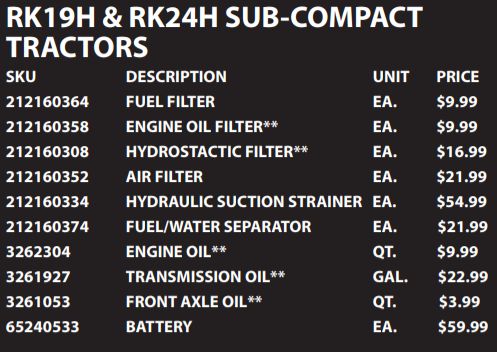

   / RK 24 H TRANSMISSION/HYDRAULIC FLUID TYPE #10
Rick, here's the Rural King fluids listed under RK24H maintenance on their website (rktractors.com) for transmission and front axle:
Transmission
Transdraulic Fluid H.k. Univ (SKU 3261927) Current Price $22.49/2 gal
Front Axle
(Do Not use the Universal Trans/Hydraulic Fluid in the front axle as you were told!)
Gear Lube Mp Sae80/90wt (SKU 3261053) Current Price $3.99/Qt
This is the website p/n & price list.
Parts for the 50 hour service are $120. (3 filters & oils)

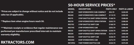

RK labor only for the 50 hour service is an additional $180 at their store. Plus, if necessary, tractor transport costs to & from RK.
Parts & Prices
50 Hour Service
