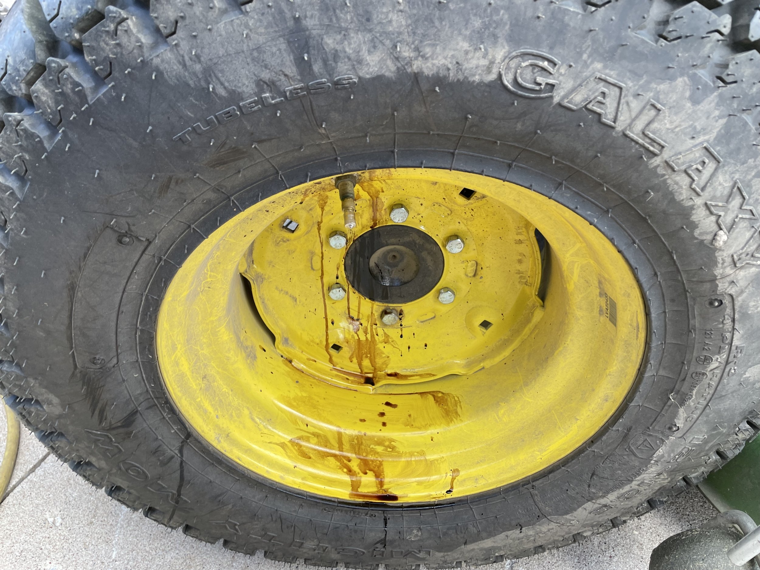

I checked the air in my rear tires today and of course made a mess. I tried to cleanup things with mineral spirits, it didn’t touch it. I discovered Purple Power cleans it right up. I also discovered my tire gauge meant for this was gummed up and I added to much air. After it was coated with Rimguard it loosened up and was good.
   / Rimguard cleanup. #2
It's been a long time since I had to clean any of it up on mine, but I seem to recall just plain water worked.
   / Rimguard cleanup. #3
Lots of water washing RimGuard out of the gauge has worked well for me.
