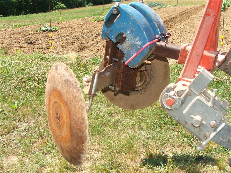

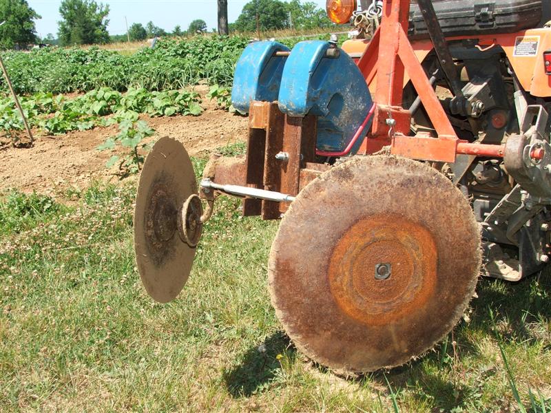

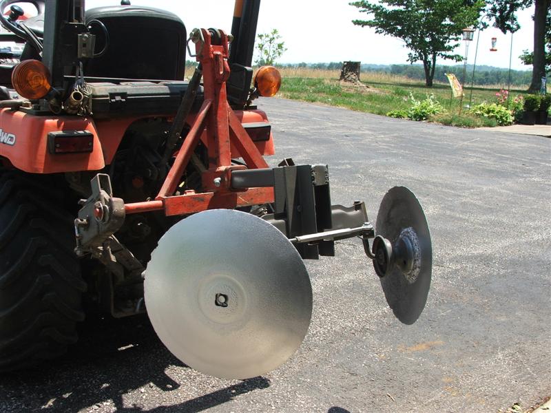

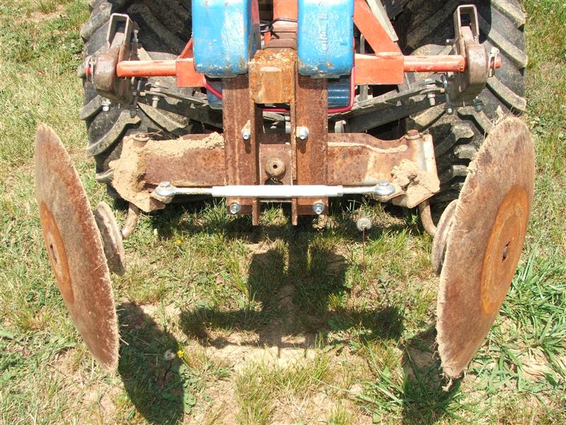

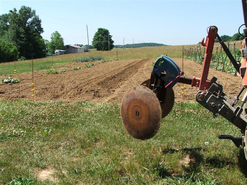

When I started my garden this spring, the first thing I planted was potatoes, it was going to rain so I didn't have time to come up with one, so I made the ridges the hard way, I pulled them up with a hoe, up one side and down the other.
I almost ordered the hiller discs from on-line, but then I spied something in a pile of junk that I thought I could make work. It was the front end out of a Sears lawn tractor, and I had a couple extra disc blades laying around so I came up with this contraption. Had to weld a little and cool then weld some more since the wheels have plastic bushings.

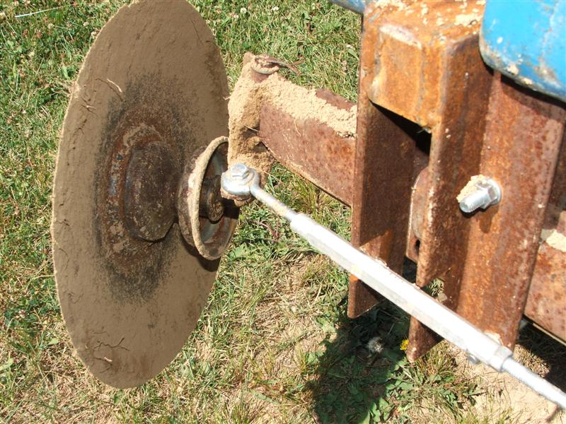

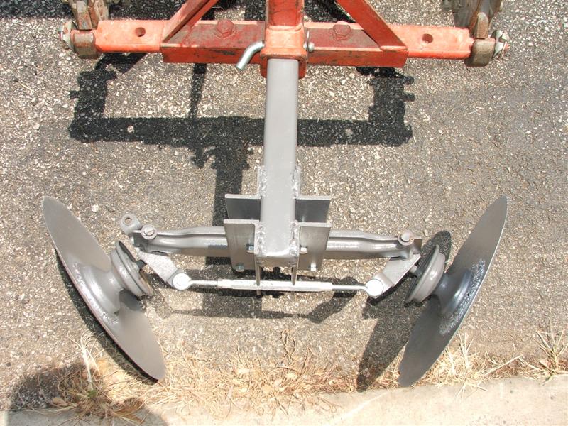

Pic1 The turnbuckle adjusts the angle of the discs.

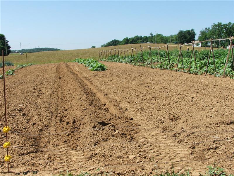

Last pic is of the ridge for sweet potato slips, forgot to get a pic after I got them in.

Wow, what a great project. I really like the way you use the reciever hitch to mount it. The weights look like they would lift off easily, making installing the attachment easier and safer.
The other very nice touch is that you show the results pictures f how the project works. Sometimes we never find out if something works well, which is perhaps much more important that how it looks.

Milkman, what keeps the pins from lifting out of the QC's?
I like the use of inventory better than next months wages.
/ Ridger
Renze
After I got the ridger together, I already had the potatoes planted so I didn't think I would need it this year so it ended up behind the shed, then my cousin asked me if I wanted some sweet potato slips, so I pulled it out and used it like it looks, now that I see how well it works and know that I'll use it again next year, I'll get out the angle grinder and wire brush and go to work.
Cletus
If you look real close at pic three where the drawbar pin is in the hook, you can see the latch that holds it in, it is spring loaded, and on top of the Easy Change there is a lifter that raises and pulls the latch back to release the drawbar. They're real knuckle and time savers and the neighbors don't hear nearly as much blue language since I got them.:D

Very nice. I just added another item on my list of 'to build' projects. I've certainly got the raw materials for it. :)
Two questions, though...
1. Can I assume correctly that the discso rotate or are they fixed?
2. How much weight is on there?
Thanks,
-srj

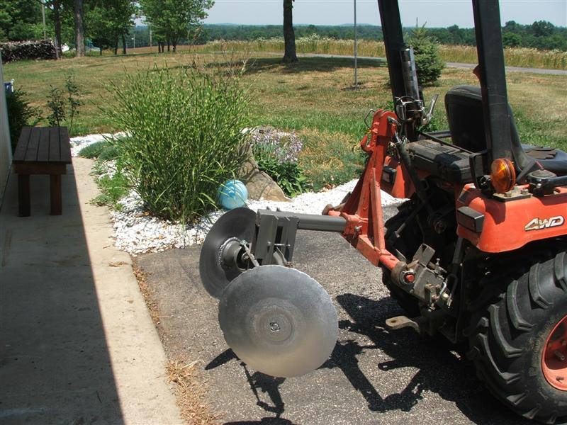

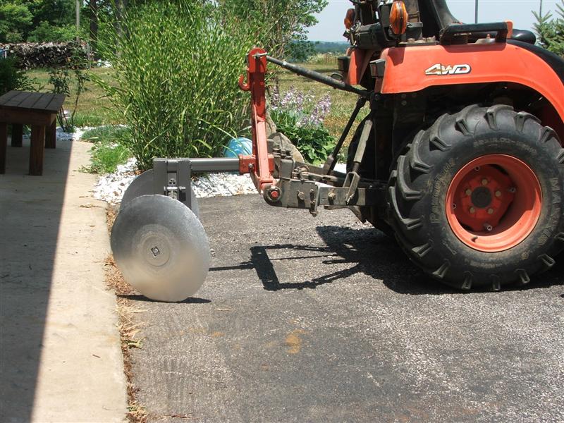

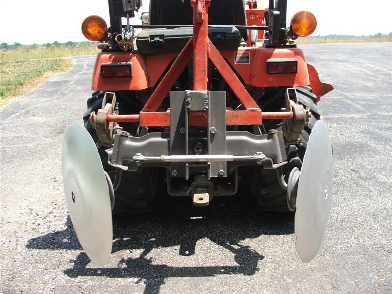

Since it worked so well at making a ridge, I decided to clean it up and paint it so it will look better till I can use it next year.
