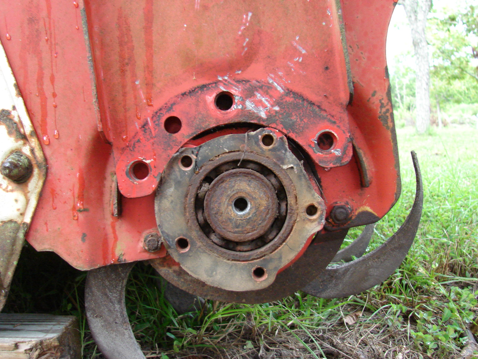

Good morning gentlemen, I have one of the 5 FT 1503 rice paddy tillers. It came with a used tractor I purchase and it is well used. I have read in many places these are excellent tillers for leveling and garden use. From an attachment on the rear of this unit it appears this one may have been used as a potato bed maker around the St. Augustine FL. area.

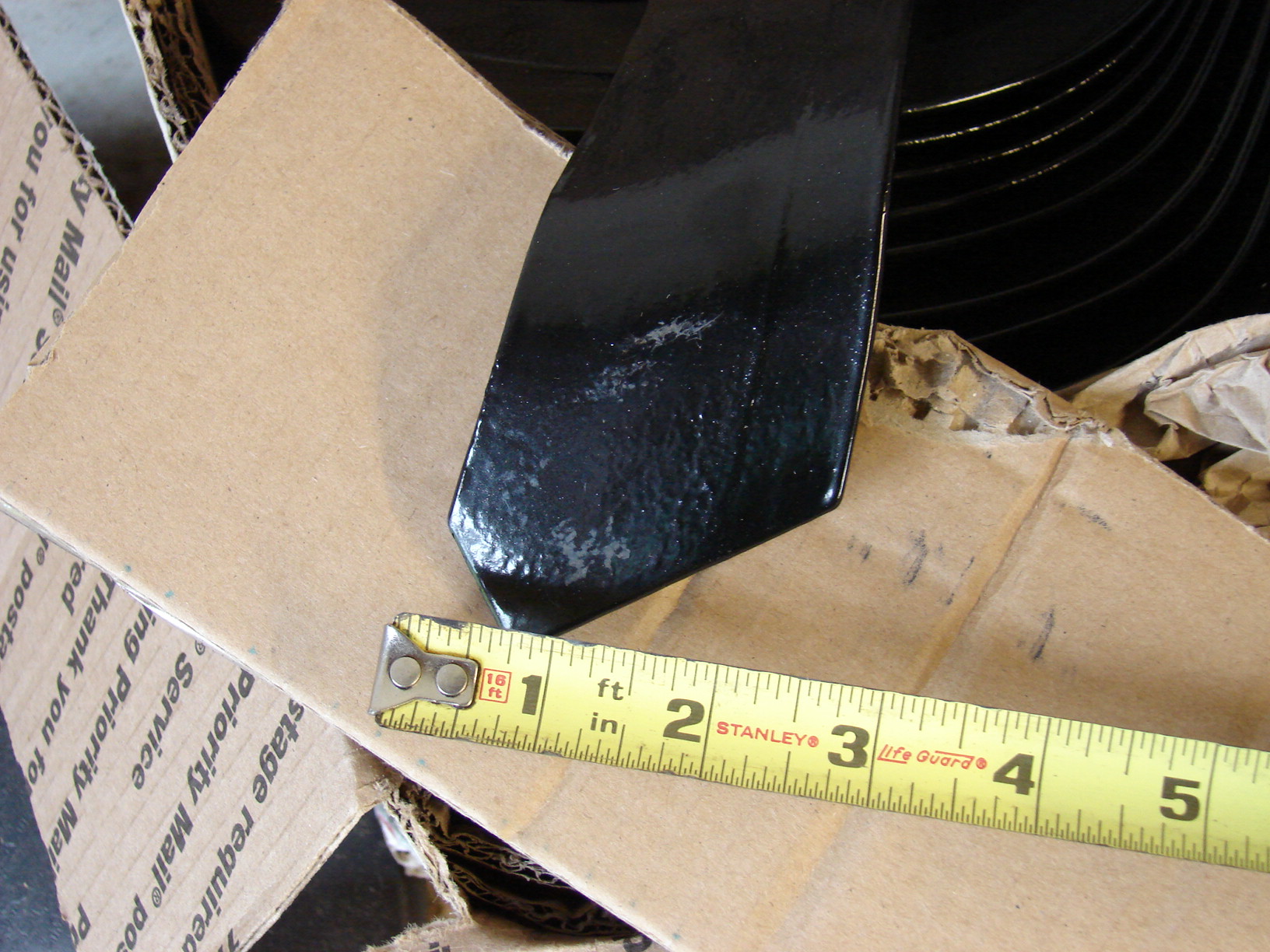

I am doing repairs such as replacing tines, these are well used... at 1/2 inch left on the business end. The new ones are 2 inches on the business end.
I need to replace the tine shaft ball bearing on the right end... right end viewed from the rear of tiller. Bolts came out without to much difficulty after soaking with PB Blaster for 3 days. My question is how is that bearing removed? It appears that I may need some type of inside puller to get it out. I would appreciate any advice and guidance anyone may provide. And does anyone know where I might get a schematic drawing of this tiller?

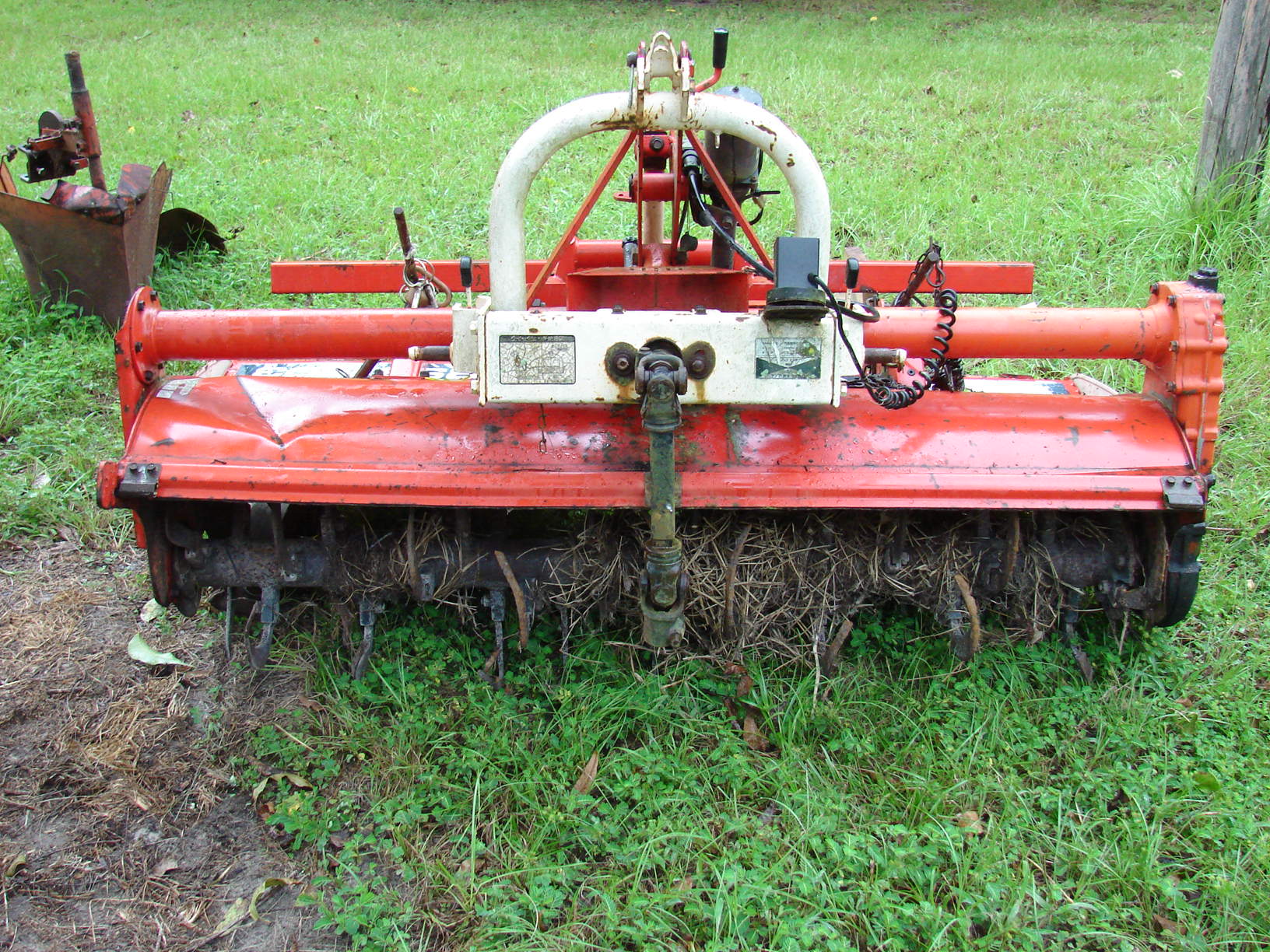

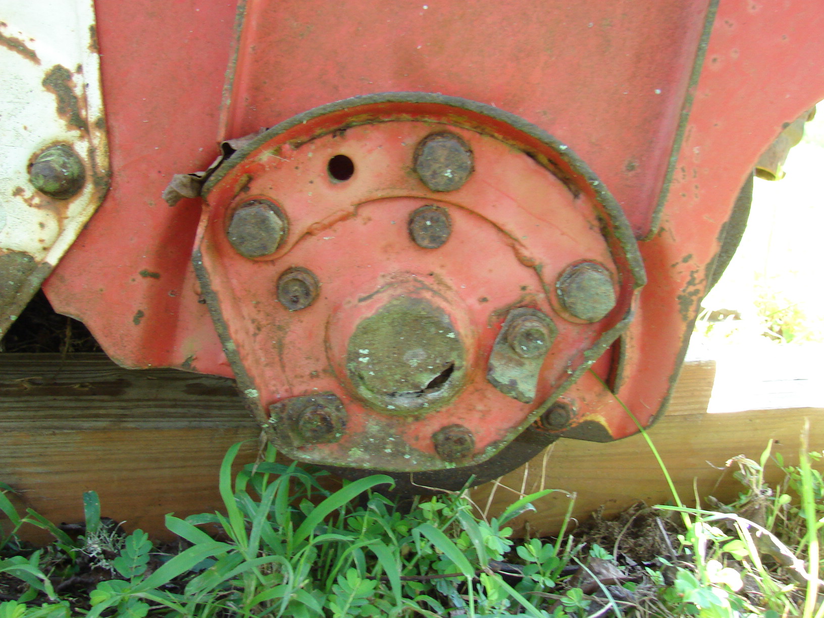

Here are some pictures, all in all I can tell it is well used due to tine wear. The existing tines are 1/2 " to 1/4" on business ends compared to new tines which are almost 3". DSC01371.JPGDSC01373.JPG DSC01370.JPGDSC01375.JPGDSC01374.JPGDSC01377.JPG
- new tine---------old tine-------Bearing cover "note wear hole"--Old bearing r/s--Frt View not--Bed maker attchment
------------------------------------------------------------------------------------------bad for well used
You can see why the right bearing has problems...tilled dirt washes by the cover and wears a big hole in it, which lets dirt and water into the bearing. I can make a heavy metal deflector to stop this problem. The wings are tri wings with the two back sets are thinner metal which bends easily. There are adjustable screw rods behind them to adjust the size of the bed.
In IMHO these machines are rugged and do a excellent job of tilling the soil, but as anything that is used parts will wear and need replacing, as you can see with this tiller. I would suggest only 2 to 2.5 inches depth on un-tilled hard packed soil at a time and making several passes in different directions until you get the depth you need. If you have a large heavy disc set and rip the hard pack first it is much simpler and you only need 2 passes with the tiller.
Great tillers, work great and last a long time. Ken

UPDATE... This applies to the Yanmar rice patty tiller RSB1503 Tiller, but it may also apply to other series yanmar tillers.
For anyone looking to replace the right side, as viewed from rear, main tine shaft bearing... A really good Japanese sealed bearing is available, brand and part numbers are:
Koyo part number is 62082RSC3 XM only additional info on label is UPC 4 549250 158414
Oil seal for this shaft is SKF part number 564113 additional info on label is 40X72X10 HMSA10 RQ
These parts seem to be readily available. My machinist ordered them late on Thursday afternoon and they arrived at 8 am Friday.
The bearing on my tiller had to be cut out with a torch, it would not drive off with a 2 lb shop hammer. It may removable with an air chisel. I didn't try that due to my compressor being down for rebuild.
Hope this helps someone else with the same maintenance issues.
