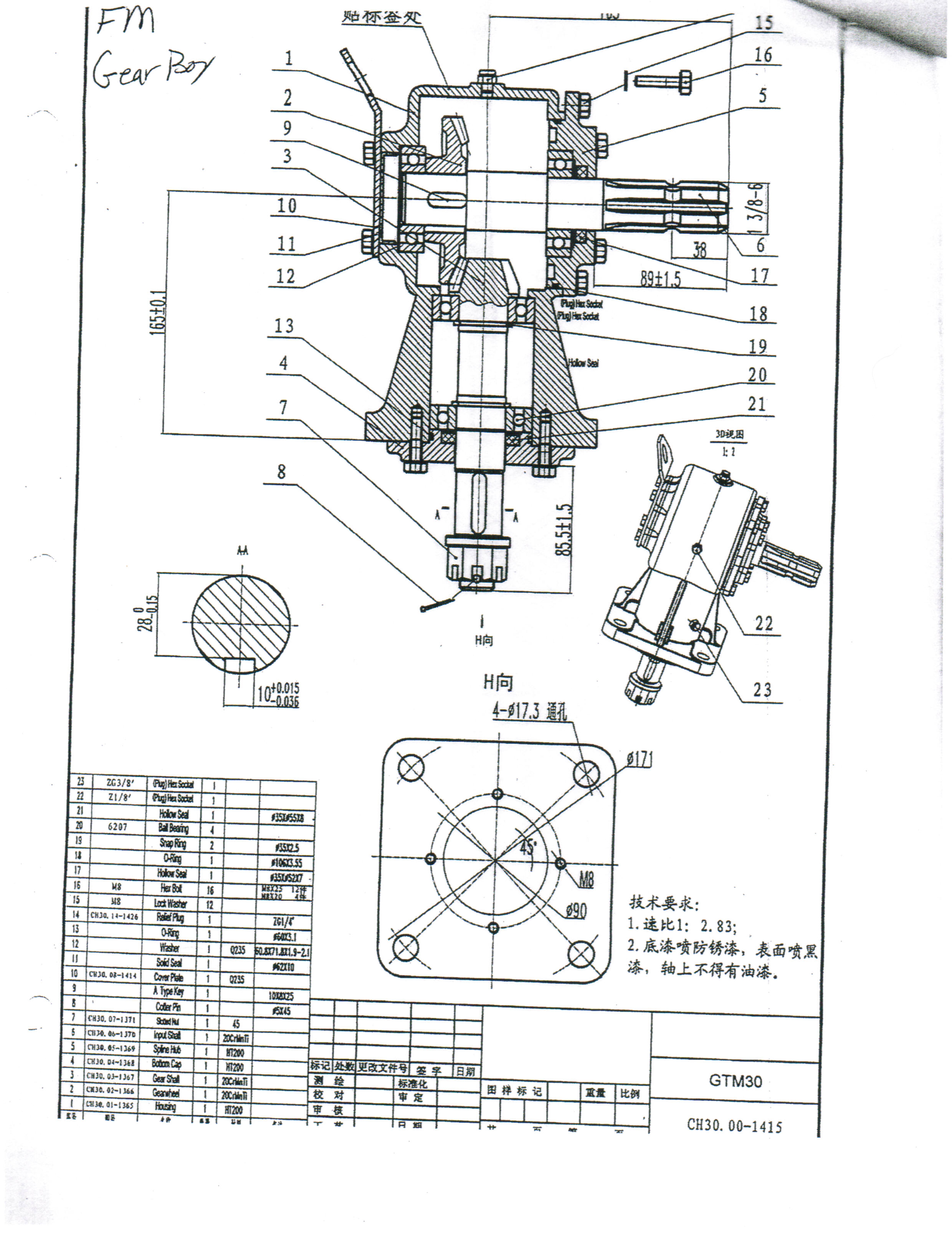

I attached this image since the RFM available with the Mahindra RFM did not come with the gearbox parts and blowup.

Thx kootch88, wicked cool!
I think others may benefit from the post, too. No tellin how many were missing pages like mine.
Thanks
edit : sometimes images take a while to load on my phone ... so far I do not see anything in the image ... hopefully on computer at home it will work
