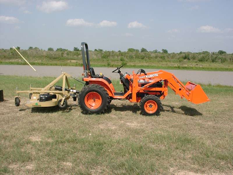

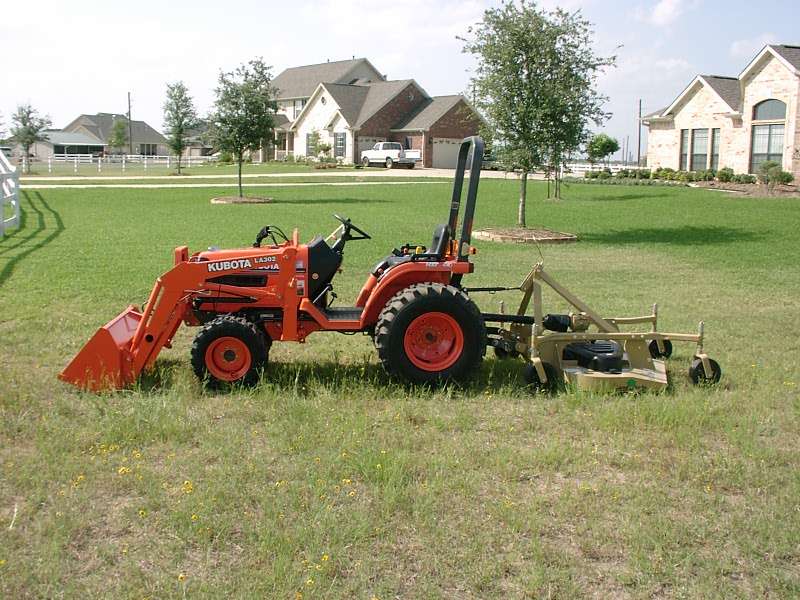

I've been trying to get my rfm set backup. I haven't used it all summer.. but me and my neighbors RFM the rear wheels doesn't come off the ground. I tried adjusting the top link and nothing.. I also have one that has the bottom that has a lot of slack and a sub-assembly the floats but has a lot of laterial movement any pictures of anyone's rfm raised up?
Mine has been binding up and making some wild noises as the u-joint binded and the frame was binding up on some hills.

   / RFM does it suppose to lift completely off ground? #3
down

   / RFM does it suppose to lift completely off ground? #4
up
