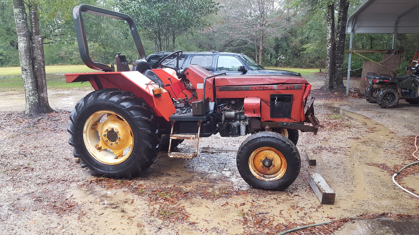

Hello All
picked up a 5211 that was well neglected and started to revive her, had a blown # 3 head gasket and block side freeze plug
was mia so apparently it was pushed out during cold weather.
as delivered to our place

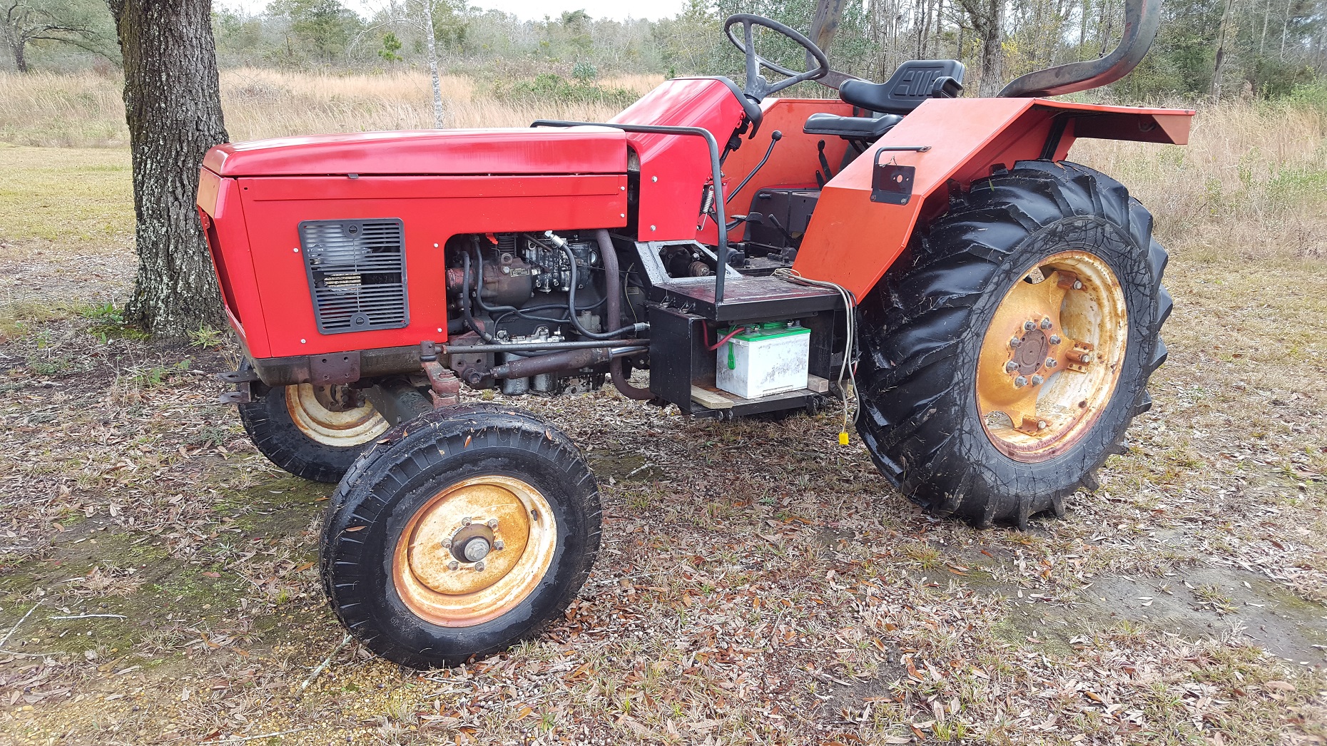

have accomplished quite a bit since i got the tractor home, the front sheet metal had taken a beating and needed painting as well, but got the engine up and running, it also had a water leak into the trans and the steering was way sloppy, found out the steering need to be rebuilt and sealed, here is a recent pic and work continues.

Hello Wrangler, yea post some pics, site is slow to load pics and shows no progress bar during upload on win 10 but they get there, did u find the source of water intrusion into the trans ?
